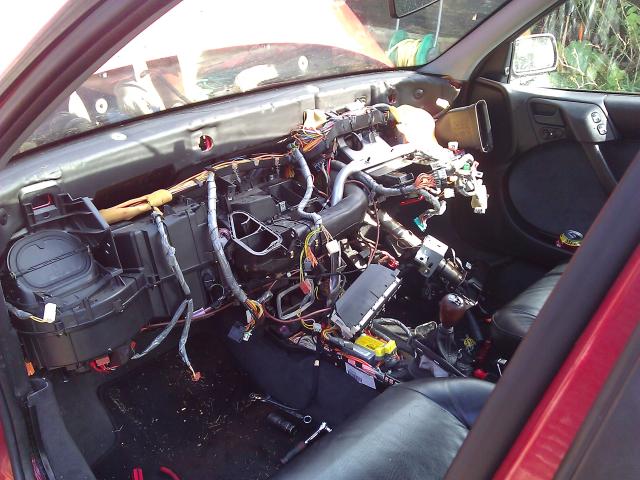

This, and it's not to upset you Ed, but this is what the interior of a Xantia looks like during a matrix swap...
On this one, Chris570's Activa, the elbow was a sod and a half. It would just not come apart.
We hit on a plan the involved splitting the joint at the matrix end, splitting the heater box, undoing the matrix pipe plate screws and then having two people work the elbow, one from the engine bay and the other inside the car tugging on the other end..
It worked a treat but it still took us about an hour and a half to separate the joint :twisted:
That and the rain made it a bit of a log job. Finish off tomorrow...

Nice bit of pr0n there. Do I see vestiges of a little liquid therapy in the door pocket?
What are the yellow topped wiring bits next to its Autoliv module?
Posts: 54936
x 8281
addo wrote:Nice bit of pr0n there. Do I see vestiges of a little liquid therapy in the door pocket?
Just an old can of Coke Adam!!
addo wrote:What are the yellow topped wiring bits next to its Autoliv module?
The seat heater control connectors, the ones that go to the temperature selectors. This Activa has the rare winter pack fitted...
