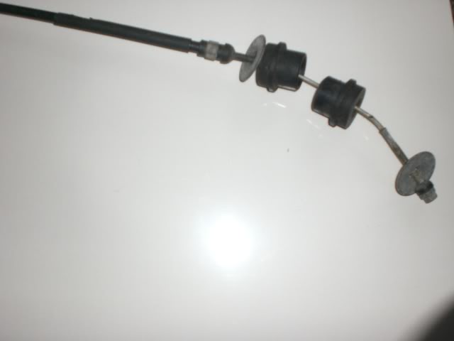

Here is a picture of the cable-its a manual adjust pull type cable which fits with the clutch type fitted. The adjuster nuts are right at the end of their travel giving a longer cable.
I can't quite work out in simple terms why adjusting the cable 'cured' the clutch slip up to the point where there was no more adjustment that could be done and the nuts reached the end of the cable.
Maybe a new friction disc has considerably more meat on it than mine, and when the friction disc gets down to the levels shown on mine it just does not transmit the drive even though to my eyes there was plenty left.
thanks for your help

I cant get that Neil.. there's no way you would need to adjust the cable like that...
I think the cable may have been routed incorrectly, or the wrong cable (LHD?) and because of this was slipping, and there was no more adjustment left to deal with it.. if that makes sense?
