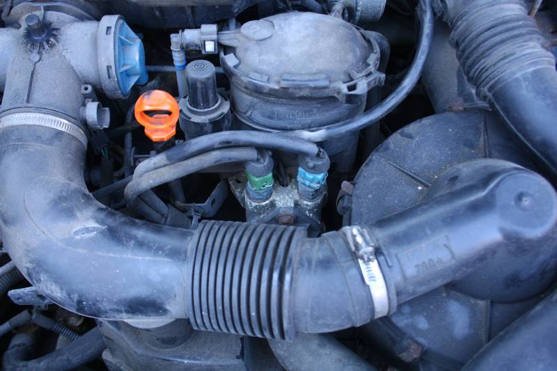

The pic below is what I think may be the relays and may be on top of the thermostat, I tried disconnecting them one at a time and both together but the fans don't run.
Have I tried the correct item?

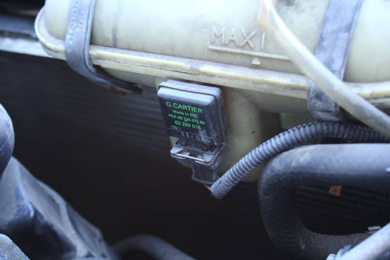

There is also something at the back of the header tank on the rad - what does this bit do? I'm assuming that it is more likely to be a low fluid level indicator- pic below.
Posts: 55158
x 8427
Yes, that's the low fluid level sensor.

The connector in the picture is the low water level warning sensor in the bottle.

CitroJim wrote:What engine do you have fitted? I can't immediately recognise it from the pictures.
DW8 Jim ;) , that's the only one with that type of oval fuel filter.
