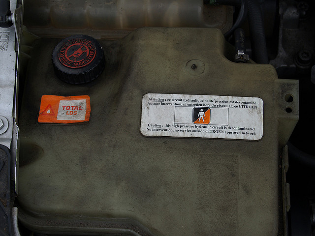

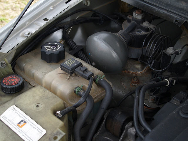

And check, but I think the level must be checked with the suspension lowered fully. The tank is marked to where the oil level should be, but it's difficult to see the marks which are situated at the rear (bulkhead side) of the tank. The L.D.S Fluid just concerns your steering & suspension. Brakes are on a separate circuit and takes DOT 4 brake fluid.
Posts: 28637
x 5651
P4112313 by myglaren, on Flickr
P4112314 by myglaren, on Flickr
The LDS should just cover the bottom or the filler 'strainer' with the car on it's lowest setting
