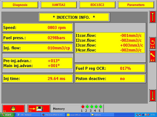

yesterday when starting the car from warmish (had been off for 2 hours) the car was idling very lumpily. The best way i can think of describing this is as if it was running on 3 and a half cylinders. I suspect injector problem as when warmed up (30 seconds of driving) all was well. this is what i get when i plug it up to the lexia when its stone cold. What do we think as to me injector 3 looks out (although maybe not far enough) there are no fault codes stored other than an intermittent EGR one.

I had a problem similar to this on my C5.
I ran some Comma Diesel Magic through to clean the injectors and it made a big difference.

well, i've just put it in :)
lets see what happens

well after doing 300 miles yesterday i can confirm that the lumpiness isnt there (i'm still reserving judgement though till its done more miles)
there is still a very light knock at tick over sometimes though....
it was knocking the other day at tick over but a bit worse than it was yesterday...
