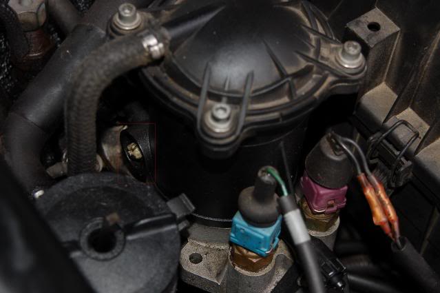

I have just sorted one leak (on a sphere) now I've got another this time on the fuel filter, the car did not start on the initial turnover, it normally did and Mrs fridgedoc took 3 or 4 attempts before it started, so bonnet up, tried to pressurise system with bulb, could smell diesel, found leak on side of filter, this is on the left hand side looking from front of car, the filter case is all black apart from this bit that is white'ish, never noticed before and it's around this part that it is leaking, asking first before I start pulling things apart, just wondering if a cover of some sorts was missing? or is that just wishful thinking : )

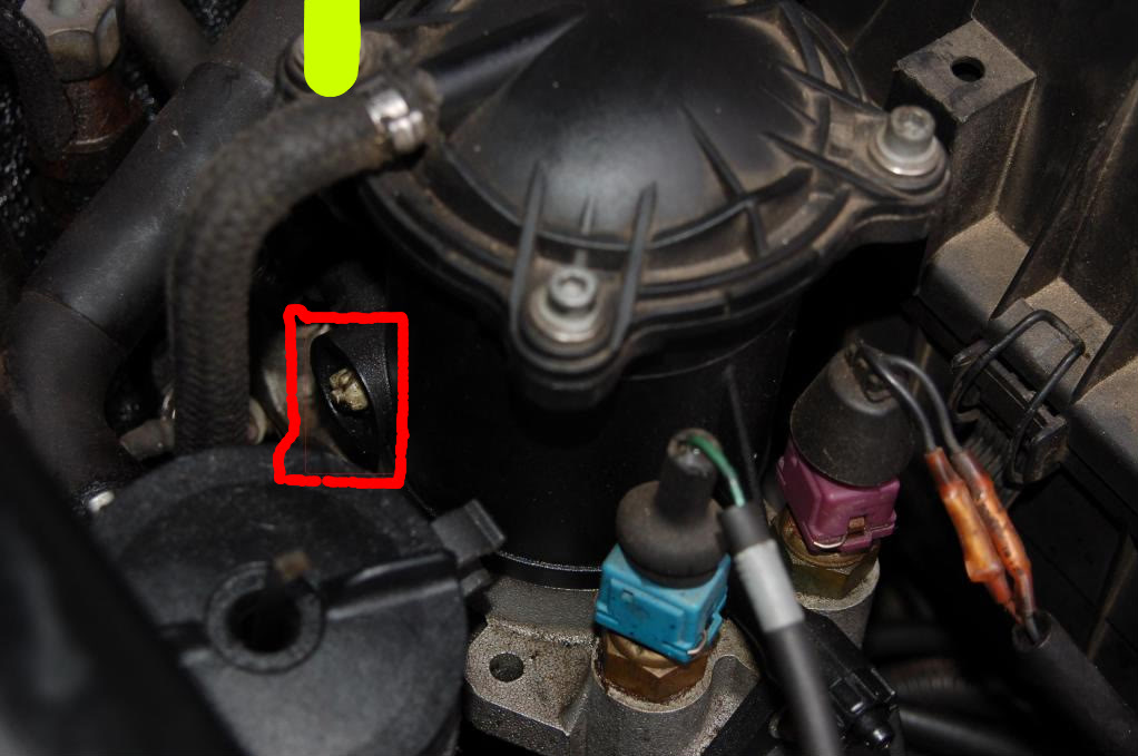

Hi Kenny
Sorry, been trying to upload photo of part, and will it upload, will it heck, but from your diagram it looks like it is No. 10.
Going to try and up load this photo again
Hey i cannot take the credit for up-loading this picture, big thanks to Steve "myglaren"

That's the fuel thermostat. It sends the fuel through a labyrinth in the thermostat housing when cold. It's a pretty common place for the housing to leak from.
There's two O rings on it. They're not available as replacements and the thermostat is hard to dismantle as it's held in place by a star clip.
Normal method of repair is to replace the whole housing or to remove the thermostat and seal the hole with a plug of chemical metal. If you do the latter the area must be spotlessly clean and free of every last trace of diesel or the repair will fail.

Hi Kenny
I'm pretty sure they are responsible or in this case ph°°ked
Hi Jim
I'm going to give it a go, replacing the O rings if possible if not then block it off or if I can get one replace the housing
Does it ever end !!!!!!!!!!!!!!!!!!!!!!!!!!!!!!!!!
