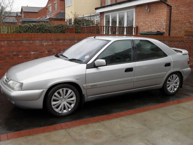

Which wheels are these?
Post by vince »
Thsi is on ebay at the moment. Im not thinking of buying it, but i do think the Xantia suits slightly bigger wheels....what are these? Picasso?

They are 16" steels with trims from a C4 Picasso, yep.
Tyre size on those should be 215.55.16 but they look slightly lower porfile perhaps.
Im trying to find a set of 16" Citroen wheel trims to cover up the steels ill be getting winter tyres for, but so far cant find any for less than £70.

Plenty of nice C5 wheels, both 15" and 16", available. They bolt straight on.

Redrill your car for five stud, like an XM. Then you can run C6 wheels.
No need. C4 VTR Rims are 4 stud, and more common.

Chris, there are two different sizes.
205/50R15 and 215/55R16
Also there were 4 different wheel designs but I was talking about the 'Starfish' design which mine has. Only issue may be offsets as the wheels need to clear the Brembo calipers fitted to the V6s. Not entirely sure of the offsets on the Coupe or the Activa are really.

D9 406 Coupé: 12-15 offset (latter only on 15" steels)
D9 406 sedan: 18-20 offset (basically dependant on 6J or 6½J rim width)
Activa Series II: 15 offset (Le Castellet wheel is 8mm, being a 5½J rim)

Citroenmad wrote:They are 16" steels with trims from a C4 Picasso, yep.
Im trying to find a set of 16" Citroën wheel trims to cover up the steels ill be getting winter tyres for, but so far cant find any for less than £70.
215/55/16 will a larger radius than the standard tyres that a Xantia came with are wider than the standard Xantia tyre too. The biggest standard tyre on the Xantia would appear to be 205/60/15 so 205/55/16 would be closer but it's radius is bigger too!
215/50/16 is very close for rolling radius but again, it's wider and may rub when you're cornering with the car fully loaded!
