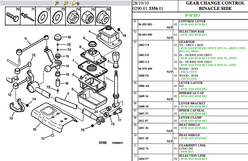

I've driven many BE3 boxed cars and you shouldn't have to almost force the
gearbox into 1st gear. This doesn't sound right at all. Only Xantia alternative
would be the 2.1TD, the later Hdi or Activa with cable selection which are very
light and precise. Or get an Auto?
Could be worn bushes on the rods running onto the gearbox in the selector?
Andrew

It could be one of the infamous rods worn over the extremes of the
reverse/first plane?
When you're driving the car, most of the time it's the higher gears which
are predominantly used and even a slow speed first selection may be easier
to engasge with the car moving. I'd say check the easy things like these first:
Item 11 and 12:
Andrew
Item 11 and 12:
Andrew
