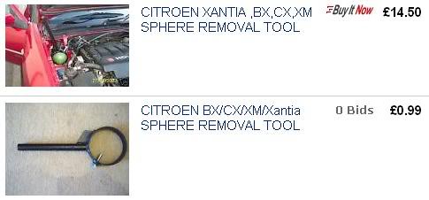

In case you don't want to make your own, here is a picture of this very special tool:mikep wrote:I took it to an independent garage and he said he couldn't change them because you need a special tool.
PS: I have no connection to these eBay sellers or items seen in the picture
Indeed Citroen maintenance is fun and you can enjoy it. Get instructions from FCF
