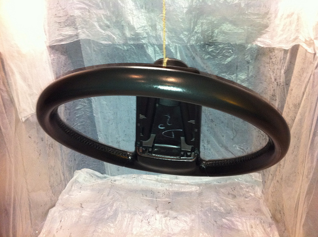

I decided some time ago that something must be done about the state of the single spoke steering wheel in the SED. The leather finish was coming off in various places and the stitching had burst here and there so the initial thought was to buy a better one. However the only one I saw went for more than I could justify so that meant the other options was to swap it back to a 2 spoke wheel or refurbish the one already fitted. One of the things I really liked about the series 1 was that wonderful layout of the dash, switch gear and the single spoke wheel that gives such a great view of it all, so refurbish was the way to go.
Checking the web brought up conflicting advice as to what should and shouldn't be done to leather interiors. The advice that made the most sense to me was that water based 'flexible' dyes work best. So after further searching I settled on a kit from the Furniture Clinic which includes - leather prep, leather cleaner, water based dye, gloss sealer, satin sealer, abrasive pad, cotton wool balls, cloth, foam block, airbrush and propellant.
During the search for the leather repair kit I ordered some waxed linen thread to restitch the leather cover to the wheel. This was bought from an ebay seller and arrived very quickly. Restitching the leather took about 2 hours using the same stitch pattern as was originally used. The thread was 5 metres long so I started in the middle and stitched both ways.
Following the instructions in the kit I put some leather prep on a cotton wool ball and covered it with the abrasive pad (scotchbrite pad), after a good scrubbing, changing the cotton wool ball and using a clean bit of pad, all the leather finish was removed, a good wipe over with more leather prep removed any remaining residue. Next a thorough wipe with the leather cleaner removed the last of the greases/oils that could be contaminating the leather was needed. After this a gentle sanding with 1500 grit silicon carbide paper smoothed out the worn patches and provided a good key for the dye. Another wipe over with the leather prep and leather cleaner was needed followed with about an hours drying time to ensure the leather cleaners had evaporated completely.
Here's how it looks after those first steps -
After several sponge applied coats and a couple of sprayed coats this is how it looks -
TBC

Wow! That looks good Steve :D

Thanks Jim.
Once this is done the edge of the drivers seat needs attention, it's not worn through yet but has lost most of it's finish on a palm sized area. With luck I may get to have a go at it this weekend.
