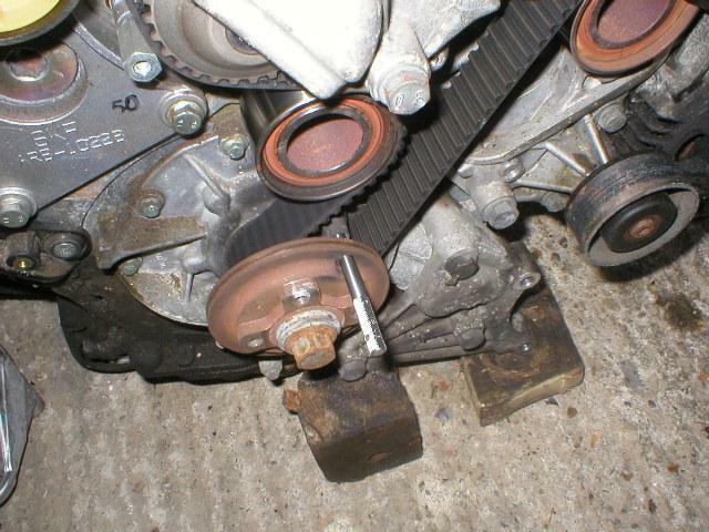

Just a quick point... The Crank pulley centre bolt does not need removing on the V6. The pulley is bolted to a flange via four small bolts. It's just necessary to remove these and the pulley then comes off for access to the belt sprocket. An additional advantage is the timing setting hole is in the flange and is still "in-play" when the pulley is removed.
Here's the pulley before removal:
And here's the flange with the timing pin in place:
