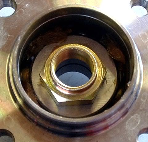

I have only removed the cover. Then you'll see the bearing balls and also see the grease amount and condition.mrjohnson wrote:...
VertVega & Kowalski - did you have to take off the hub nut to do this?...
(There's a pic of it and I might edit this message later...)
I used only bearing grease.
Edit: Here's a close-up of the rear bearing right from the shelf, unused
You can see the grease which is already quite thick and see how it's applied.
This tends to get dry.
From the gap seen in the pic (the big nut side) I have added new grease.
