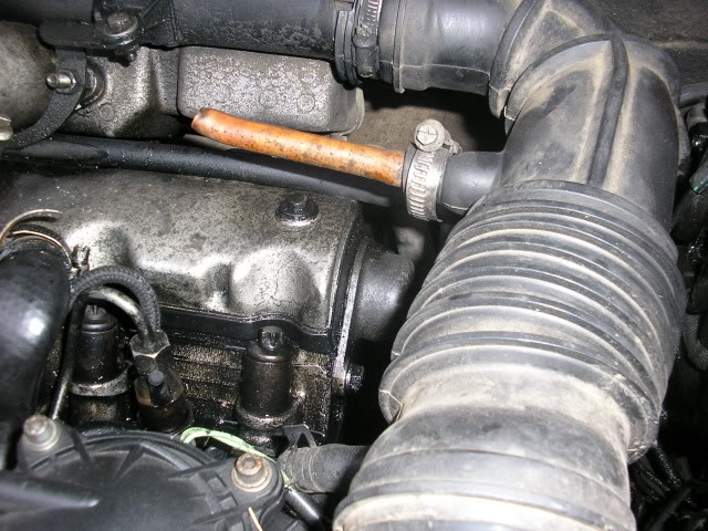

As can just be seen in this pic the breather pipe from the oil filler is not correct.
If you look close you can just make out the breather going from the oil filler to the rocker cover as apposed to going to where the copper pipe is.

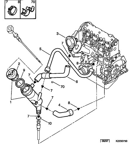

This is what the original rocker cover and breather pipe setup should be
Now i understand the current engine came from a MK1 estate but i cant seem to get the diagrams from Service.Citroen for what i have in the engine bay (site playing up :? ).
I am assuming that what has been done is the air ducting etc from the original engine has been used and as this rocker cover has a breather outlet it has been plumbed in directly to the oil filler breather.
Can anyone shed some light on how to correct this without having to change the rocker cover/oil filler and associated pipes :)

Colin, pipe 5 is the one that goes from the cam cover to the filler housing down low on the back.
What's been disconnected and replaced with a copper pipe (no idea why) is item 3 and pipe 6 which connects to the upper spigot on the back of the oil filler housing.
So presuming that pipe 5 is still in place, you need pipe 6 and item 3.

Thats what i thought but having looked at the car briefly again tonight what is in place is pipe 6 which goes from the upper spigot on the oil filler housing to the cam cover (sorry i called it rocker cover :lol: )
This pipe is not the right one as its nearly folded over as it gets to the cam cover.
I couldnt see a pipe going to the lower part of the filler housing so assuming its not there :twisted: :twisted:
Could explain the oil on and around the injectors :)
Will need to have a closer look tomorrow and take some pics :)
Colin

Sounds like you need both pipes then.

I think I made a comment about that breather missing!!
Surely your not intending buying a new one from the stealer?? Im sure I can find the one missing from your picture in the shed.. as for the cam cover to the oil filler one, that sits over the injectors thats a probleme for me, it goes brittle at the cam cover and splits...

I don't think they're that much from stealers, Cassy needed a new cam-filler pipe as hers split at the cam end as Paul mentioned.

Have you got the price/details of item 3?

Xac wrote:Have you got the price/details of item 3?
Ouch :roll: :roll:
Part Number Description Quantity Price excl. VAT Price incl. VAT Total incl. VAT Selection
00001421A6 REGULATOR 29.05 GBP 34.13 GBP 34.13 GBP

DONT buy an Item 3 Admiral51
Im certain Ill have one of those with a free pipe to join it to the oil filler....

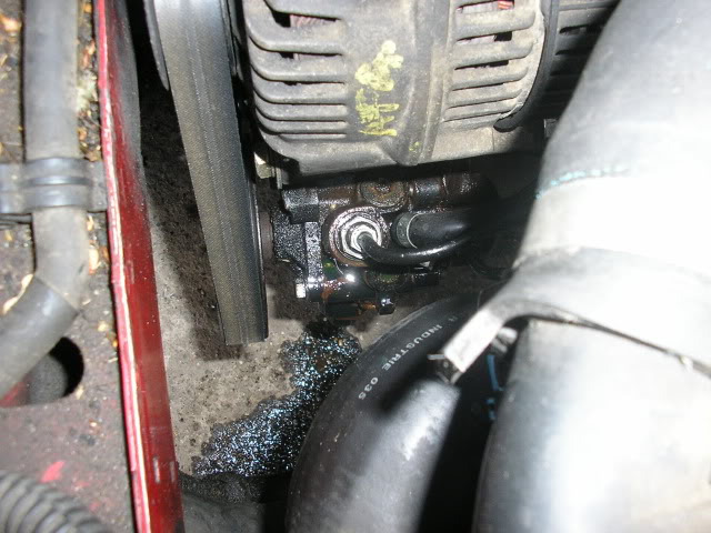

Im not sure if the HP pump was swapped or the original put back on so can anyone hazzard a guess as to which O ring i will need to stop this leak
I know they are only a couple of quid each but just for my own peace of mind :lol: :lol:
Cheers
Colin
Xaccers
Posts: 7654
Joined: 07 Feb 2007, 23:46
x 188
Unread post by Xaccers »
2x number 5
One for where the pipe comes out and one for the hex blanking plug a bit further round.
