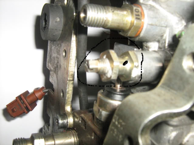

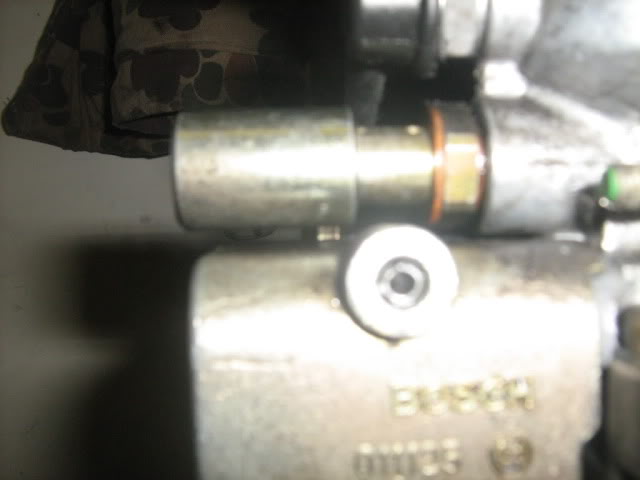

In order to checking the stop solenoid,on my Bosch pump the ac3 model. I had to remove the armour. There is a securing/security pin which must be extracted before the armour comes off. This pin is inserted into a bevel in the max fuel screw.
What I noticed was the max fuel screw had moved slightly.
My question is would this have an effect on the rough idle as the car is running okay otherwise.
I hope the photo's make it clear.
Kenny

That screw will either raise or lower the idle if turned enough, along with adding more/less fuel across the board. It shouldn't make the engine run rough (generally) but what's the idle at the moment and what was it before the screw was moved?

I haven't turned the screw yet but was thinking of experimenting with it and I was only going to turn it slightly to see if it had an effect.
The idle is best described as vigorous engine shaking but steady no deviation.
Kenny
