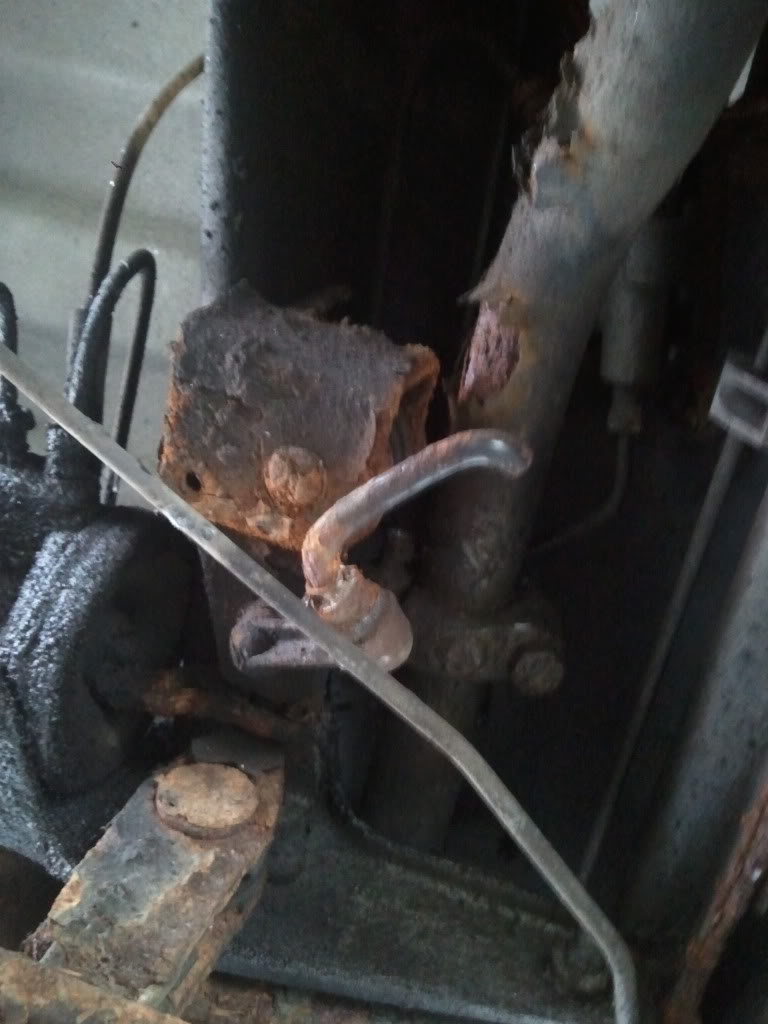

Little update been under the car and took pictures of what i found at the rear HC.
I think its maybe related to my problem.
Where could i get these parts to replace them fairly quickly?
It looks like the small metal arm has sheared off the clamp around the long bar under the car. i am guessing this has something to do with the height.
Cheers
Stuart
Posts: 28789
x 5691
That happened to mine, I had it fixed by a Sunderland garage and it was quite inexpensive.
The height corrector mechanism needs a good clean up and freeing off/lubricating at the same time as it is replaced.
Resetting the default ride height could be a lengthy process once it is all back in place.

I see, i was looking at removing it as per the guide posted up.
But i didnt see anything about resetting the height mechanism.
Whats involved in resetting the height?
Cheers
Stuart
Posts: 28789
x 5691
That bracket is - unless I have it altogether wrong, clamped to the anti roll bar and it's position is critical to the height of the car.

ah i see i think your right.
I wonder if some carefull marking of that bracket before removal would allow me to do so without complete re adjusting of the height.
Or does the little rod bolt off the bracket without the bracket coming off?
Stuart

scoles wrote: Whats involved in resetting the height?
A ramp and patience Stuart.
Not really difficult but a ramp or a pit is essential I find as it is vital that you can get under to adjust the clamp and this means having sufficient height available to ensure the car cannot crush you if it comes crashing down from high.
The job can be done on drive-up ramps with care and a lot of to-ing and fro-ing but it;s a right royal PITA to do it and frustrating.
Generally, a rough ball-park initial position for the clamp is when the 11mm bolt head is pointing more or less straight down as it roughly is in your picture.
In fact, if you mark the position of the old clamp and put the replacement on in precisely the same place you're unlikely to be far out although a little adjustment does make a good difference in height.
I'd do as much as possible, get it more or less at a drivable height and then take it to a place with a ramp or pit so the final adjustment can be done.

Thanks for that Jim, some good info there. I am understanding the linkage setup now a bit better.
I will source a new one from the stealers i imagine and try and remove the HC unit to free it off and lubricate it up before fitting the new clamp.
seems pointless putting the new clamp on to have it break due to a seized HC unit.
Stuart
