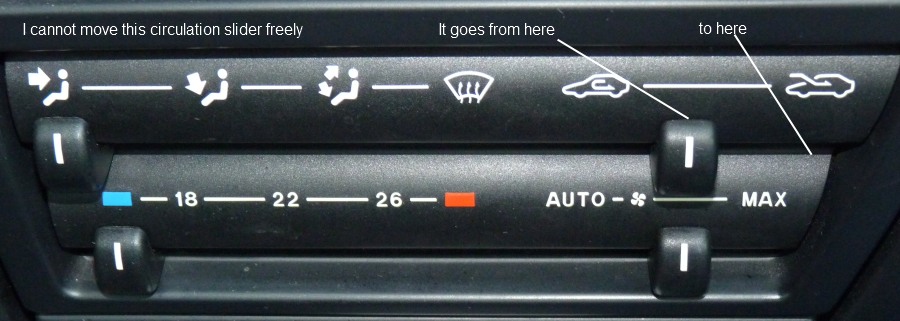

my Xantia has developed a problem with the circulation slider
all the other slider are fine and I get airflow, I just cannot shut off the vent or completely open it, its stuck half open. Any help appreciated thanks.

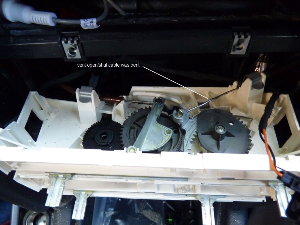

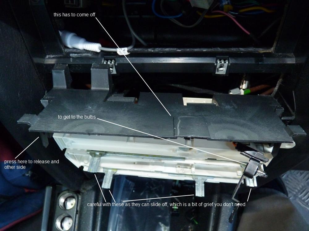

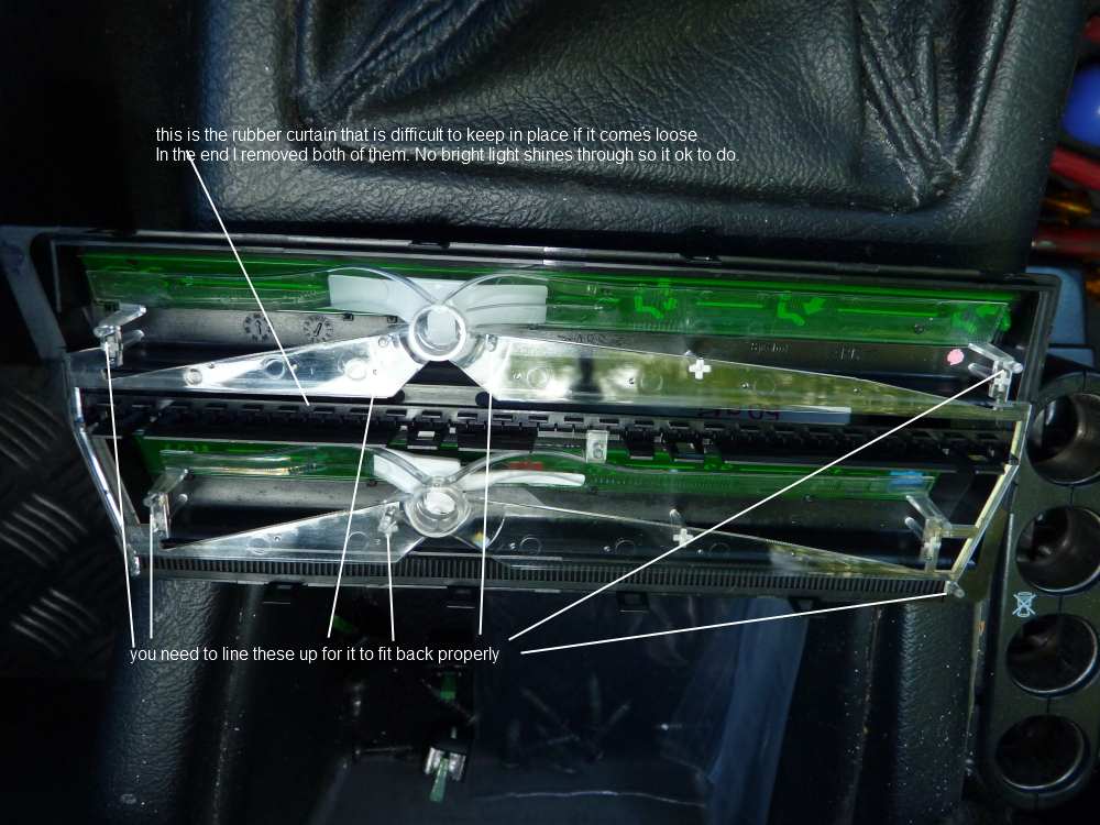

Thanks for everyone's suggestions it was a bent cable which I straightened. just adding some pictures to help anyone else in the future. These are the sort of pictures the BOL should have.
