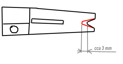

Hi guys,
the mid-high position does not work properly on any Xantia I have ever seen. Even Citroen specialists in my garage could not fix it. So I asked elswhere (Far East, Czech republic
) and got an advice, how to do it.
Here are two pics, what should be changed on the linkage to the both height correctors. Afterwards, one should move the marked metal plates along the linkage, so that the original height setting is kept.
Best regards.
Karel
Source: http://www.citroeny.cz/forumxxx/viewtop ... 7853#77853
Best regards.
Karel

That's excellent Karel. This is the first time I have seen this modification. Something else on the things to do list.

I can confirm that even with new spheres all round, our 95MY 1.9sx Estate is just like yours. The difference between High and Intermediate is a small amount of suspension travel rather than the suspension being locked against the rebound stops.
Karel - that's a very useful modification filed for future use many thanks.

That is indeed fascinating Karel, in the 5 Xantias I've had the intermediate hight never seemed to be correct, well compared to my previous BX.
I think its worth making this a sticky post.

Intermediate is better, if its set right you can confortably drive in this setting, but some cars seem to go to almost high in this setting. This can be adjusted by the above, though obviously normal is where you want to be when driving.
