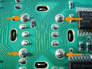

Does anyone know if there is a simple fix for the fuel gauage ?
As having put nearly £70.00 in few day ago, and only having done around a 100 miles, it is now showing just above 1/2 tank, ( my 3 ltr Espace wasn't that thirsty )!, as it's only a 1.8 , this cannot be true !

Most gauges are non linear and inconsistant, you can only really check by filling the tank to the brim, then doing it again after a few miles and see how much fuel it has used.
The only other thing I can think of is if there is a voltage regulator for the instrument panel that could be playing up, but that would normally affect all the gauges.

Hi guys, Thanks for the advice on the solder joints, you wern't wrong, all sorted with the little iron, works a treat,
didn't think the car would be that thirsty
