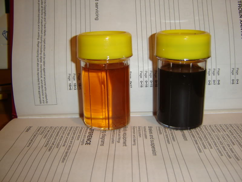

V6 Xantia auto fluid. Can you tell new from old?
Been changed twice now. I will change a third time then take a sample. Box is going lovely and whisper quiet.

Wow! :shock: Did someone put the wrong fluid in it once?

I think it is just heat Adam . Maybe V6 can post some of his recent stuff up that he changed out..........not unless he has painted his fences with it :shock: :lol:

on my 6 months one it looked vaguely transparent, I'm suprised the clutches last at all in these.

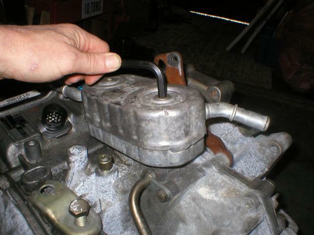

lexi wrote: What kind of ATF cooler do we have in these? It aint in main rad is it?
The transmission cooler on a V6 sits on top of the gearbox and consists of a heat exchanger between the transmission fluid and coolant.

Suspected that. So the blockages are actually in the tranny filter tray and not cooler at all. Only pic will be from an engine on the floor ? Can it be seen with air filter off then?

lexi wrote:Only pic will be from an engine on the floor ? Can it be seen with air filter off then?
pic stolen from Jim's website
It is the first think you see under the air filter.

The coolers are pretty reliable and don't seem to choke up unless, as in my case, the cooling system was full of rubbish from bodged attempts to seal a leaky matrix. The filter stops them getting choked.
Good job they're reliable. They cost an eyewatering sum of money new. In excess of £200 :shock:
That oil looked well used Lexi..
It's easy to see how the filter becomes choked over time as there'll be a lot of dust and debris suspended in that sample, a good deal of which plugs the filter over time.
That oil was better out than in, that's for sure!
The boxes do run hot and this does not help anything. Actually, all the 4HP20s I've stripped to date don't show a huge amount of clutch plate wear. They either seem to be OK or totally wrecked due to something else failing.
I reckon that with regular oil changes and a filter replacement every now and again, the 'box will live forever. They really are a work of solid engineering; it's just such a shame the filter is not easy to replace...

Ah ...that`s a good pic of cooler. It also looks like a great place to tap in and out for a proper transmission flush should I ever feel like splashing out on the Esso again :shock: Or is that just the water lines we see? Where are the ATF feeds?.
