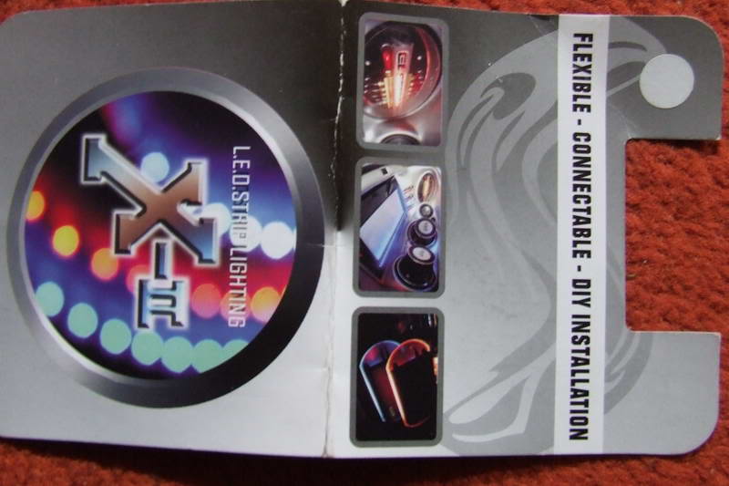

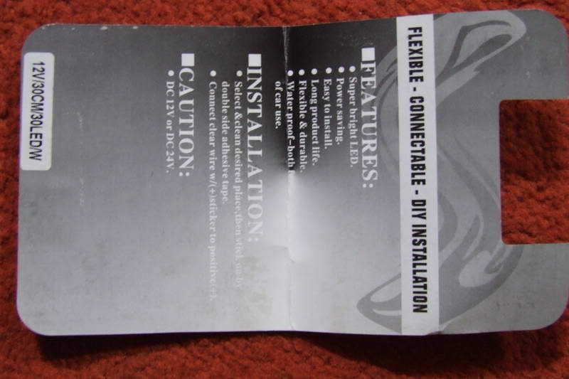

30 SMD LED's on flexible stripe with silicon insulation.
length: ~30cm and no need to cut from them.
I had to cut only part of the insulation at the first 5-6 LED's to enter properly on small space.
here its the package:

Thank you very much Citronel, you have been very helpfull. I should now be able to do the job, that was a quick response!

I want to thank Citronel for all the very good advice and details about fitting LED strip lights in place of old side light bulbs. I have now done mine, it was quite easy and only took about an hour or so out in the freezing weather! They look really good and give the car a distinctive look. The LED strips only cost me £9.00 on ebay including delivery for a set of 2 - which is cheaper than 2 normal bulbs from Halfrauds (and they dont last very long) so I'm really pleased with them, I would recommend anyone to fit them with this type of Headlight.
