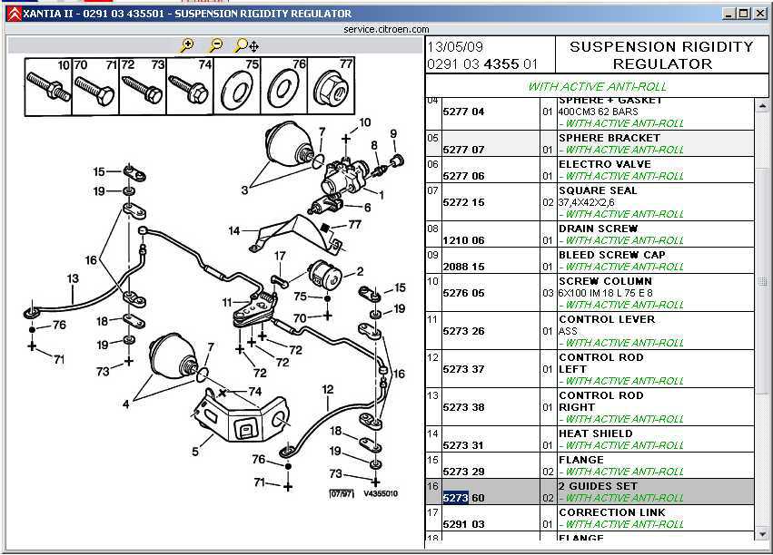

if you look up a regulator for a BX on service citroen it shows a complete break down of the above and all its parts,
if it works here is the link
http://service.citroen.com/docpr/affich ... 3%20391610,
the new O ring is part 18 and part No. 96157735
regards malcolm
regards malcolm

Hi Malcolm,
Sadly, you cannot as you need to be logged in to see it.
The best way is to take a screenshot and compress and resize it and post it as a jpeg image.
I can't right now but I can later for you.
Here is one I did earlier as an example..
How's the finger?
How's the finger?
