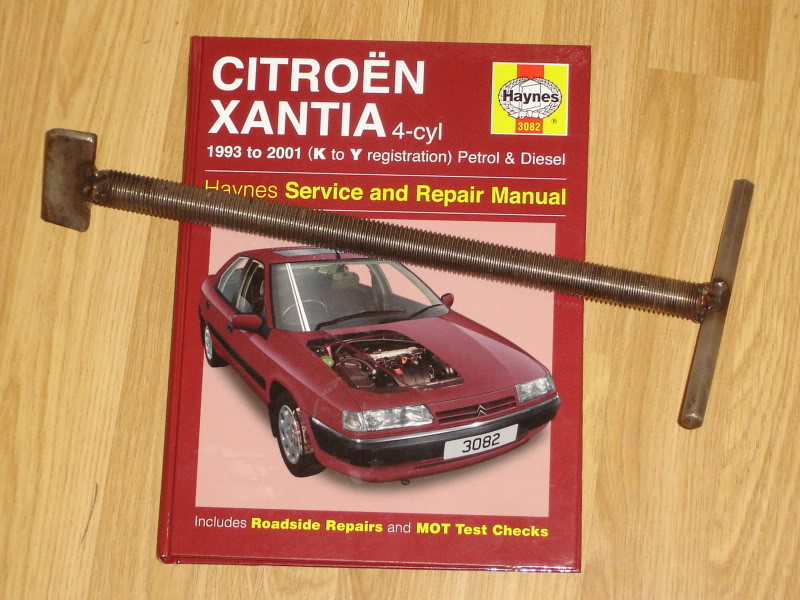

This is mine.
Made from scraps lying around garage. Cost?.........nowt but electricity and a stainless welding rod. Another advantage of having the best workshop tool of the lot...........A welder!
