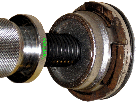

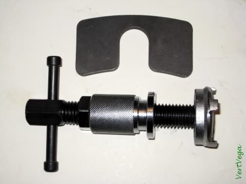

My weekend project was modification of a Brake Caliper Piston Rewind Tool Adapter :roll: .
I used only Dremel rotary tool for this job.
Adapter seen from lower face, before modification:
'New' tool is ready :D and tested \:D/

That's true, there are so many different sized piston :) and this I modified was
for a Volswagen xxx I guess. Now it is for my Xantia 8-)
Thank you for starting this thread and sending the first pics. Otherwise I would have never thought
of buying this tool because so far I have always managed to rewind the piston in :wink:
I used a little bit of imagination and some measurements and marked outer diameter of the adapter
with black pen before modification.
Here's the result pic showing how it fits the piston. There are four 'claws'.
I hope this will be helpful to others as well :D .
