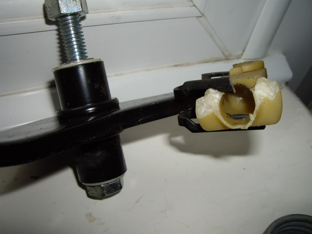

I have spent an hour in the footwell, with my feet up against the the rear window - I am not kidding.
I have managed, but I don't know how, to extricate this:
I am a bit confused as to the origin of the chite circular piece, as it's not part of the broken plastic piece. Notice in the next picture how the metal clip itself is broken:
I could not get a ratchet/closed spanner on the nylon nut. This was hell. The spanners kept falling off, and I suppose that's where the blutak would have helped, Jim.
On re-assembly, should I reverse the bolt? Did everyone else do this job one-handed?
The circular plastic thing???

The circular part goes on the pedal pivot that the securing bolt goes through, and the RETURN spring sits over it.... Its an absolute fiddle to get the return spring back in the correct place to hold the pedal down...
Later cars from about 1997 P reg, have a MUCH better return spring that runs parralell to the pedal... and it assists holding the pedal in the up postion to press the spring clip into position...

Napoleon wrote:Got it, Paul, thanks.
Any thoughts on reversing the bolt?
Yes ALWAYS!
I do every time! Push the bolt in from the heater side, then with the nut in the OPEN END part of a spanner with some tape over one side to hold the nut and stop it from falling out tighten the bolt up into the nut...
USE the open ended side because if yur bolt is slightly too long and goes upto the brake pedal BUT DOESNT meet it, you wont get yur spanner out again....
Good show! GOOD LUCK!!
