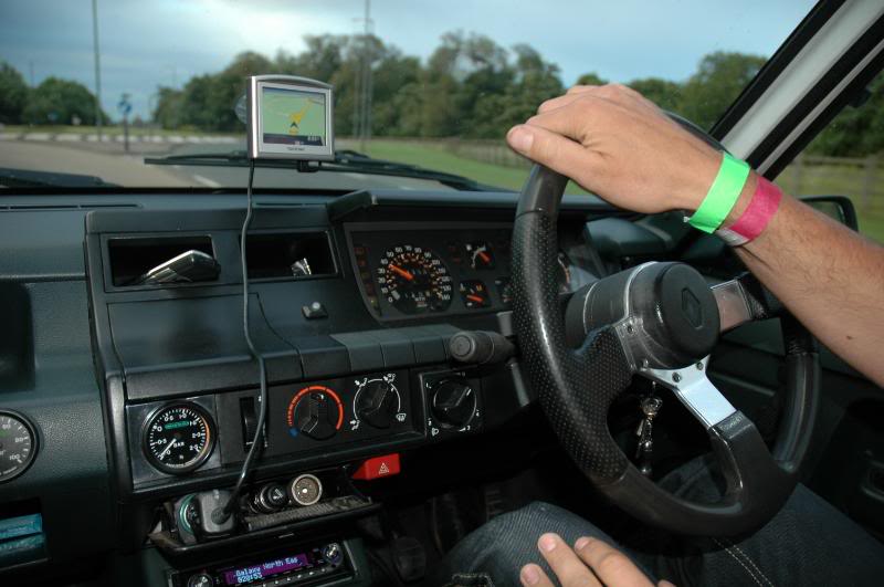

Made it down to fcs & back no problems, running really well touch wood. Here's a few pics i took whilst there.

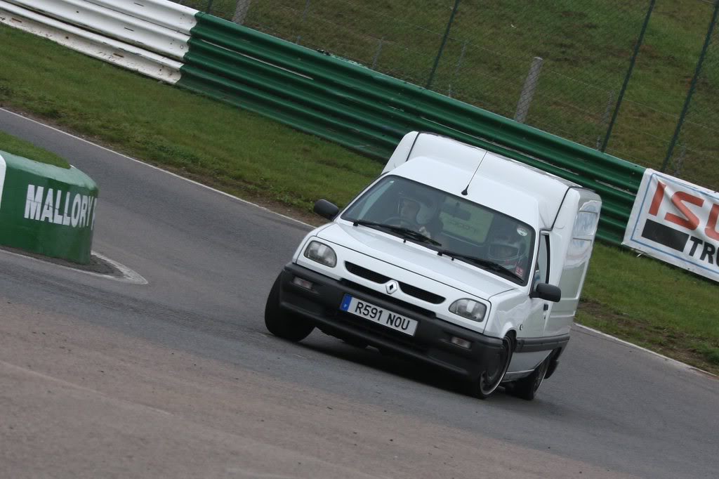

A few of pics from Mallory park
Only had a couple of sessions on track, got black flagged for oil leaking onto the exhaust out of the sump seal so need to sort that. On the plus side it handles & stops very well, just like driving a car on track really, great fun :)
As the motor has been bullet proof bar oil leak since fitting it going to tune it a bit more. Next step is a cam & vernier, piper valve springs & a couple of engine breather mods.

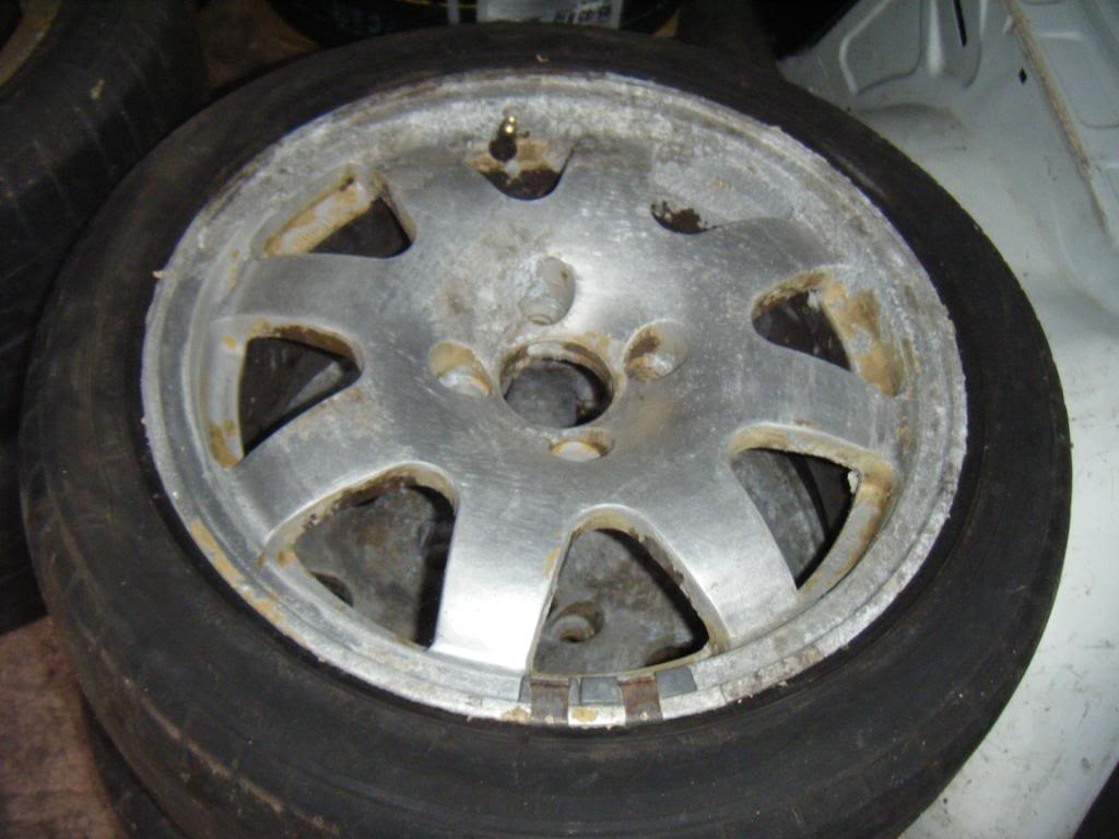

Just had a set of genuine clio williams 15x7j speedline alloys blasted/powdercoated anthracite at romax so i can take the turbines off for winter.
Picked them up cheap'ish, Half polished/corroded alloy, paint flaking, super bald/slashed tyres, all were unkerbed/straight though.
Before pics...
After pics....
Quite pleased with them. Wasn't 100% whether the shape of the alloys would suit the van but imo they look good. Nice & low maintenance compared to polishing the outer lip on the turbines every week to stop corrosion.
Fitted 195/45/15 toyo proxes 4rf, cheap enough for full set new off ebay. Seem pretty good now there scrubbed in a bit. Only need a new set of centre caps to finish them off, will have to wait considering the price £16 ish each!
