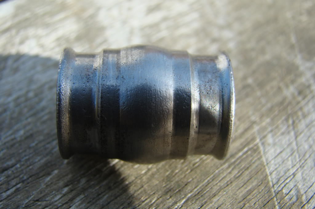

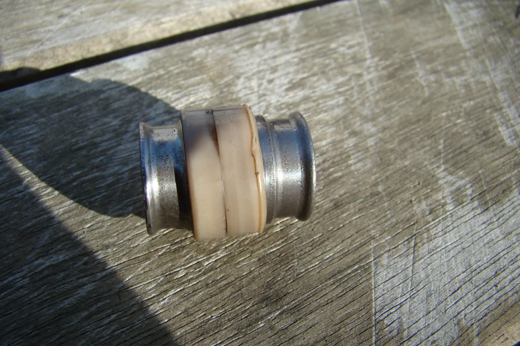

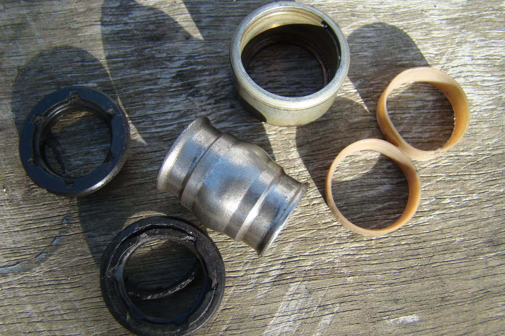

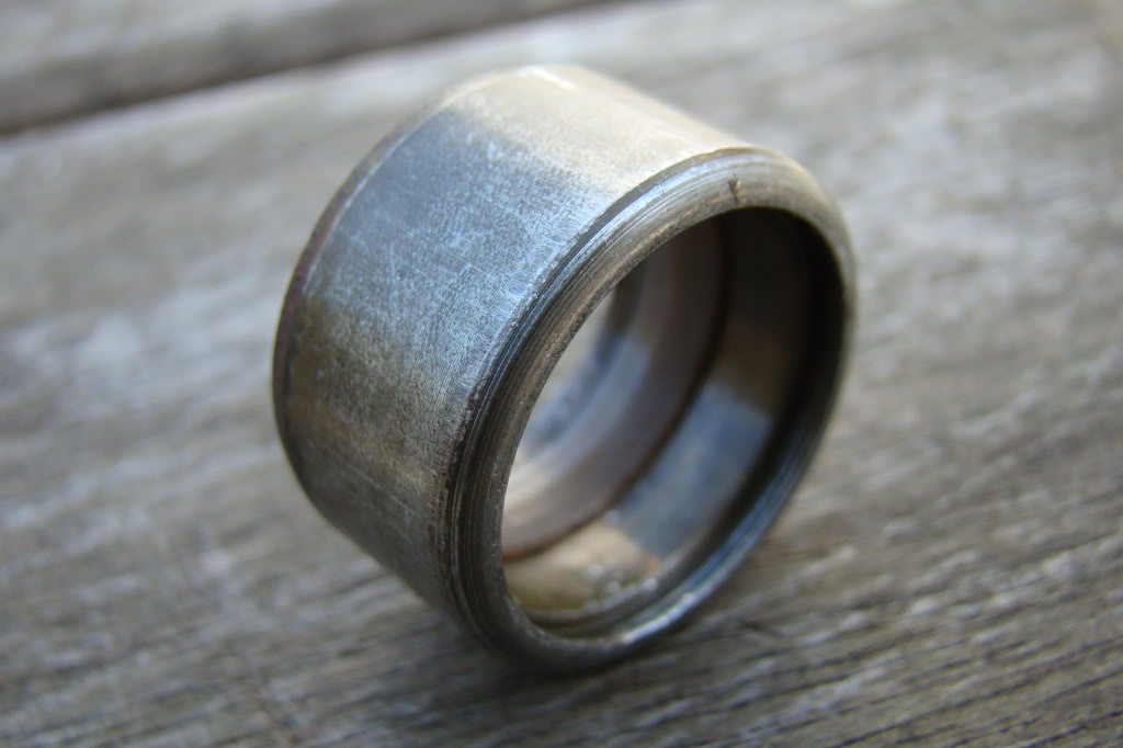

Well thanks to Jim, 1 x worn bush arrived with me this morning, I have taken all relevent info and had a realy good look.
The answer is...... we are all wrong? it's not a bush at all, it's made more on the lines of a bearing.
Stripping it, there is the external sleeve, this is then fitted with 2 x nylon half cups, this is to enable the whole arrangement to twist and turn in all directions needed. The centre sleeve has a radius so that it can move freely in the bush. The rubber that hangs out from the sides is a couple of seals to stop the dirt ingress.
I still belive that a replacement would be best made as a rubber bush as this would still allow the movement needed, whereas the solid type will not.
Photo's for those interested.

Hello Martin, that is a rose-joint by any other name. That is nothing like the bush I removed from the rear ram of my early Mk1, prior to replacing it with my current bush system.
The fact that Citroen decided to use a woefully undersize rose-joint for this application shows somebody got their calculations wrong. As far as I can see, the bottom location of the ram rotates in two planes, not three, so why did Citroen decided on fitting a joint, instead of a bush.

Hi Martin, even £150 is still too much for a rose-joint. Some of the suspension links I have made for motorcycles only cost between £6 to £30, are fully exposed to the elements, come from the aero industry and never wear out!
The inner bearing sleeve looks rather pitted, as if it has picked up a lot of crud, which has probably acted like grinding paste on the two polymer bearings. What are they made from?
Why didn't they use stainless steel for the inner sleeve and graphited nylon for the outer bearings? Still think the whole lot is undersize for the loads imposed on it.

I'm well impressed with the Post Office I posted the bush late on Thursday evening Martin...
It is interesting to see what's inside.
I agree it's woefully inadequate and a well machined 2-piece bobbin made of PTFE would seem to be a far better replacement.
What's PTFE rod like to machine? The Nylon 66 I've usd in the past machines beautifully.
Now we know what is in the "bush" how good a material is nylon 66 for this thought to be? As I've said, mine lasted very well.
