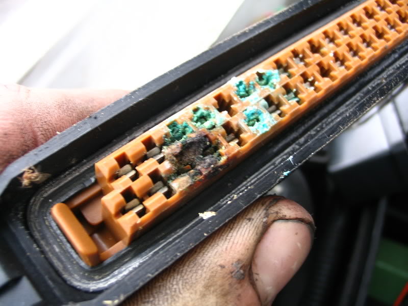

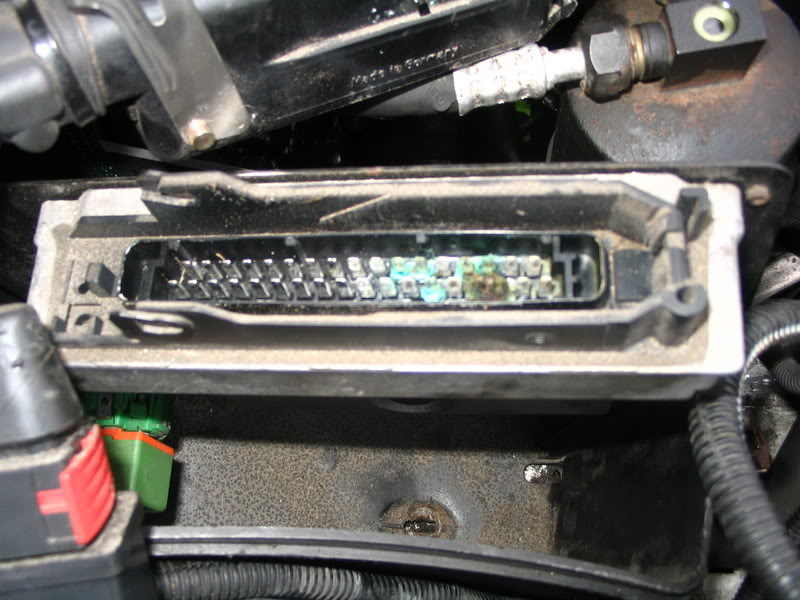

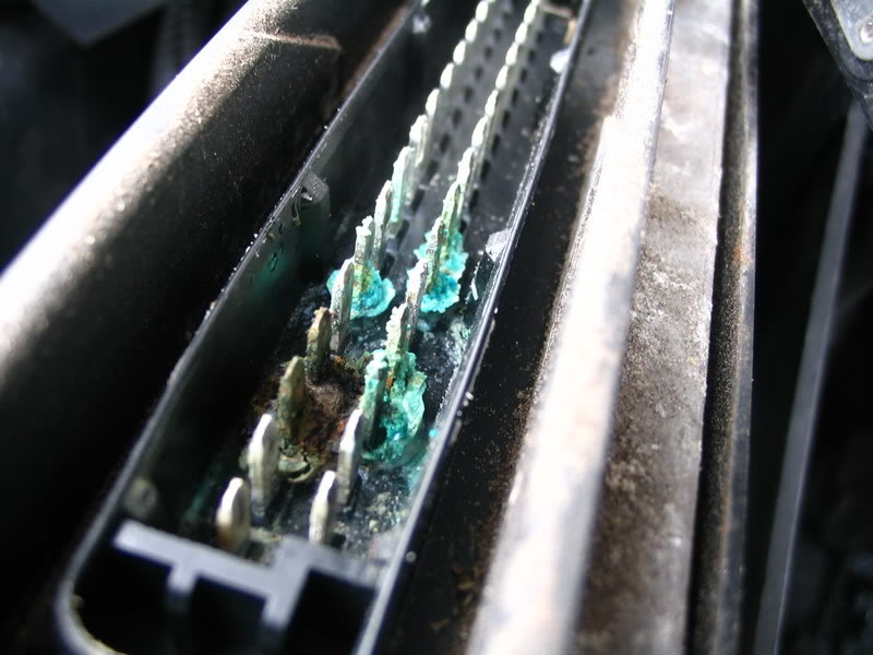

Heres the pictures at last!
Image[/img]
Virdict anyone?

I would scoosh it with WD40 and plug it in again.
Maybe they are all like that, I'll look at mine tomorrow.

Hmm, not good I can see why you're concerned, a good clean up is in order there.

Would've said that doesn't look very clever; Citroen didn't design it look
like that!! Closer examination and cleaning combined with regular checks
may be called for!

Once upon a time I had a job where I had to repair this sort of thing.
My first recommendation would be to go to a scrapyard and get a replacement ECU and connector.
It is particularly important to replace the corroded and burnt contacts in the connector, because they will have lost some of thier spring tension.
You could cut the whole thing off and splice in a replacement, or (my preferred approach) you could just transfer over a few contacts as needed.
It should be possible to just clean up the contacts on the ECU, but the resulting bare copper contacts will corrode again very easily (hence it is better to replace the ECU if economically possible.
If you do keep your ECU, filling the connector with silicon grease should keep out moisture and oxygen which would cause further corrosion. I don't normally recommend silicon grease in healthy connectors, as any contamination of the grease can lead to tracking, and the grease itself can hold any trapped moisture.

It looks like two pins (3&4 up from bottom left?) are linked by a soldered plate and that the facing sockets are burnt/melted. :?:

Found a similar problem on my ecu a couple of years ago, a sort of yellowish gunge around the base of several pins, one of which was almost corroded away. I very carefully cleaned out thegunge and scraped corrosin off the pins (didn't seem to be any in the corresponding plug fortunately) then rinsed several times with wd40. Some suggest not using wd40 for this, and in hindsight i would probably use ACF50 now instead (a corrosion inhibiting dielectric spray from the aircraft industry, mainly available from motorcycle dealers - not cheap but does seem v good stuff).
I looked at the option of cannibalising pins from a secondhand ecu but don't think I would have been able to do it without risking further damage. Was very careful when reinserting plugs to ensure the weakened pin was straight and mated with the plug properly. Touch wood have had no issues since.

Get Servisol contact spray. 3 quid a can......great stuff.
