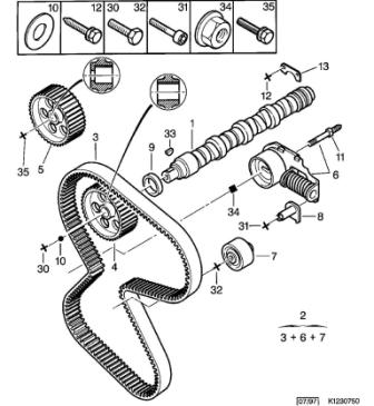

Thinking further, the engine mount has to come off to get access to the tensioner..
It looks like this:
Item 31 is the problem. That is, after I've got the mount off but I'm not so worried about that. I reckon once I can get at it, a removal method will suggest itself. A bit of localised heat, hammer a socket on it if I can get the engine up high enough, file flats on it, Mole Grips even, given it'll be replaced with a new one.
Rather than being defeated by it, I'll take up the challange...
Mike and Ken, thanks for bringing some sanity back to me :D
