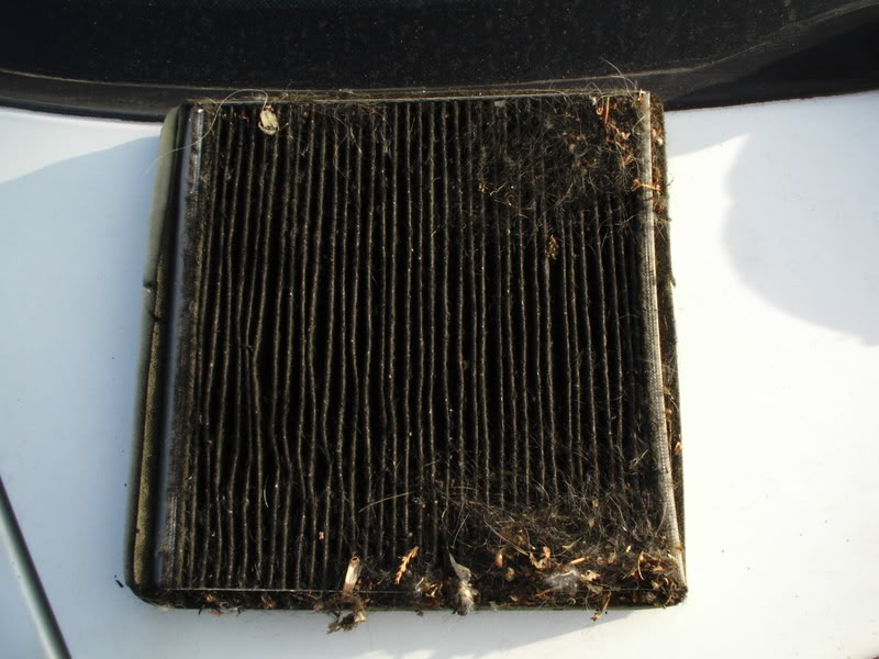

For the benefit of anybody contemplating the above job. According to the Haynes Manual. Removal of the above is carried out by "2 Remove the 3 securing screws and withdraw the lid from the Pollen Filter Housing". I spend a considerable length of time searching for the 3 screws concerned, to discover that these screws do not exist in my car, which has a lid that slides off towards the centre of the car. Just thought I'd pass this on & save others time & frustration. ( Perhaps this "Pollen Filter Lid Removal", differs from car to car)

Yep, I did mine today as well and was wondering where the hell the screws were... :D
Looks like the filter in mine was in there since the car was made. Clogged isn't the word.

Snap! Took me ages to realise there were no screws on mine, just slide bottom cover towards centre console. I wondered why I wasn't getting the screen demisted....

Mine looked like that too, a hundred thousand miles of bugs, it demists better now.

Unread post by jmd »
Mine was not that bad, the car is year 99, purchased recently. The Filter had an 05 date, so evidently it had been renewed. I washed it & left it out to dry, on one of the Sunny days last week. The LHM fluit looked terrible, and I am now running on Hydroflush. So much for "Full Service" history. I often discarded better looking LHM on my old car after 30,000 miles.

TehAgent wrote:er... where exactly is the pollen filter? as my car has a hard time demisting, and after reading this, I'm going to put it down to the pollen filter.
Pull down (after removing the screws) the carpet under the glove box.
There's a long thin panel to the right of the motor.
Slide this aside (I can't remember which direction, but mine was very tough) and then pull out the old black feather covered filter.
Make a note which way the slanted top goes.
Either wash or replace.

Slide towards the centre of the car- away from the passenger door. Although the earlier models pre 99 may have 3 screws
