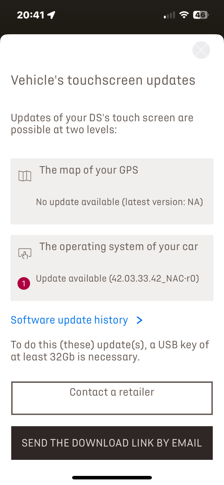

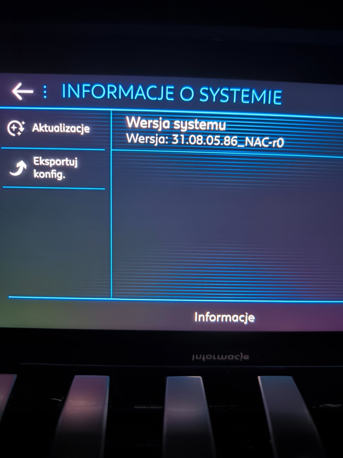

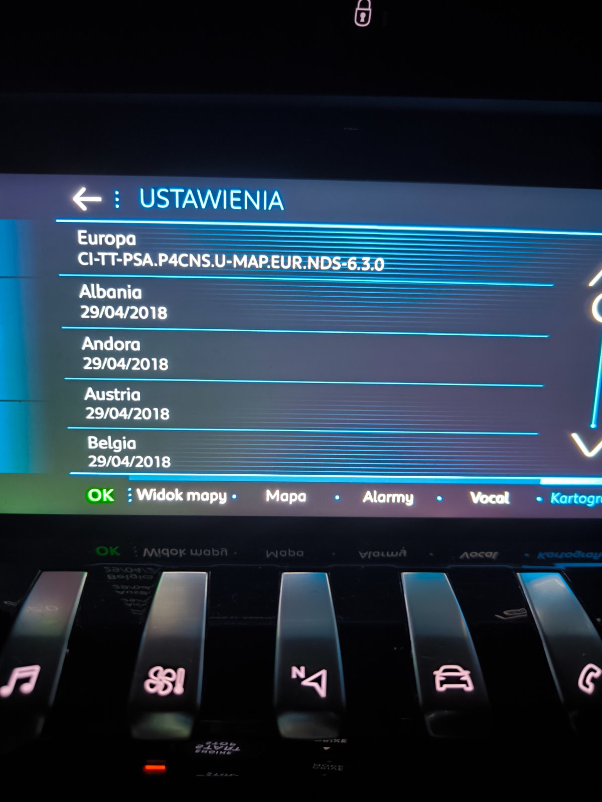

Hi
Anyone can help me with license file on my ds? the current system is 31/09/46.62_NAC-r0. I would like to update it or at least upload new EUR maps because it is 2017. how to do it, what to download?

Good evening everybody, many apologies for jumping straight in with a question but has anybody experienced issues with updating firmware and mapping?
My 2019 1.6 225 ultra prestige just won’t allow any update what so ever! I’ve even been down to the dealer and they couldn’t get either to upload!
They have raised it with DS technical in France, and have said they will need my car for the whole day as nobody knows what the issue is…oh and there is a £132 charge
Has anybody experienced this and does anybody have a solution?

It's because the certificates have expired - the firmware it is trying to install was itself released around June 2021, so is already 4 years old, and you will have an earlier firmware installed. Since then, there have been 5 later versions, with the latest for this Wave 4 system on 44.07.33.32_NAC-R0 (August 2023).
After a certain time the firmware certificates that authorise installation become out of date, so they won't install. There's a few like this and you usually have to wait until they re-sign and update the certificates. Hopefully the garage has advised technical staff of this - like others.
If you have the VIN, I can provide you with the file for the version it is trying to install and the latest version if you like. Please post your VIN in full without spaces - it will be automatically masked from public view after submitting your post & will only be visible to staff.

Re: PSA NAC RCC Updates
This is a NAC Wave 3 (ecuType = NAC_EUR_WAVE3) infotainment system that needs to install the firmware version 42.03.33.42_NAC-r0 first (but for the NAC_EUR_WAVE3), which converts it to a NAC Wave 4. Only after that is it possible to install the NAC_EUR_WAVE4 firmware or the P6CNS format (for EUR_NAC_WAVE4) maps/cartography. It is pointless to try to install the 44.07.33.32_NAC-r0 firmware version directly, which is only compatible with the NAC_EUR_WAVE4 (see "EcuCompatibilityList" in the "UpdateInfo.xml" file).
Notice there are 2 different 42.03.33.42_NAC-r0 firmware versions, one only for NAC_EUR_WAVE3 systems with the UpdateID 001315031622734386, and another for the NAC_EUR_WAVE4 with the UpdateID 001315031622725679.
But yes, the problem is the expired signing certificate used in all the NAC_EUR_WAVE3 firmware. And quite frankly, PSA/Stellantis doesn't care about this or the firmware for the NAC_EUR_WAVE1 systems anymore, both impossible to install in the last couple of years. At least the NAC_EUR_WAVE1 still has map updates.
Unless the head unit is connected in a workbench, I'm afraid it is impossible to install any firmware in a NAC Wave 3 system.
Hey Marc
If u can help me with license file on my ds vin VR1**************[VIN obfuscated, can be read by forum staff] and please share me this version

@Bartek2308:
OK, so yours is a Wave 3 unit and needs the bridging firmware I've mentioned in previous posts. This will take it to Wave 4 software.
Again, there may be a certificate issue with the firmware, as you'll currently have at the very latest, 2018 firmware on your vehicle - so that's been 7 years since it's been updated.
So the files may have expired, and the reason why you can't update the system.
In case they have released an update, I'll provide the files and licence info below which you can try. There are no guarantees and if it will not install, then you need to contact your dealership and complain.
Firmware Version 42.03.33.42_NAC-r0
Bartek2308 Licence File
Instructions for Updating NAC or RCC Firmware, Maps & Licences
