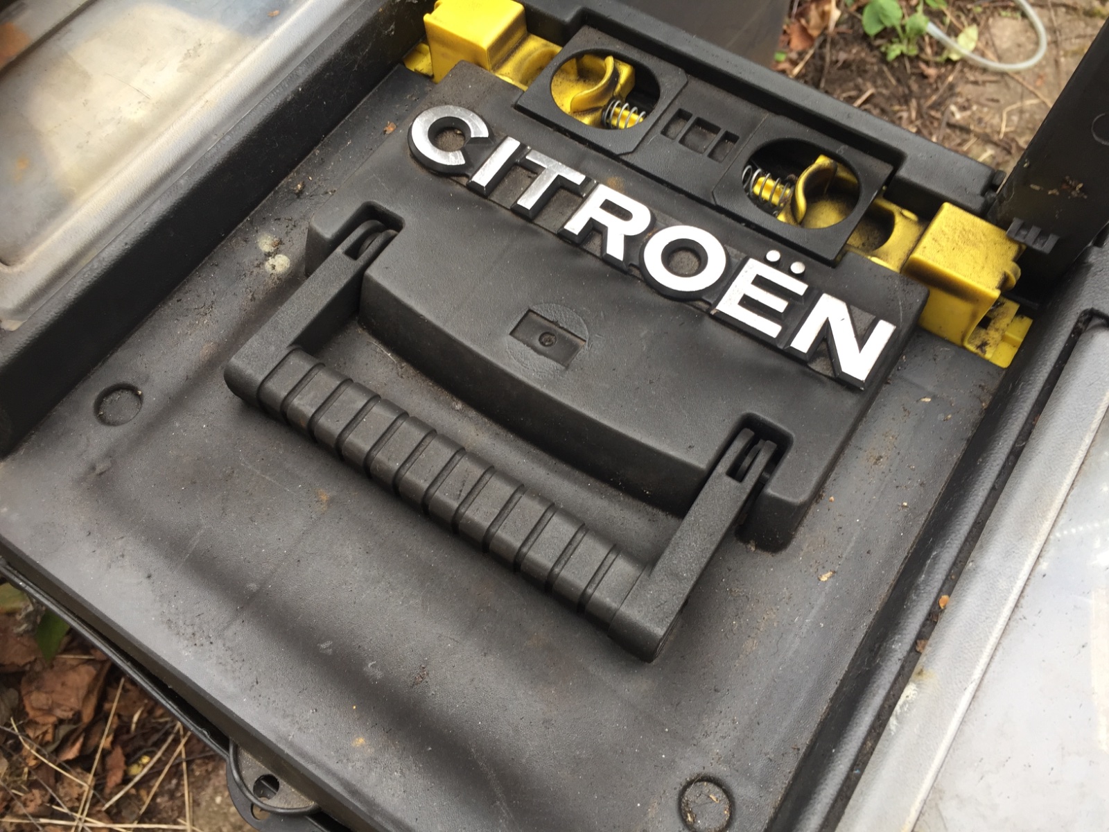

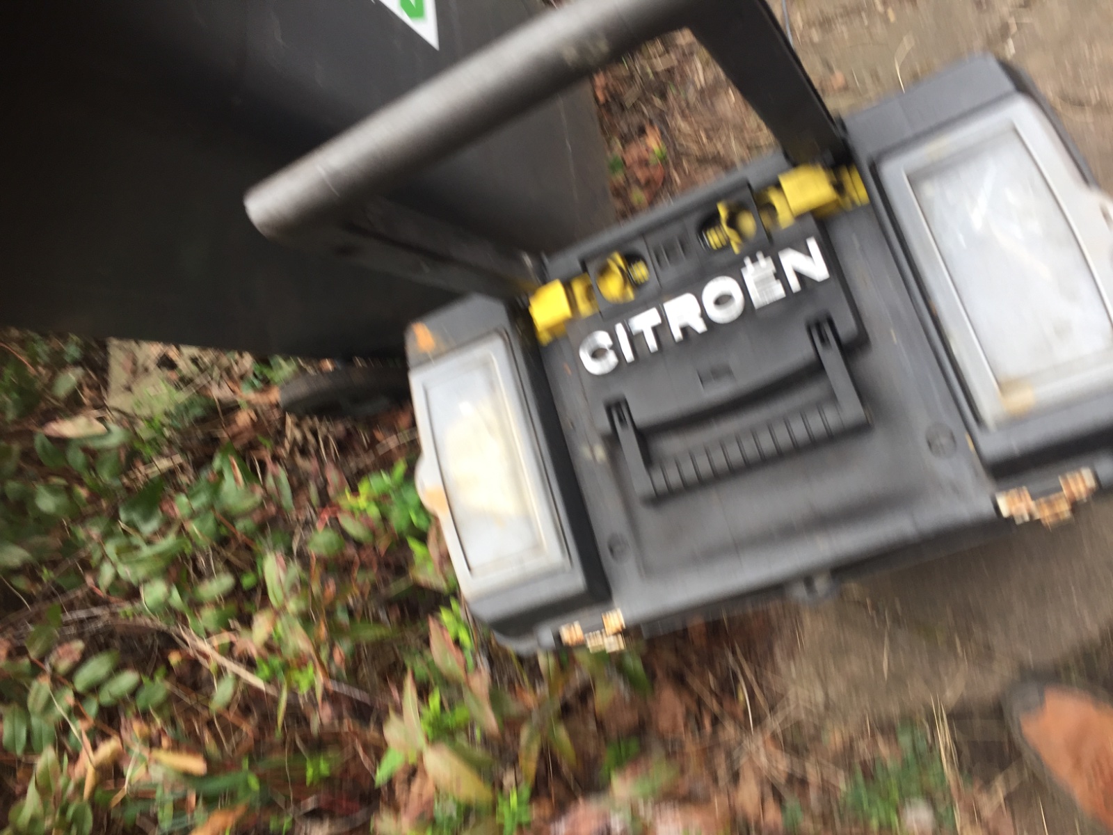

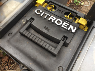

Oh, nearly forgot.
This is what I did to his tool box!!
