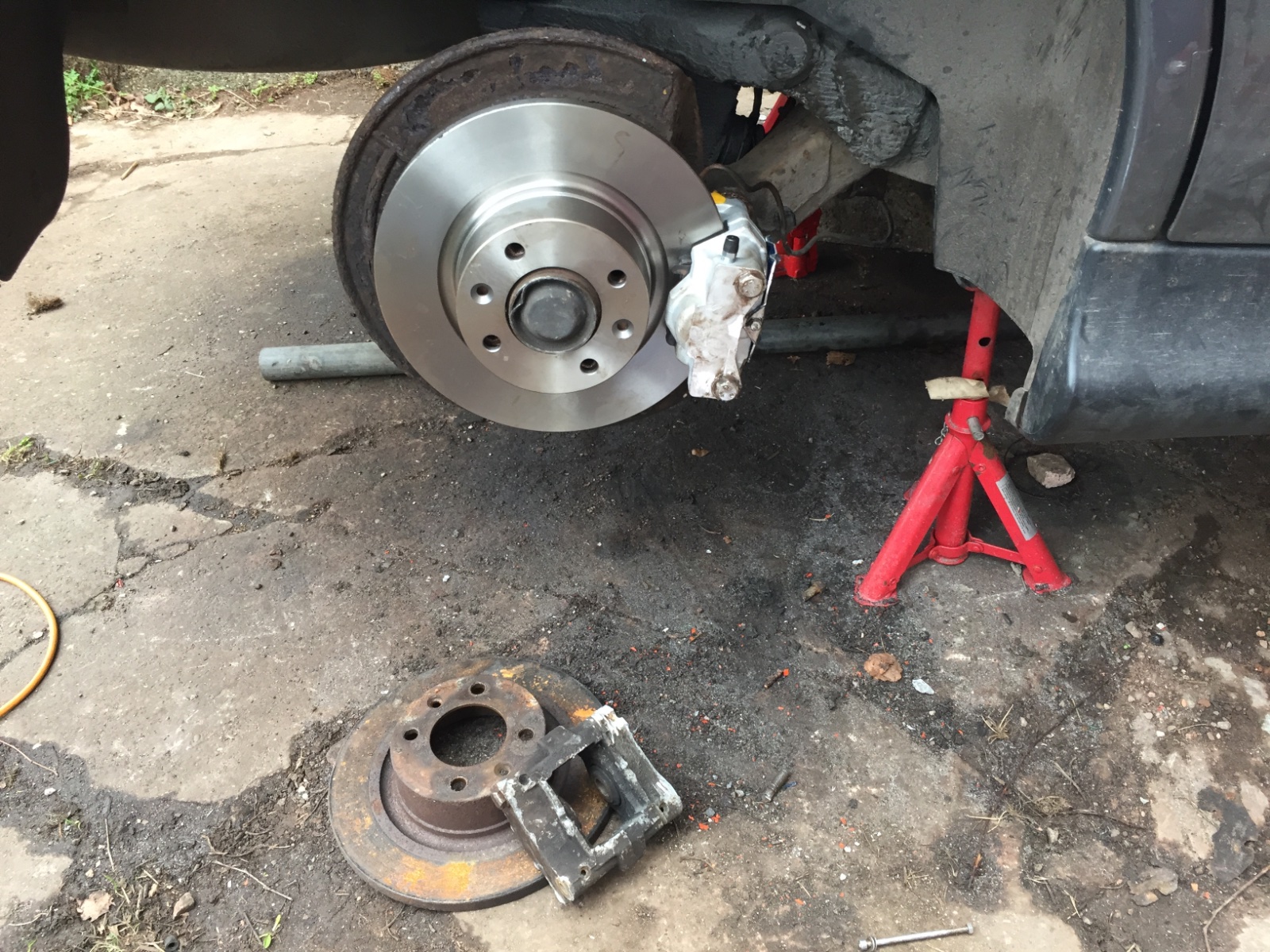

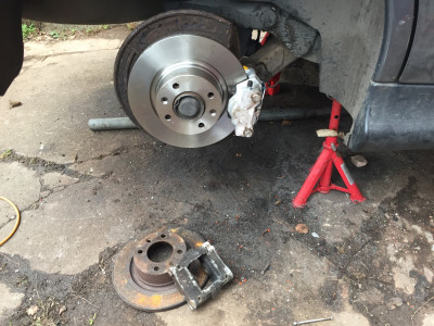

Well, the reason the big hammer failed was because the Old Fool had not fully cut through the bottom bolt. :rofl2: When he did, there was almost a twang followed by the tinkle of tools ie cold chisel and hammer through screwdriver hitting concrete. A little more of the Zinngy Spannner 8-[ and off it came!
His stud extractor is now googats so he's ordered a new one. :-**
To show the level of violence required, here's a pic of my nice new RHS brake with the googats beneath.

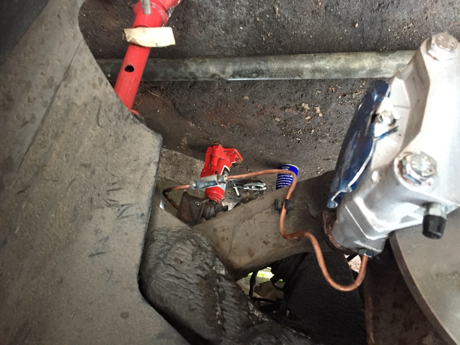

More parcels today. The postman brought disc screws, brake flare nuts and some new pipes. Then the chap from DHL delivered a MASSIVE box with a brake bleeder and a big bottle of brake fluid while moaning about his aching back. Daddy has decided there is no way he can get the old pipes off the hoses so he's going to cut them and join them. He knows what he is doing. He looked at the other end of the hose and decided it would be like working through a letterbox!!! So iPad tells me he has ordered a pipe cutter and some brake pipe joiners.

My RH rear brake is plumbed in but not the LH. Papa has been working on the pipes, now that he had bought the CORRECT size fittings!! now you know why I call him The Old Twit.

Good news! My googats rear brakes are now non googats!!! :clap: :bl: :notworthy: :yeah: He has bled them with his pressure bleeder and has got loads of air out of them. The joints are not leaking and I feel good!
