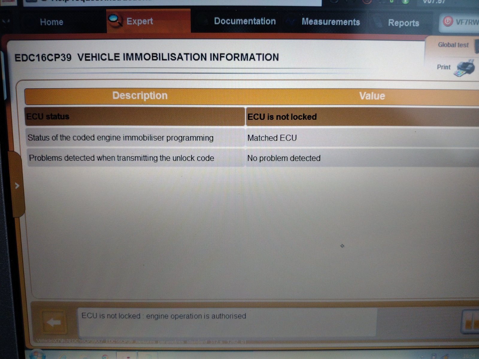

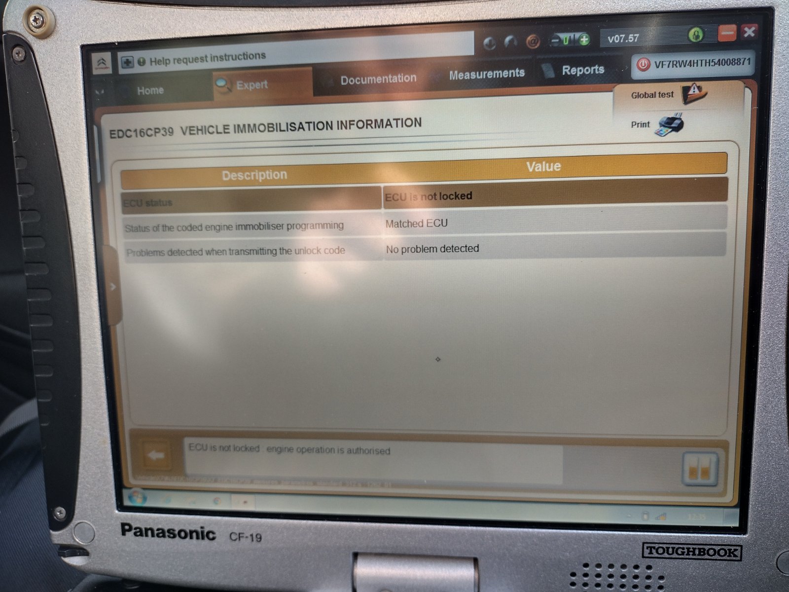

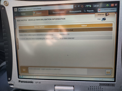

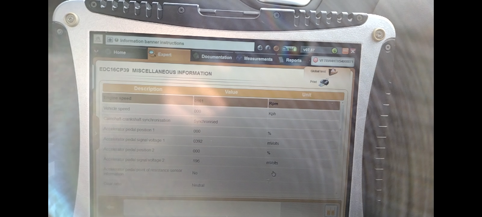

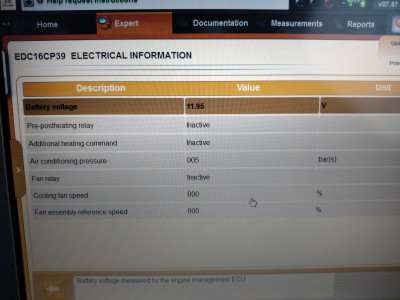

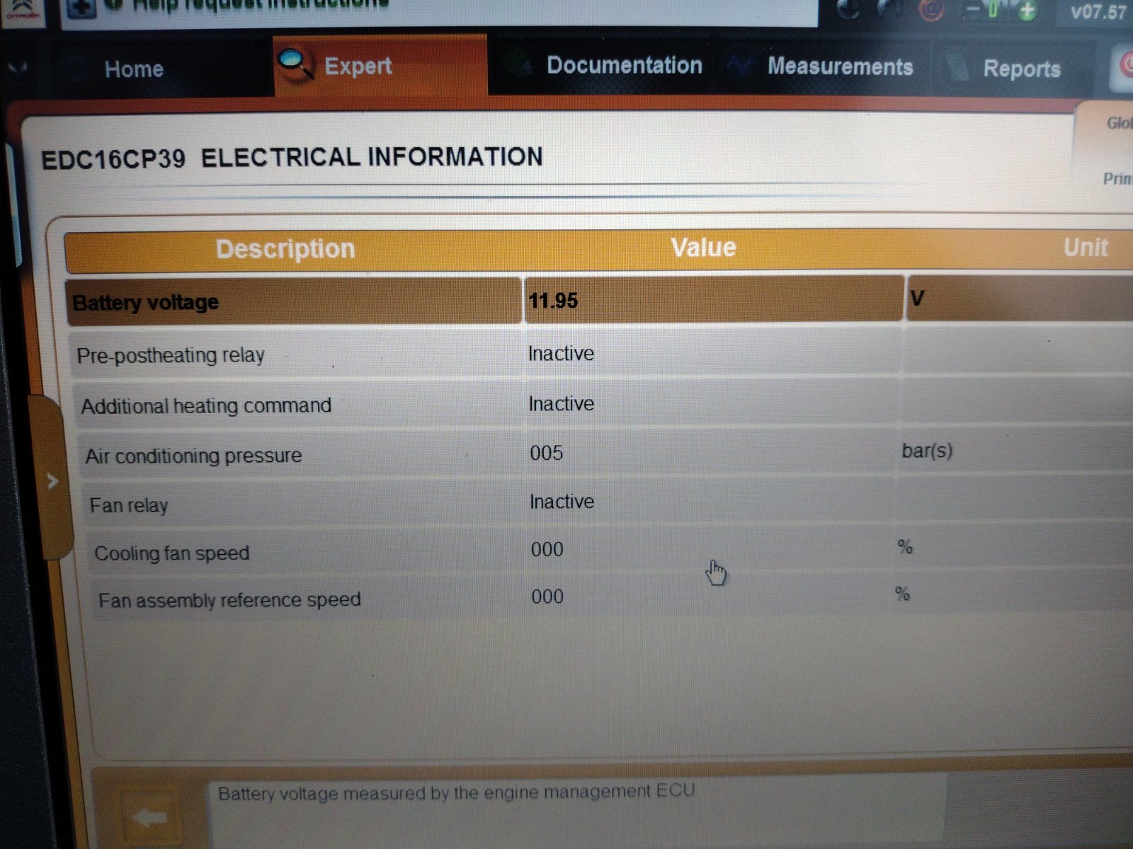

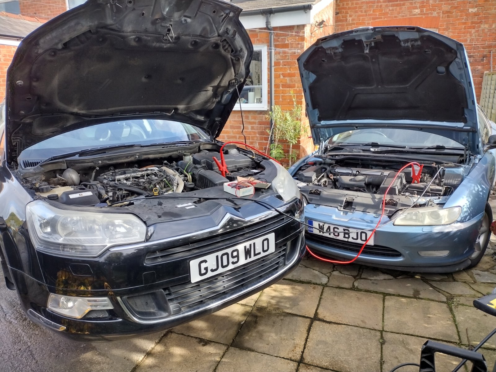

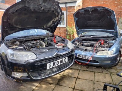

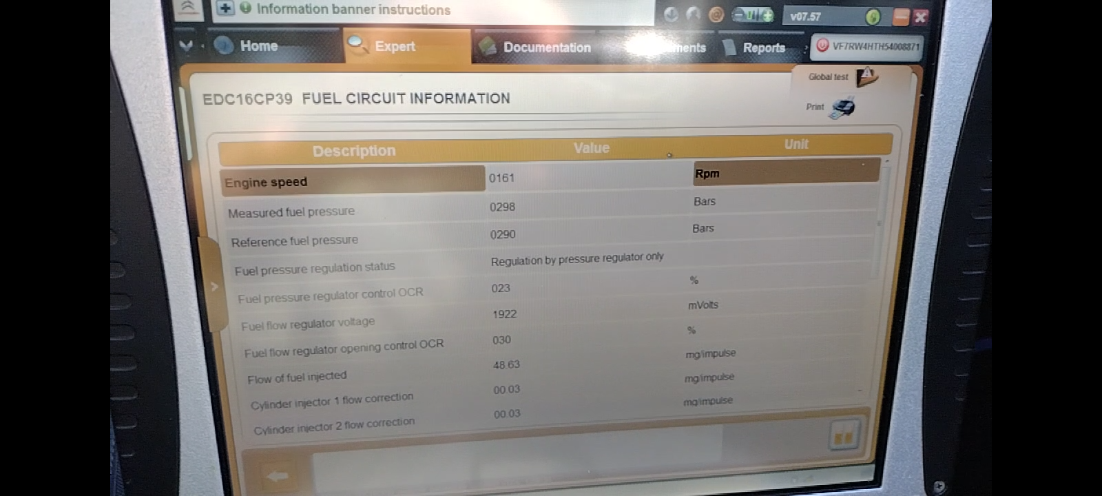

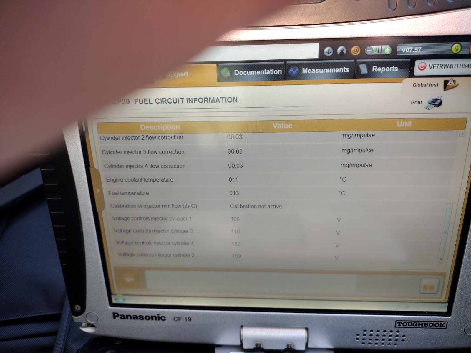

Ok, rain subsided so fired up my Italian built jump pack
- Posts: 5315
- Joined: 25 Apr 2022, 09:03
- x 2341
- Posts: 5315
- x 2341
Re: C5 X7 no start (or only runs for fraction of a second)

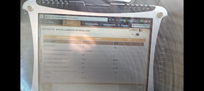

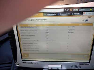

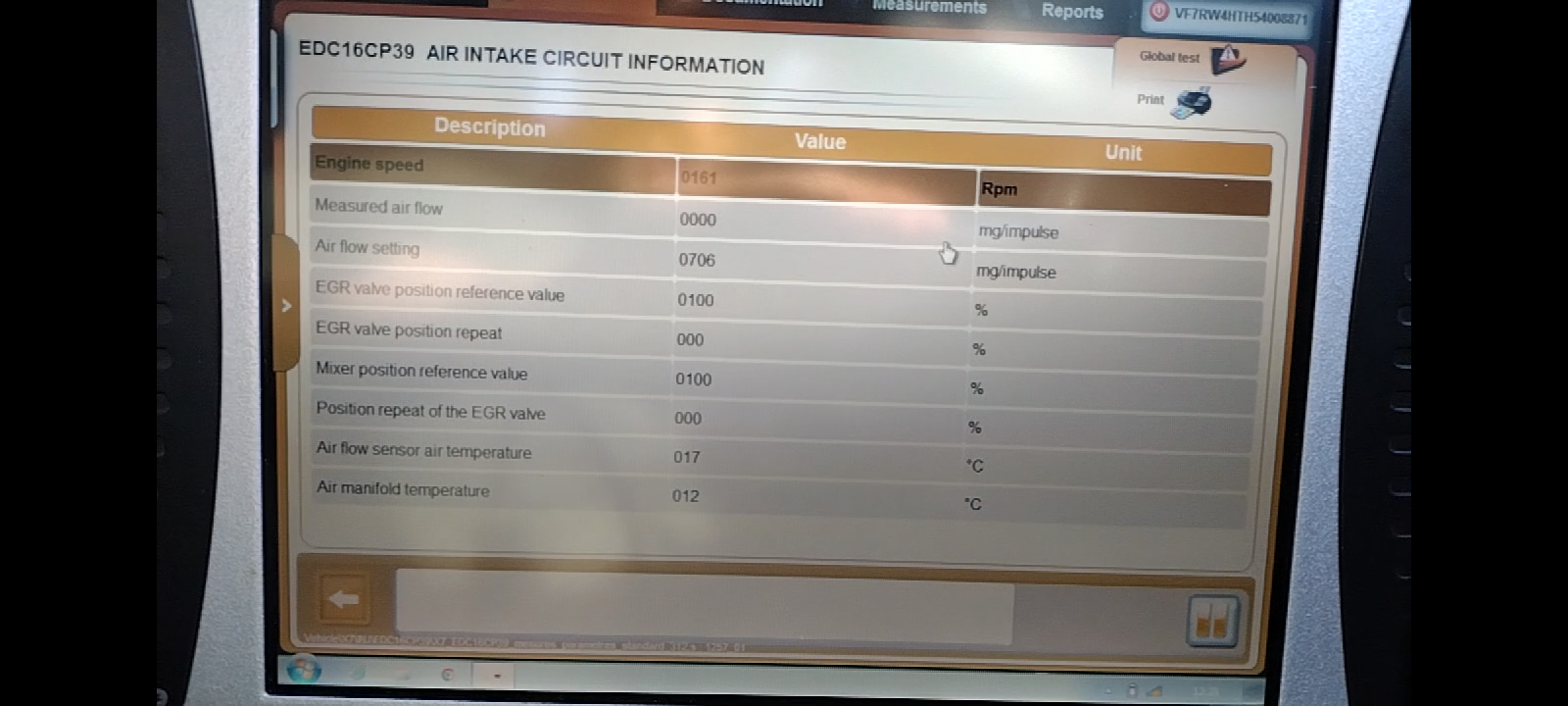

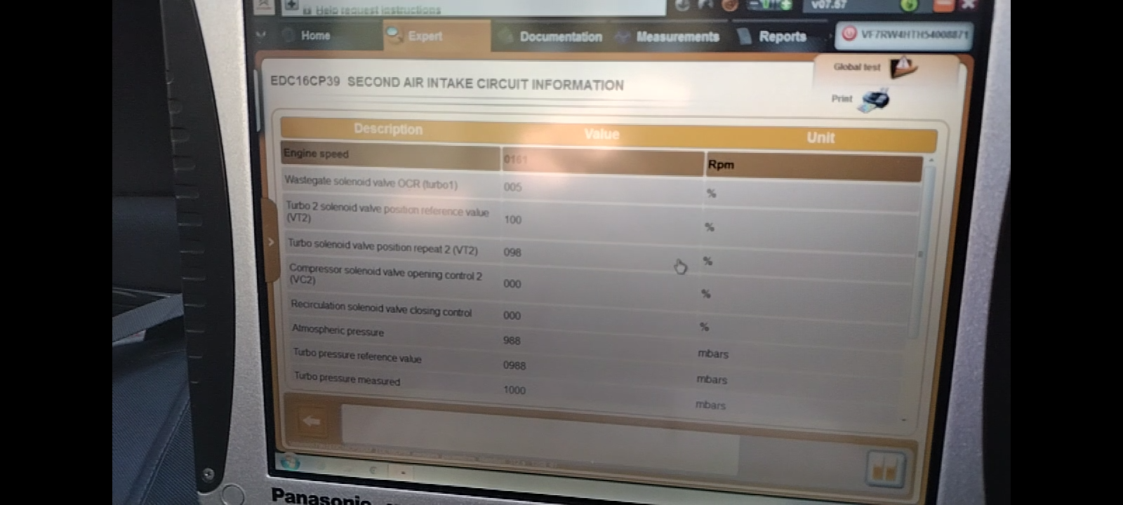

This confused me - airflow shows zero when cranking. Clicking the row says something about EGR so wondering if just a red herring
Can't see anything untoward on any of those.
Easy start trial again after dinner , if weather ok and can borrow a helper again
Matt
Matt

Coupe connected up as jump start booster again. Intake hose off, under cranking increasingly large squirts of firstly WD40, then brake cleaner (run out of Easy Start, both these are combustible and I believe should do the trick)
Nothing, not even a cough of life. As mentioned by others earlier in the thread, the above suggests timing.
I can (triple, quadruple?) Check the timing again next weekend but was happy last time it was correct.
As per
viewtopic.php?t=42544&start=15
I'm now looking (locally preferably given the need to draft the damn thing there most likely) for someone (I.E. a garage) to investigate and find whatever it is I'm clearly missing.
Weirdly popped up to say hand brake faulty (then message disappeared again) - suspect low battery voltage behind that.
Matt
