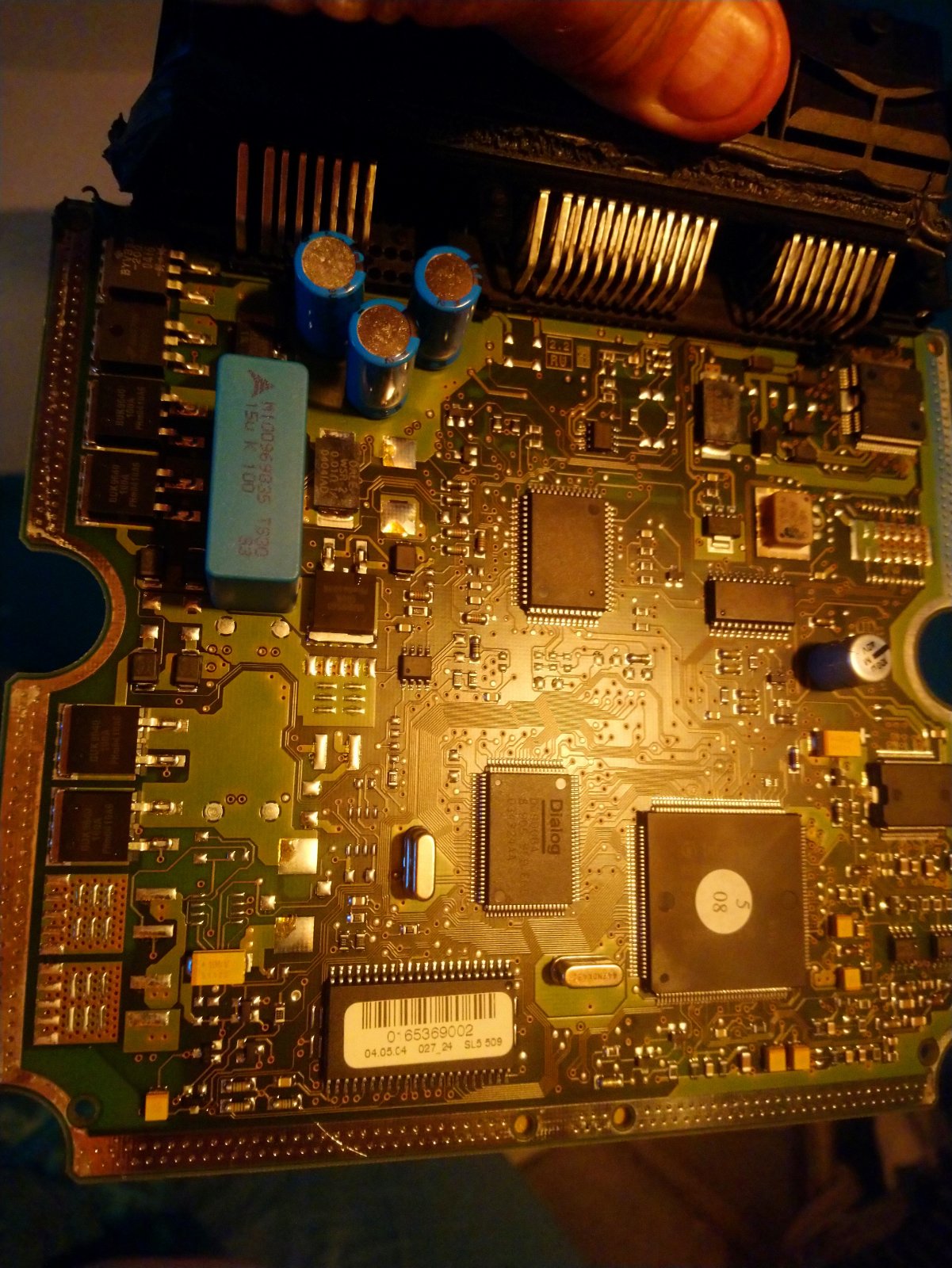

Looking at wireing diagrams the cars ecu had issues with cruise control and cooling fan slow speed. From what I can, see on wiring diagrams they are both associated with 32 pin grey connector on the ecu..
So.. I'm wondering now. If there's anything obvious inside the ecu on that socket area in put. I shall see if I can open the ecu up..
any ecu gurus on here once it open who may be able to spot anything..?

I am not an ECU guru in any form, but I would look for any 'grey' solder joins (as opposed to nice silvery ones). A grey join is what is known as a 'dry' join, and is a poor electrical join. Touching it with a soldering iron may well sort it out. My Mum had a problem with her computer keyboard (many years ago), and various 'repair' places had not resolved it. I asked Mum which keys were involved, and then searched the tracks associated with just those keys. One dry join leapt out at me, and a touch with a soldering iron permanently fixed that fault. (The difference between a dry join and a good one is like the 'grey' side and the 'shiny' side of Bacofoil).
If you do not find a dry join take a very close look (maybe with a magnifying lens) for any joins with cracks in them (they can be hairline fine, hence the magnifying lens). Should you find one a careful touch with a soldering iron (and a tiny dab of solder) should fix it. However, if you find one does not mean there won't be more, so keep looking. The most likely place is where the connecters are fixed to the board.
If you do find any dry/cracked joins (and fixed them) DON'T put the old ECU back in. It is the only device with the CORRECT mileage (for that car) in it. See if you can find a company that can reset the mileages on the instrument cluster and the replacement ECU. If you do, send them off (explaining the circumstances), and hopefully they will reset them back to zero for you. Then put the instrument panel and the original ECU back into the car. The instrument panel will then get the correct mileage. If the car then works properly you have a spare 'virginised' ECU available for future use, otherwise, if you need to use it, it will get the correct mileage from the instrument panel.

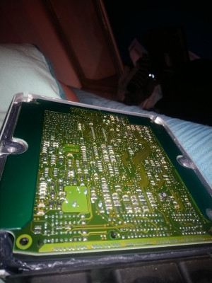

Thanks James. I've got it open. And I don't have enough time to go through it lol. As in its very integrate.. Attached some pics one of each side of the ecu...
Couple of resisters there to check with meter lol.

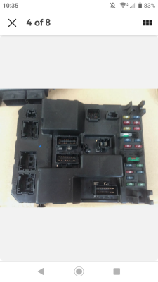

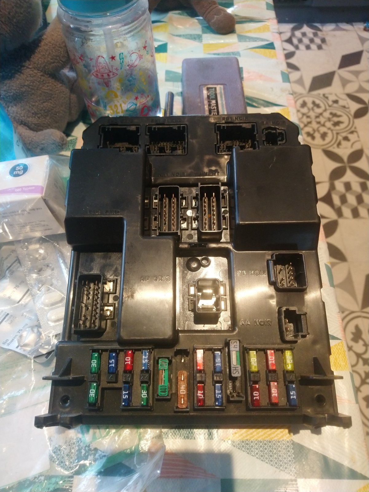

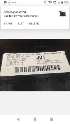

Question.. I've seen another ecu bsi set on ebay for 55 quid.. Now the bsi is identical to my original one which cooling fan and cruise didn't work on.. But Im concerned over dates.. As attached. There's a year between them. Mines got 04 date on it the ebay one 03.. Do these dates matter as long as they are identical..?
Ebay one.. My original.. I put an, earlyer bsi in which is what I'm sure is causing the window issue.. And lack of auto wipers
