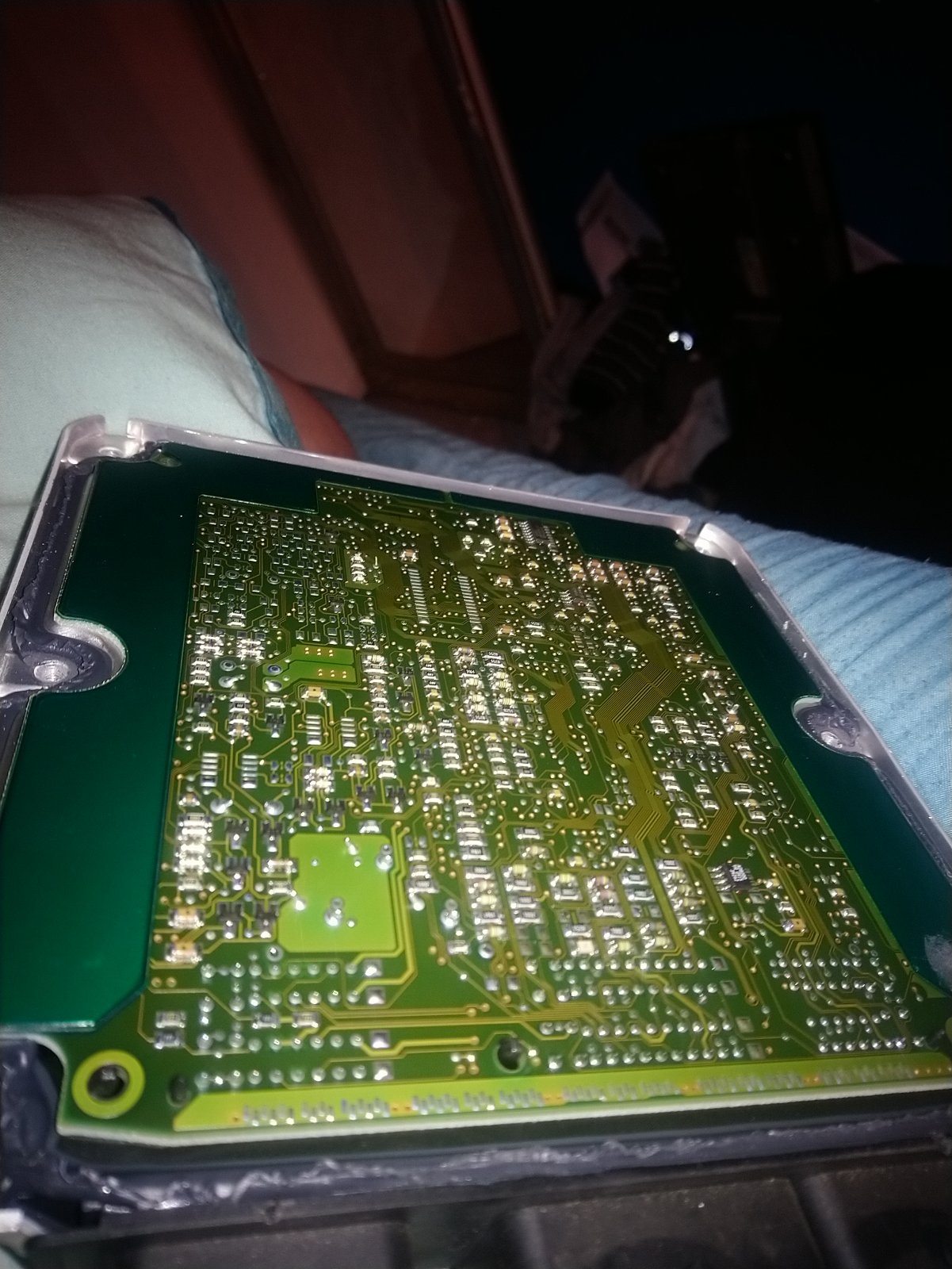

Thanks James. I've got it open. And I don't have enough time to go through it lol. As in its very integrate.. Attached some pics one of each side of the ecu...
Couple of resisters there to check with meter lol.

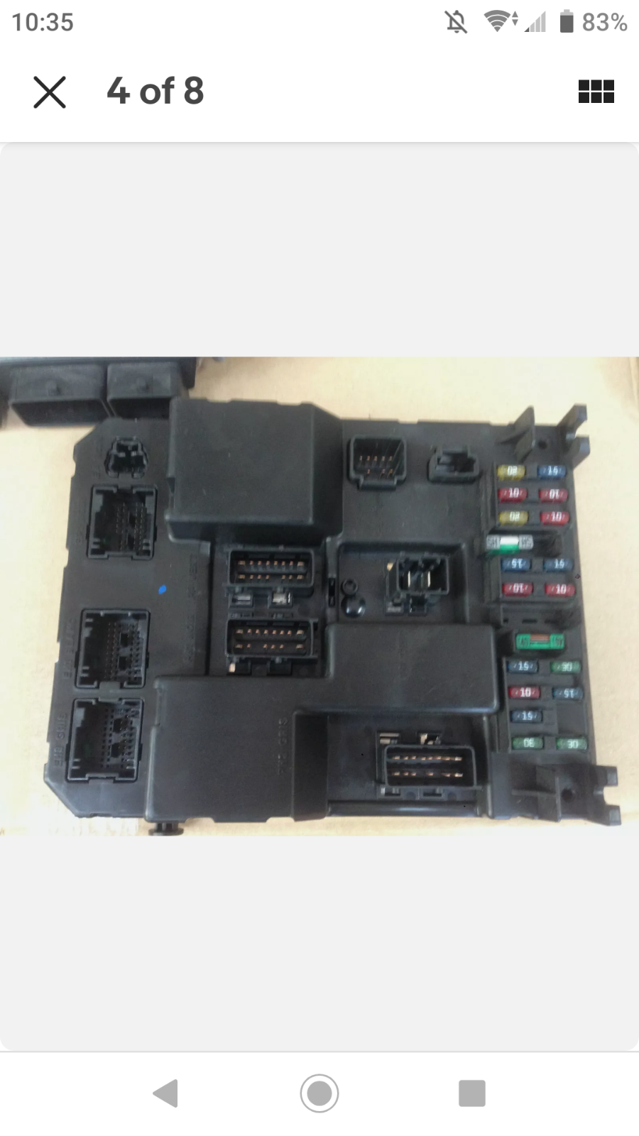

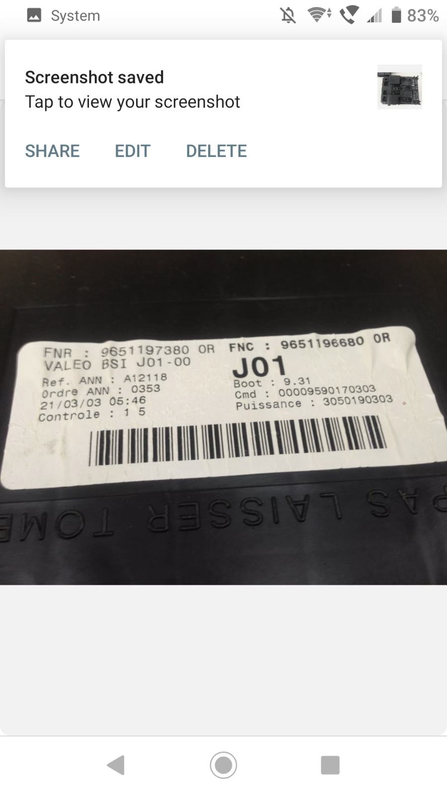

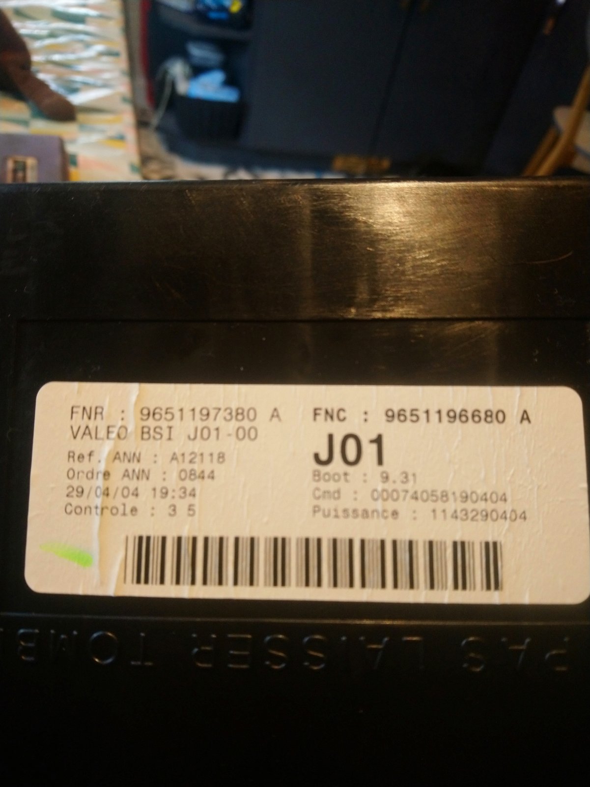

Question.. I've seen another ecu bsi set on ebay for 55 quid.. Now the bsi is identical to my original one which cooling fan and cruise didn't work on.. But Im concerned over dates.. As attached. There's a year between them. Mines got 04 date on it the ebay one 03.. Do these dates matter as long as they are identical..?
Ebay one.. My original.. I put an, earlyer bsi in which is what I'm sure is causing the window issue.. And lack of auto wipers
