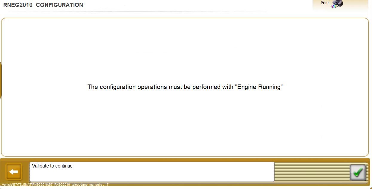

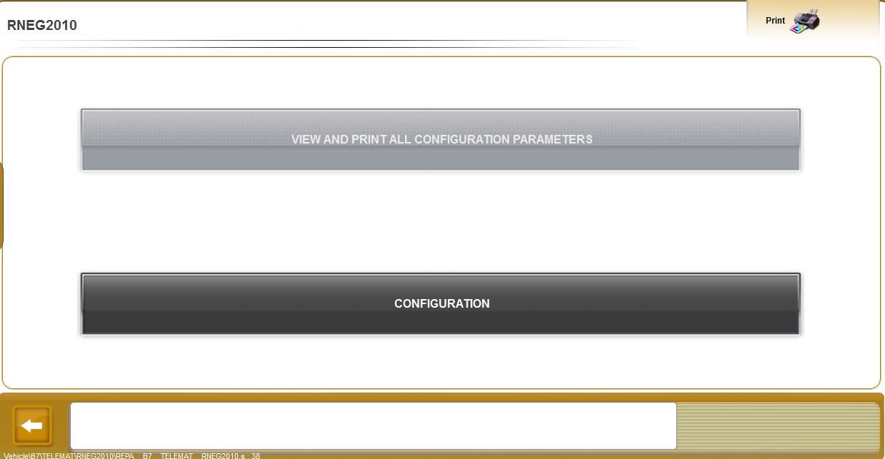

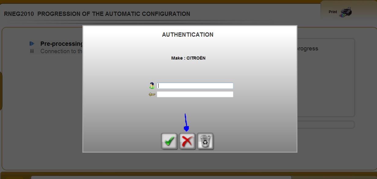

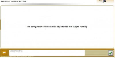

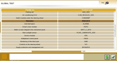

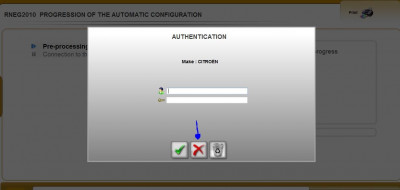

And make sure you have no active internet connection on your laptop (disconnect the wifi connection, but do not switch off or disable the wifi adapter by switching it off at the switch as Diagbox relies on the hardware being active. Also make sure you are using Manual Configuration!

Re: How to Replace the Internal MicroSD Card - RT6

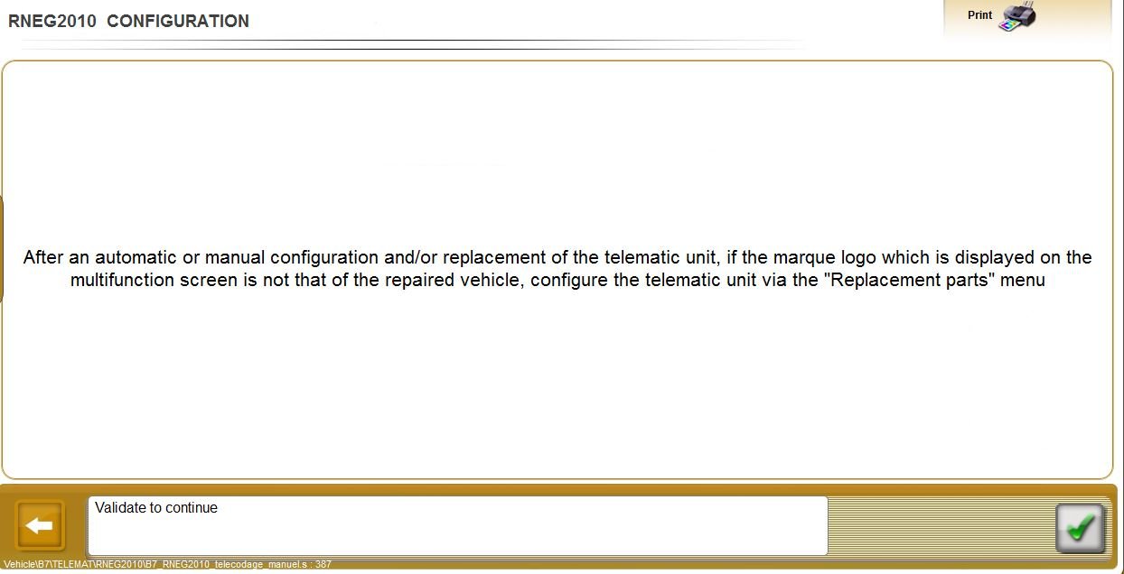

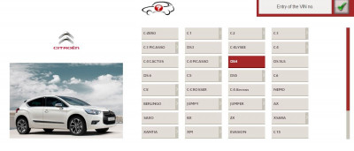

Ok, let's try something simple (!) find the "Selection of the marque logo for the welcome page" and see if you can change this to Citroen.
D0Z3R2K4
- Posts: 49
- Joined: 21 Dec 2019, 16:44
- x 9
the same failure - also tried it the way it said too

I'm sending a PM too....
D0Z3R2K4
- Posts: 49
- x 9
in the process of your request - im quite far from the house so the connections not great but we do have one

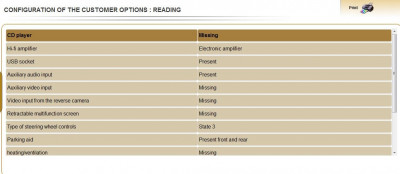

Just wanted to say a massive thanks for this. I know it was some time ago that you were helping me with this, but i have just got round to replacing the SD card, and loading the firmware, using the dealer CD.GiveMeABreak wrote: 03 Jan 2020, 14:01 Because you supplied me with the software version and that is for an RT6 unit Andy. I didn't need your VIN to check because of this, and also the other difference between the MyWay and eMyWay (RT6) is the the RT6 units do not have an SD card slot on the front of the unit. I know you have a DS5 and that wasn't fitted with the MyWay.
I have now run into the issue of the calibration being off, and wondered whether you consider it worth me buying the diagbox equipment.
When you say calibration do you mean you now have a significant echo when speaking on your phone using the car's Bluetooth? If so, then that is something that can be fixed by getting the dealer to download a calibration file from the PSA servers. It can also be fixed by using a program called Mirascripts but this isn't supported here.
Hi Andy - that was a while ago and I had to scan back through the posts!stagwood wrote: 18 Jul 2020, 16:35Just wanted to say a massive thanks for this. I know it was some time ago that you were helping me with this, but i have just got round to replacing the SD card, and loading the firmware, using the dealer CD.GiveMeABreak wrote: 03 Jan 2020, 14:01 Because you supplied me with the software version and that is for an RT6 unit Andy. I didn't need your VIN to check because of this, and also the other difference between the MyWay and eMyWay (RT6) is the the RT6 units do not have an SD card slot on the front of the unit. I know you have a DS5 and that wasn't fitted with the MyWay.
I have read through the rest of this post, and believe i would be able to carry out the task myself, if guided by you.
Thanks again for all your help, and the guides on this forum for all required procedures
Now, here's the thing... If it is the Bluetooth calibration that is off, then Diagbox won't be able to fix it - it needs a dealer file downloading and applying.
If it's the issue where the settings have have gone back to defaults and you have lost parking sensor info and options are missing, then Diagbox probably won't be able to fix this as generally the RT6 ECU goes into a locked down mode that needs the dealer to download and restore the settings from their servers. So I wouldn't want to encourage you to invest in a Lexia (although they are very useful for diagnostics) just for this purpose, as others have testified that they are unable to change the parameters.
It may be worth biting the bullet on this occasion and asking the dealer to book you in to download the bluetooth calibration file for your RT6 and also to configure the RT6 from their servers using your VIN so it has all the correct options on. Just tell them you have updated the firmware and it has gone back to defaults.

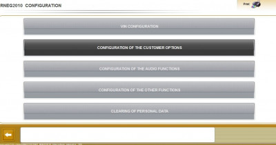

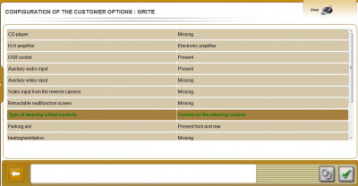

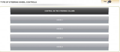

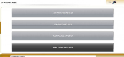

- x 6945

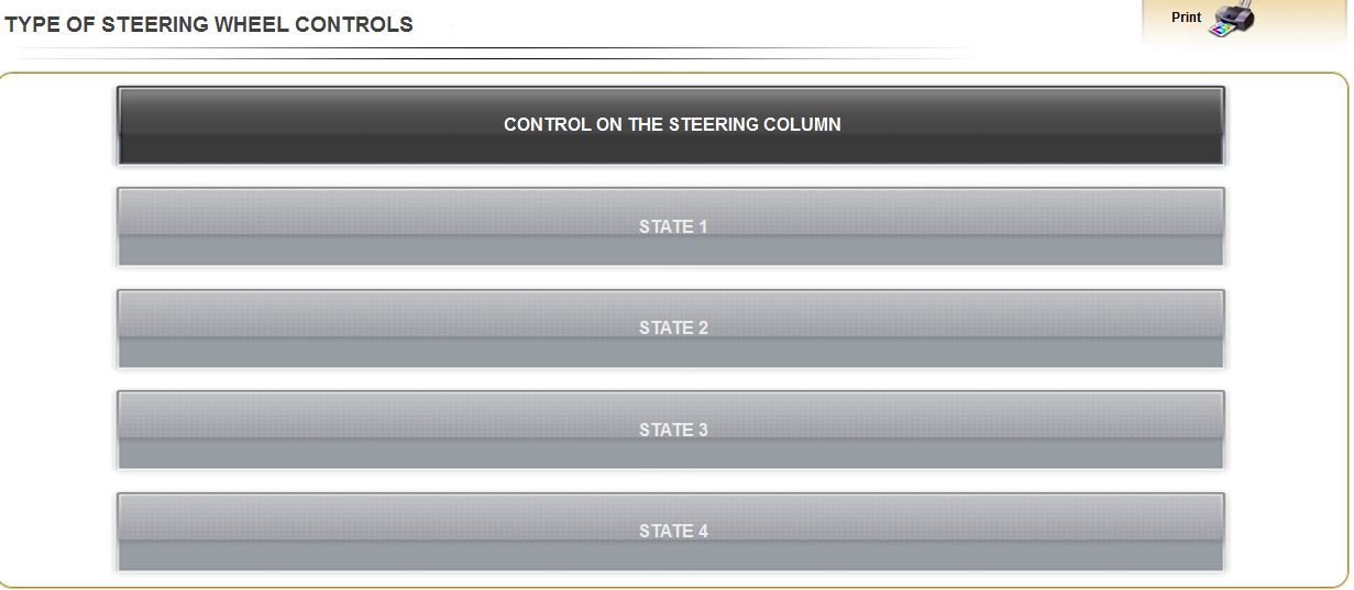

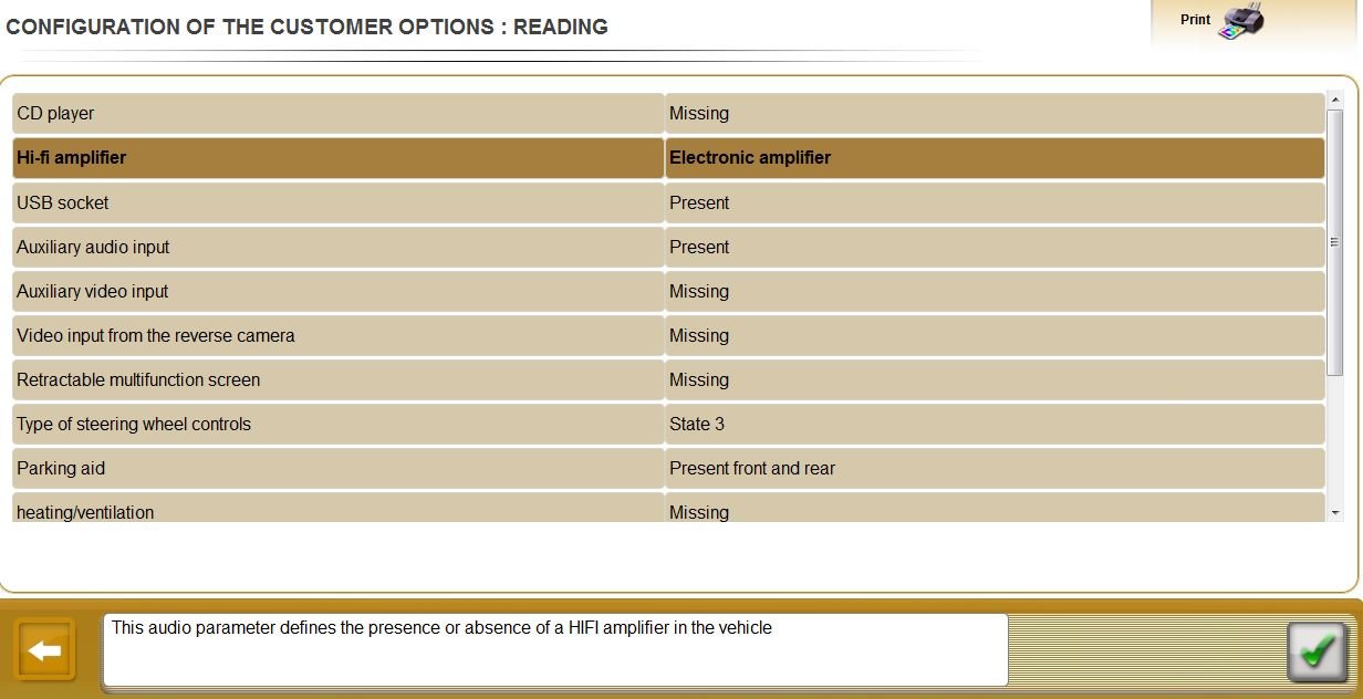

There is no configuration for the 'Buttons', only the options fitted to the vehicle (parking assistance, Amplifier, Matrix Display etc., ) so I can't help you with that. It is a well known issue that 2.86 is a major firmware update. Major firmware updates like this tend to reset the settings to defaults and generally require a dealer connection to PSA servers to unlock and configure. I appreciate you have Mira scripts to try and resolve this, but I can't help you with that - but I can tell you there is no configuration in Diagbox for RT6 configuration specifically for buttons.
