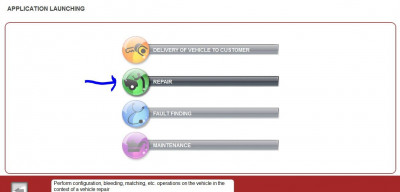

Ok, let's try something simple (!) find the "Selection of the marque logo for the welcome page" and see if you can change this to Citroen.
Re: How to Replace the Internal MicroSD Card - RT6
the same failure - also tried it the way it said too

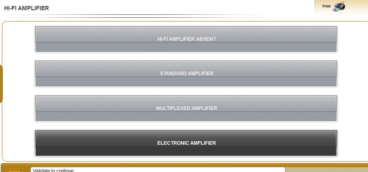

There is no configuration for the 'Buttons', only the options fitted to the vehicle (parking assistance, Amplifier, Matrix Display etc., ) so I can't help you with that. It is a well known issue that 2.86 is a major firmware update. Major firmware updates like this tend to reset the settings to defaults and generally require a dealer connection to PSA servers to unlock and configure. I appreciate you have Mira scripts to try and resolve this, but I can't help you with that - but I can tell you there is no configuration in Diagbox for RT6 configuration specifically for buttons.
