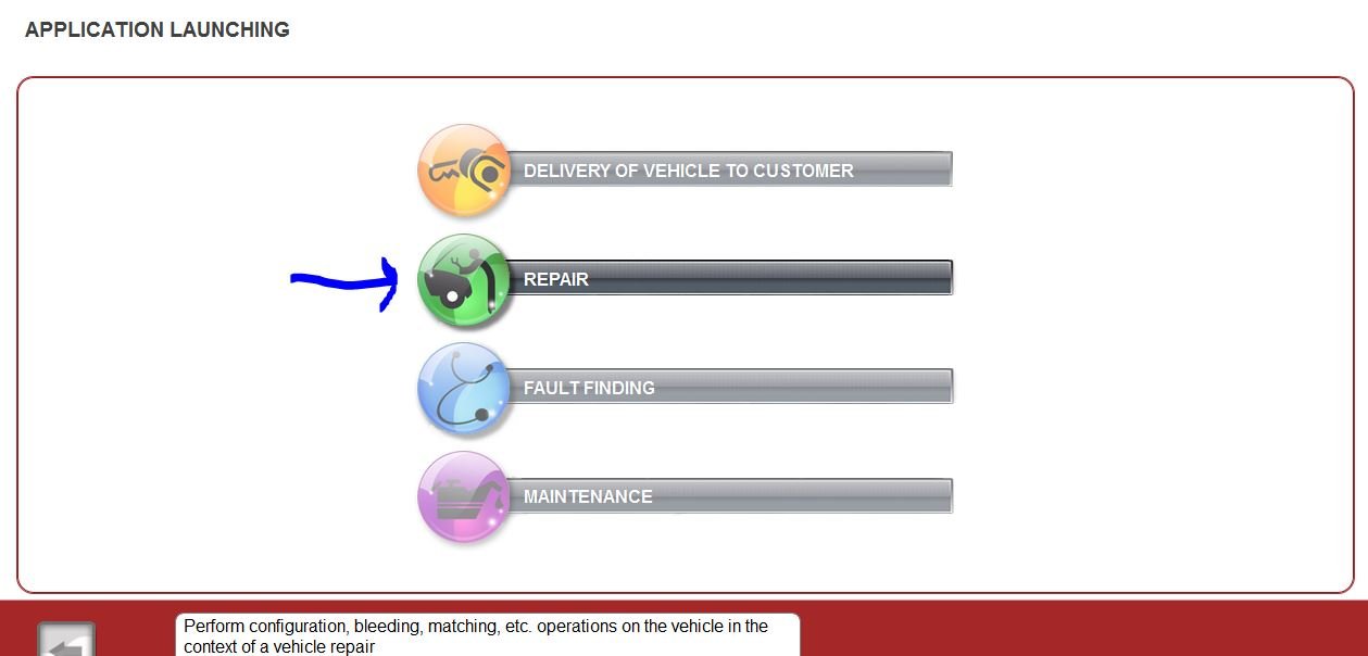

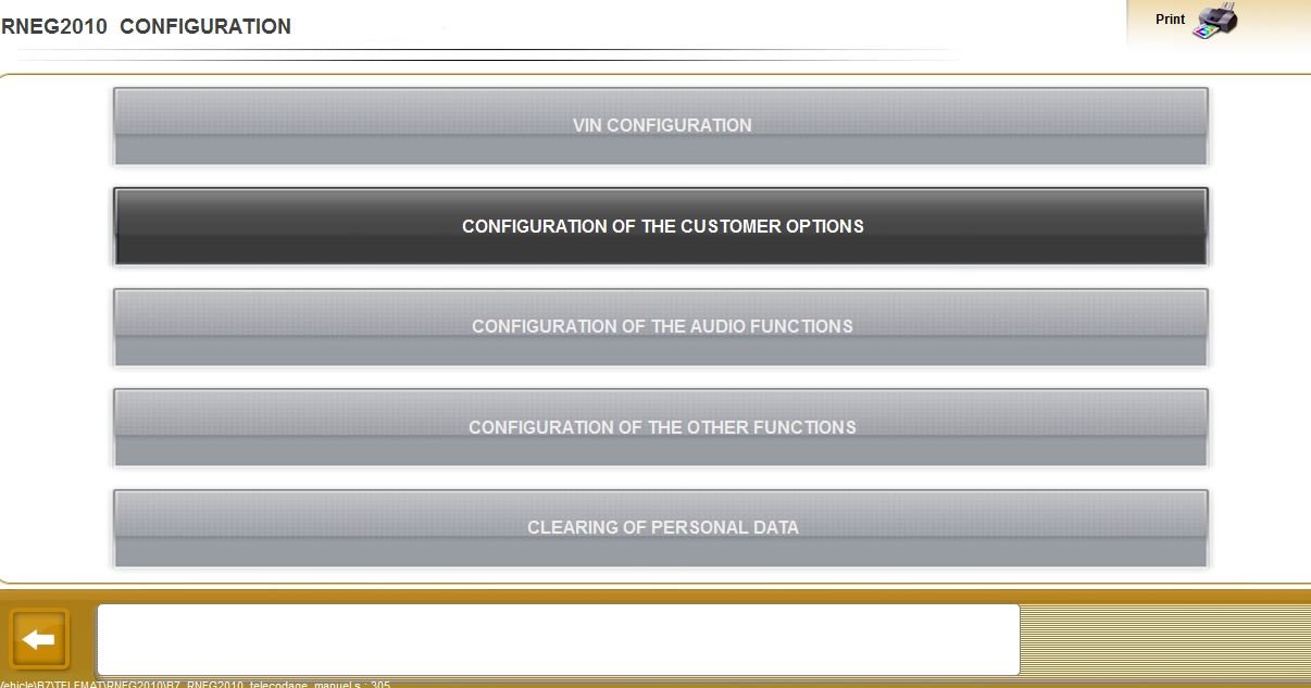

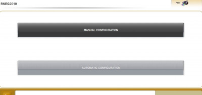

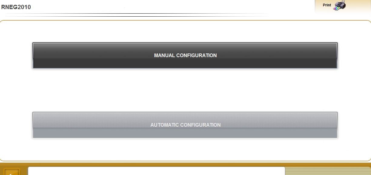

And make sure you have no active internet connection on your laptop (disconnect the wifi connection, but do not switch off or disable the wifi adapter by switching it off at the switch as Diagbox relies on the hardware being active. Also make sure you are using Manual Configuration!

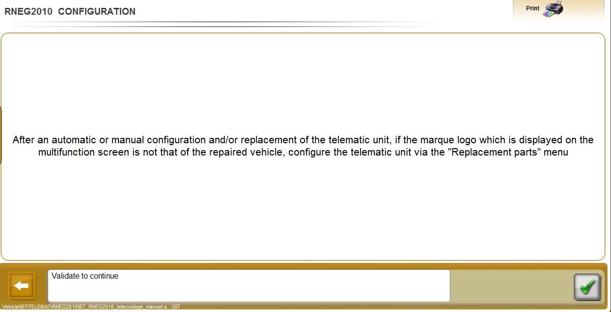

Ok, let's try something simple (!) find the "Selection of the marque logo for the welcome page" and see if you can change this to Citroen.

the same failure - also tried it the way it said too
