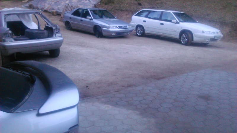

And here is my TCT Activa project. Sadly the engine caught fire... I believe that the petrol pipe split and gasoline poured over the hot engine. Before the fire it was really looked after and quite a few thousand euros was spent on it. New strut tops (original Citroen), hydractive valves, spheres, engine mounts, brakes, rear arm bearings, tyres (winter and summer) etc. I have the donor apart so now just need to fit everything needed. But it's hard to find time as it's quite a project...

I'm thinking of swapping the interiors of my TCT and V6 as the TCT has leather in really good condition and V6 has cloth and it's also in good condition. I will probably sell TCT and I will be lucky if I get a few hundred euros for it. What do you think about interior swap?
Anyone here wants to buy a burnt TCT Activa? 8-[ I add all the bits and pieces and also the engine that was rebuilt aprox. 15kkm ago...

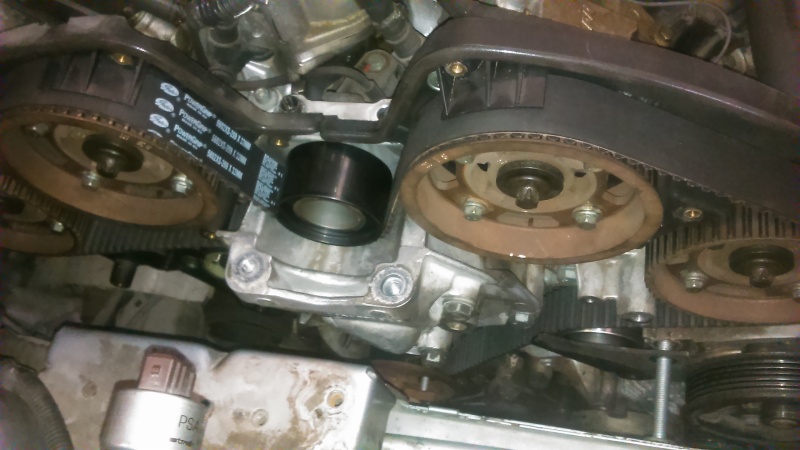

Would it be ok driving with no coolant (cold engine) for max. 2 minutes?
I am changing the cambelt on my Xantia V6 and I planed to change the radiator as well as it is leaking but I didn't get the right one :evil: Just checked the box and not its content and today shock! Right ident number but wrong contet!
So I wonder if I can drive of the ramp and park it outside the workshop with no coolant whatsoever in the engine. I would very like to avoid pushing the car... :roll:

BenC5HDi
Not Mike
Posts: 588
Joined: 30 Nov 2015, 20:21
x 45
Re: Xantos and Xantia madness
Unread post by BenC5HDi »
No. Push it out.
Sent from my SM-N9005 using Tapatalk
Posts: 55111
x 8406
BenC5HDi wrote:No. Push it out.
Very wise advice...
V6 head gaskets can go very quickly indeed with no coolant present. Just not worth the risk.

Cam belt changed and it's not a difficult at all job as someone might expect! :-D Just couldn't get the belt on while everything was attached, so I removed the whole tensioner assembly and positioned the belt and than bolted the tensioner assembly. It's one thing that puzzles me... Why are the cam shaft pulley bolts torqued with only 10Nm? I would expect that it would be more... Would there be a problem if the would be tightened FT (full torque of fu**** tight :) )
