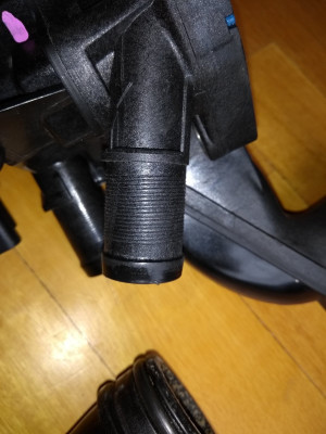

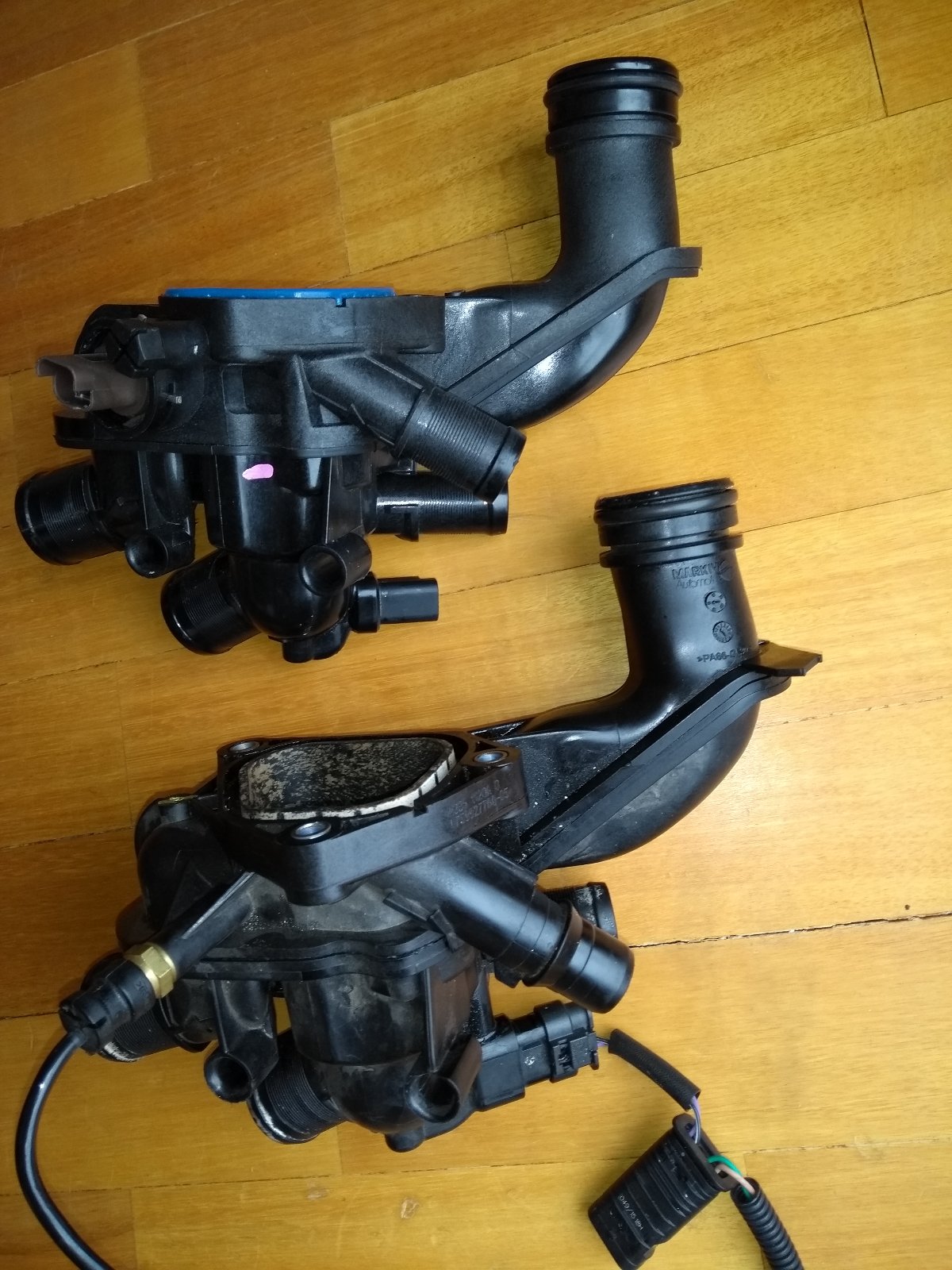

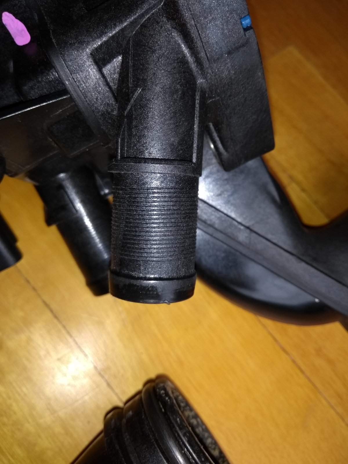

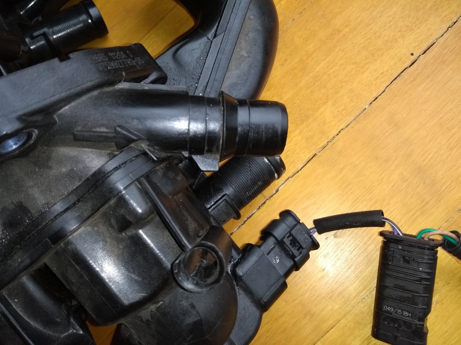

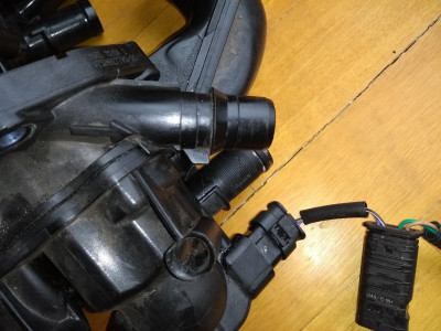

So I got a thermostat, then found I needed an adapter harness. Now when attempting to fit the thermostat, I have discovered that there is another version (P/N 1336 CC), which is of course the one that I require. This one seems to be a PSA-only part not used by BMW. The only significant difference is that the heater outlet connection takes a clip-on connector, not a hose clamp (it also has a different adapter harness, but the car already has one of those).
So now I need to refit the faulty thermostat and order yet another one.
1336 Z6 and  1336 CC (own work)
detail of 1336 CC heater hose connector (own work)
detail of 1336 Z6 heater hose connector (own work)
