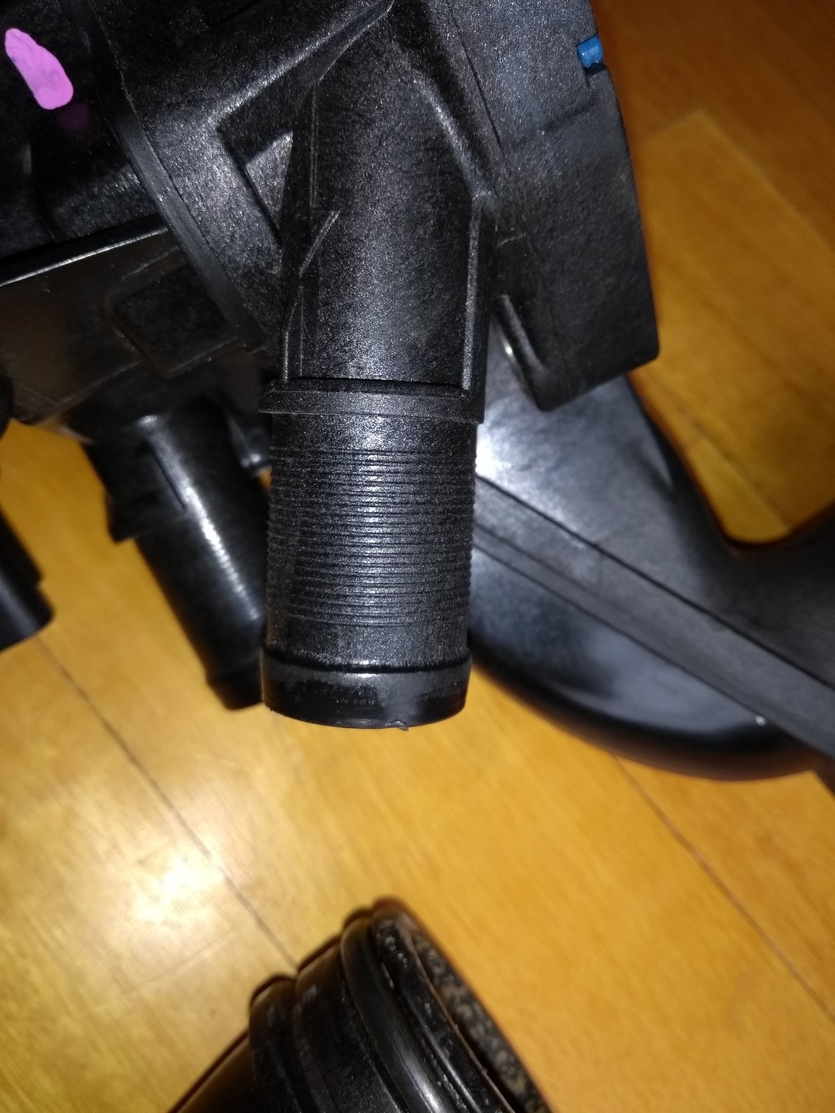

This just gets worse...
So I got a thermostat, then found I needed an adapter harness. Now when attempting to fit the thermostat, I have discovered that there is another version (P/N 1336 CC), which is of course the one that I require. This one seems to be a PSA-only part not used by BMW. The only significant difference is that the heater outlet connection takes a clip-on connector, not a hose clamp (it also has a different adapter harness, but the car already has one of those).
So now I need to refit the faulty thermostat and order yet another one.

I assume that the heater hose is too short to simply hack the clip connector off the end and attach it with a standard hose clip?

Re: Peugeot 308 CC Tribulations
I finally got the thermostat replaced with a part that fitted. Same old procedure, but the main temperature sensor and adapter harness need to be swapped to the new thermostat housing, as the housing does not come with a sensor fitted.
Both of the replacement thermostat housings had a heater resistance of 15.5 Ohms but the faulty one had a resistance of 5.5 Ohms.
