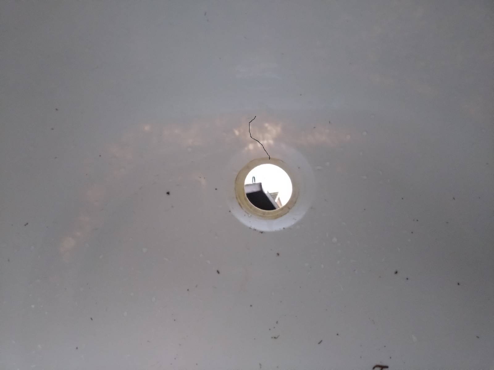

Thanks Richard but I think I was mistaken as it has remained bone dry since I looked last time. It is possible that I simply didn't dry it when I took the pipe off. I have today refitted the pipe to it with a new olive and fresh PTFE tape so I don't want to disturb that and hopefully it will be beyond my time before it will need looking at again!! The bath was installed in 2009 so the plumbing was fine and only the bath itself has failed. Not surprising when you see how thin it is, had I have been there when it was installed I would probably have rejected it because of that but I wasn't!!

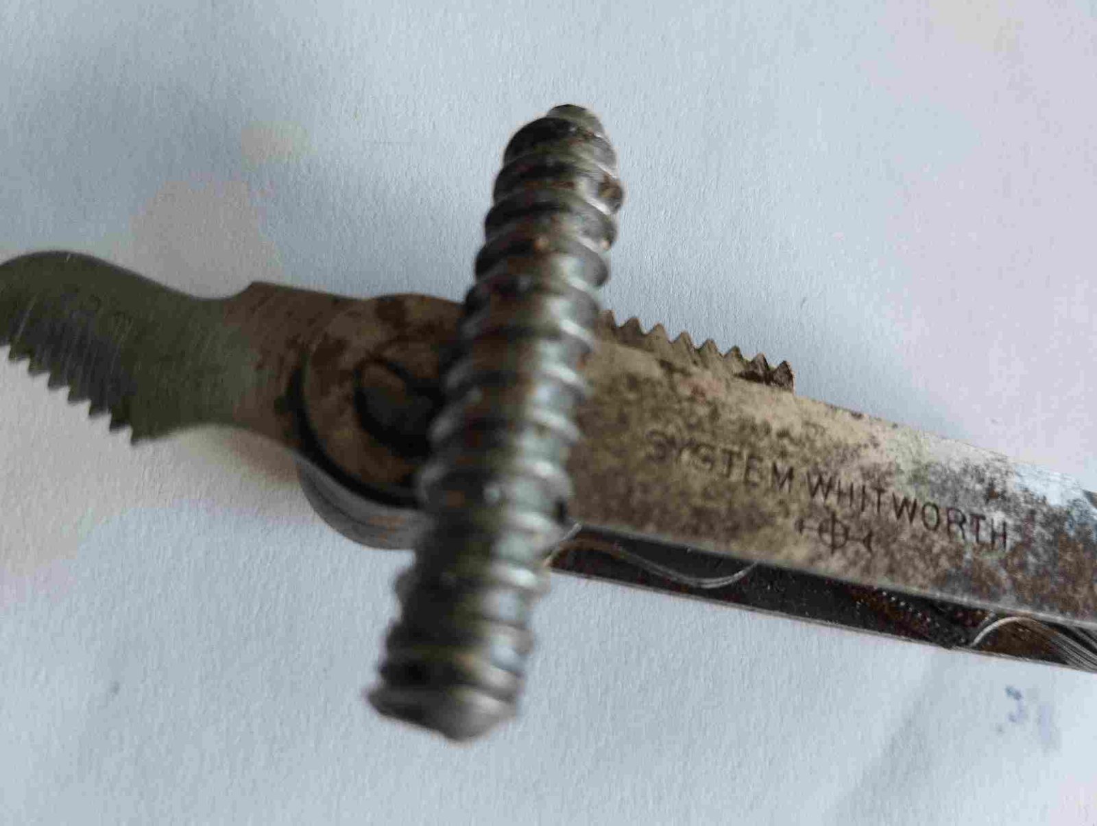

This summer we had 16 yo grandson & two mates staying for a week using our loft apartment.
Long after they'd gone we found that a screw-in wooden leg on one of the beds we brought here from the UK many years ago was broken. Yeah that's kids for you
On examination I discovered that the dual threaded screw had snapped leaving the wood screw part still in the leg & the bolt type end nowhere to be seen.
The remaining legs had what appeared to be 8mm bolt thread but 8mm threaded rod I had wouldn't fit.
Searching through my boxes of bits & bobs for a bolt I could weld onto the wood screw end resulted in nothing that would fit so out came my old dad's tool boxes I inherited.
The first useful thing I found was a thread gauge which showed me the thread should be 5/16 BSW so like looking for rocking horse poo trying to find that sort of thing in France.
Continued digging through old chap's boxes discovered a foot length of the exact size threaded bar I required. What's the odds on that??
I drilled the hole in the leg down a further couple of inches with an interference fit, screwed in the threaded bar 'till well tight & cut it off to length.
Result , a perfect job when reunited with bed which would not have been possible with the old chap's 'stuff'.
Cheers dad.

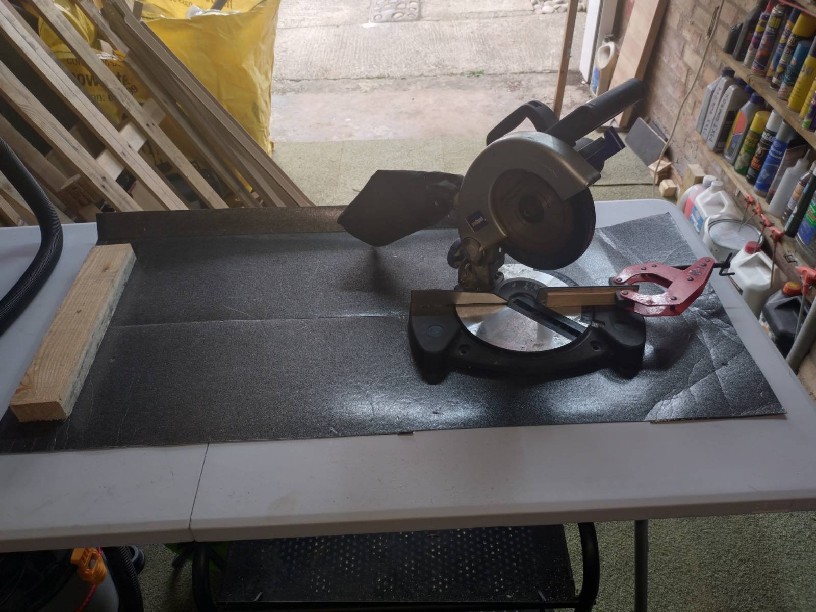

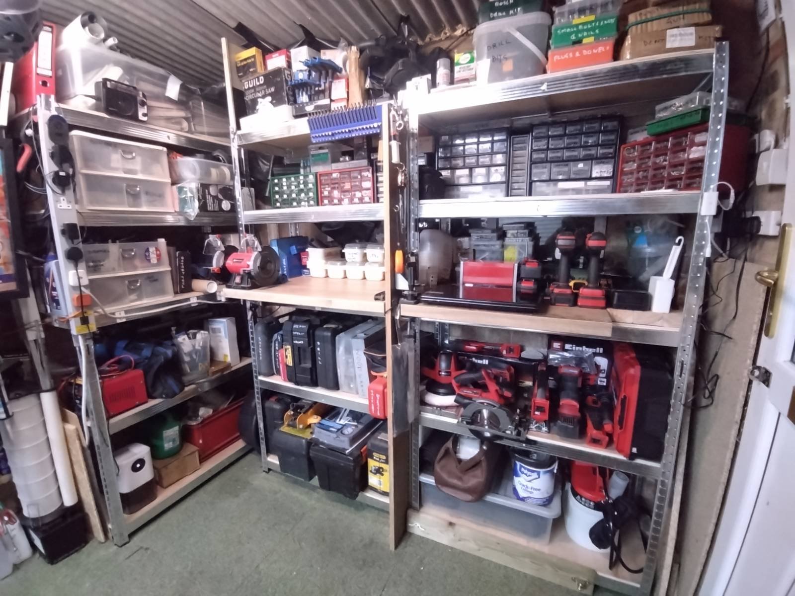

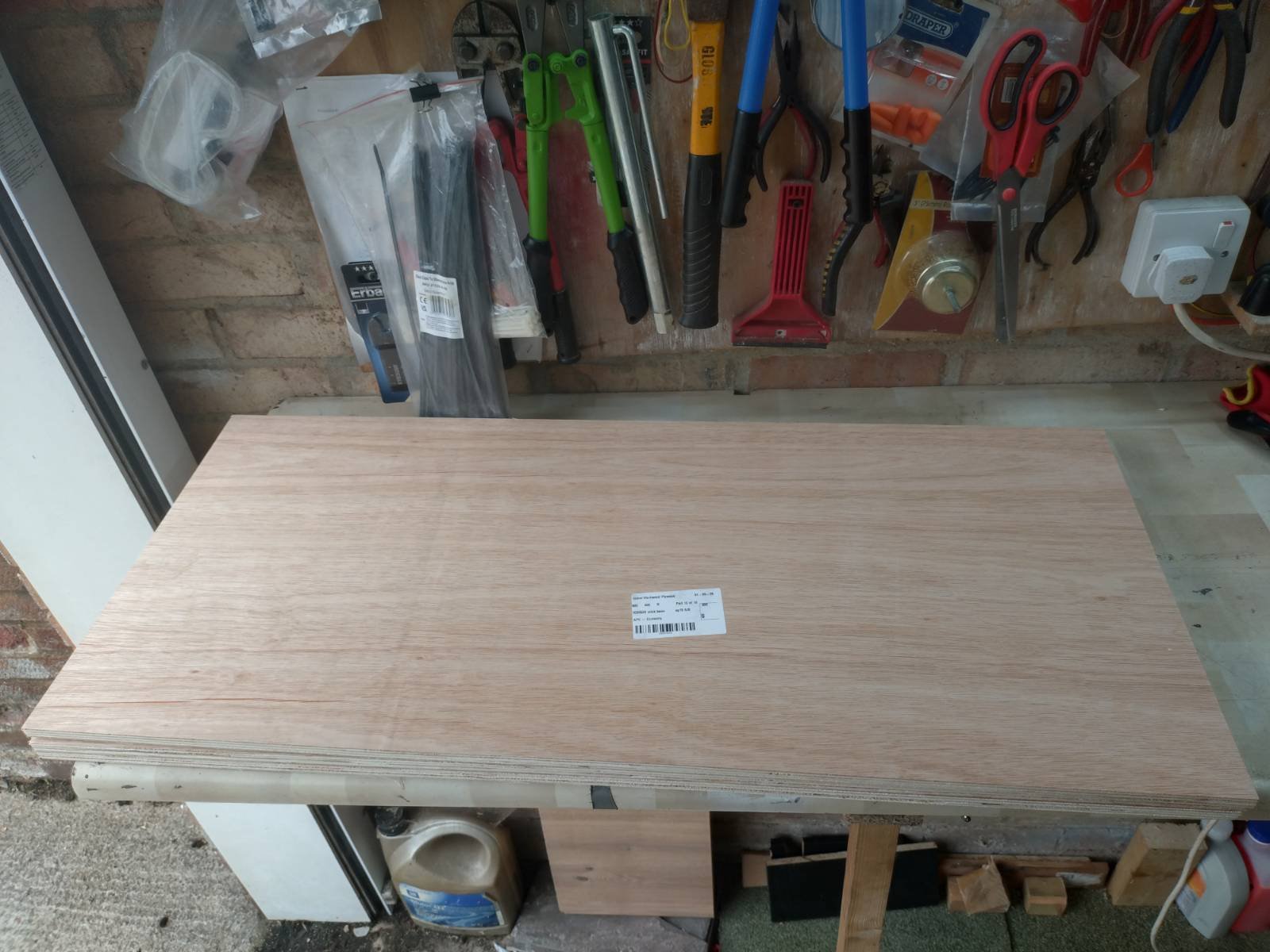

Exceptionally busy day with progress on the garage shelving upgrade and the bathroom has had a huge step forward. Sadly the delivery which should have been here on Wednesday, then Thursday finally partially arrived today. Only ten of the fifteen pieces I had ordered arrived, in two packs of five. The driver said the other pack must have got seperated and was I at home tomorrow? I've already stayed home for two fruitless days I told him and now another, I didn't let on that I'm fairly rooted here at the moment anyway!!
I'll leave it to the pictures to tell most of the story:
That leaves the two top shelves on those racks for the last two I have so far. Should be some more for the recycling centre as I sort those out!!

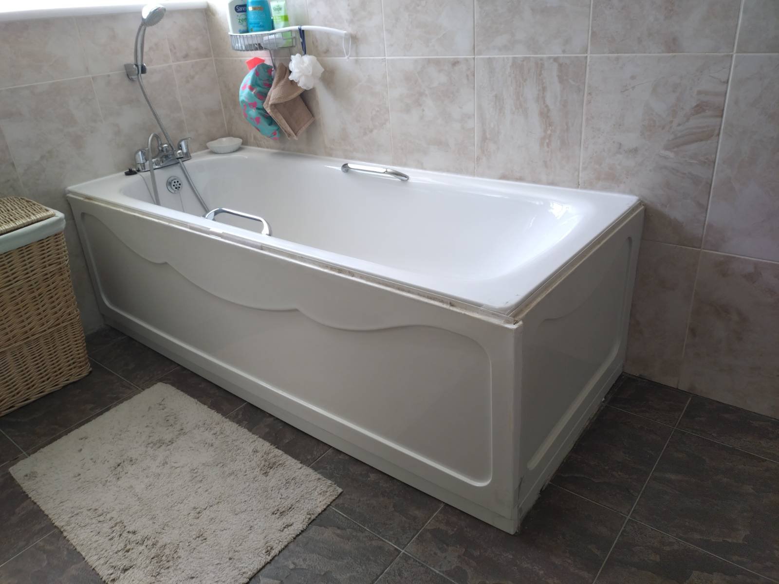

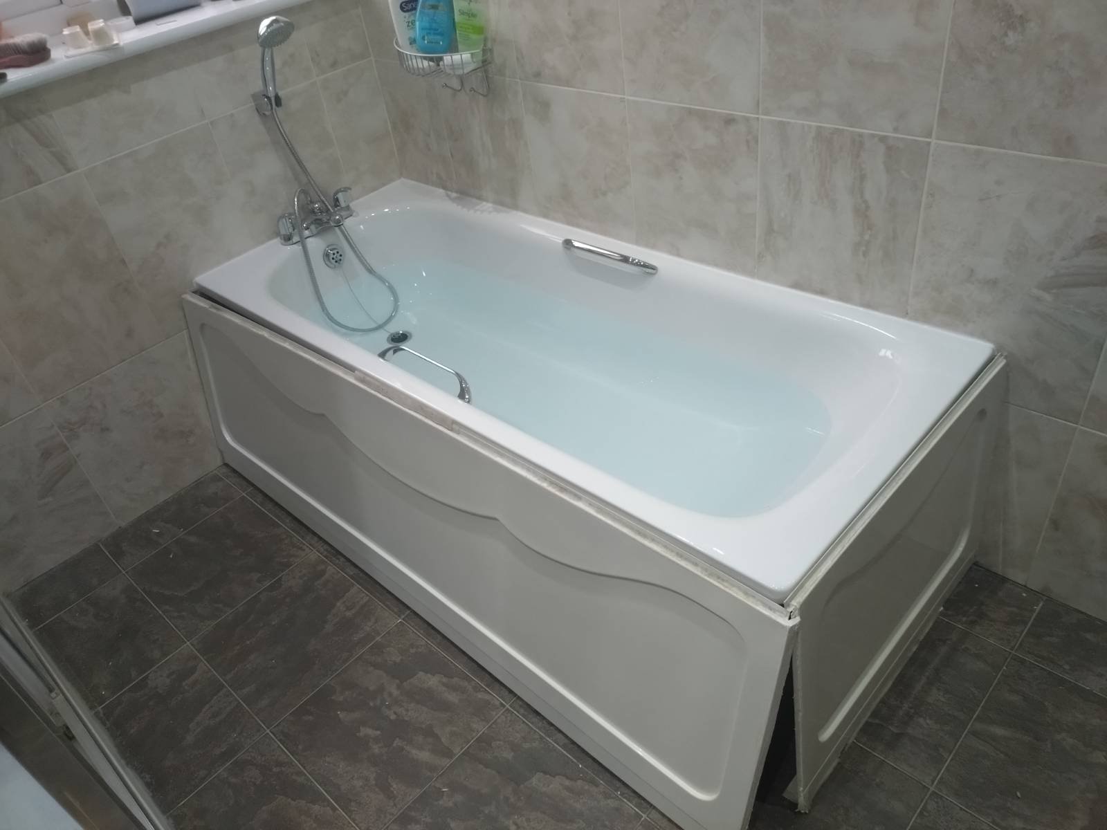

Finally I went to help my mate in the bathroom as he had been sorting the plumbing side of the bath install ready for me to do the water detector and the panels. I was too knackered today but at least we have a fully functional bath, at least it will be after 24 hours when the silicone is set:

Good to see the bath is all in and not leaking Mick
Negative feedback for the company that supplied the wood I guess. Are you shelving any further orders with them?

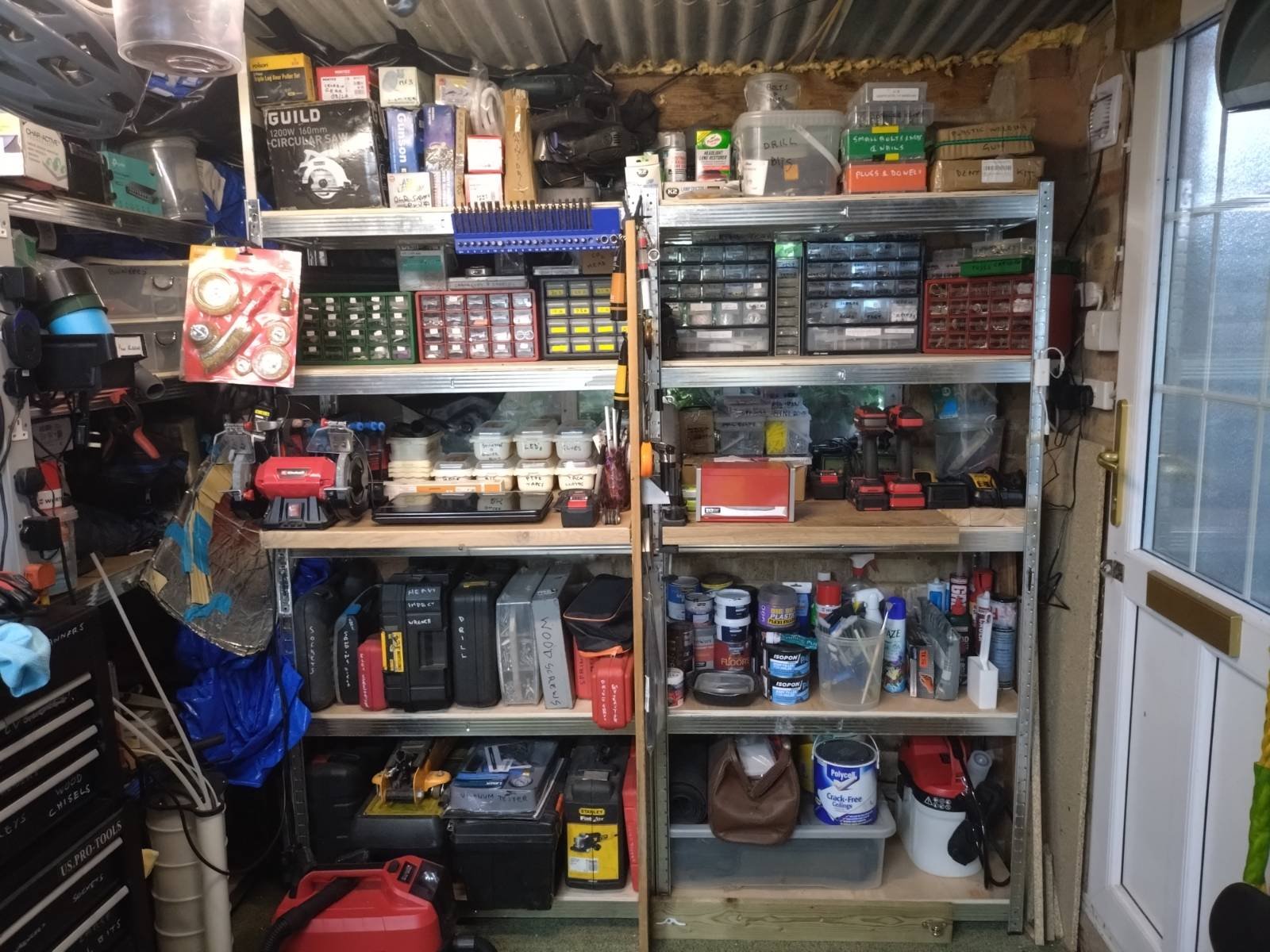

10 shelves done!!

How on earth do you find what you want amongst all that 'stuff'?
- Posts: 21214
- x 8124
Zoom in Vic and you'll see everything is labelled!
- Posts: 9379
- x 1938
That's distressingly organised!

Came in from the garage a bit too soon for the GP so took the chance to temporarily locate the bath panels. I don't want to fit them until my new leak detectors arrive so this will do for the time being. SWMBO used the bath yesterday and pronounced it better than the old one!! That'll do for me

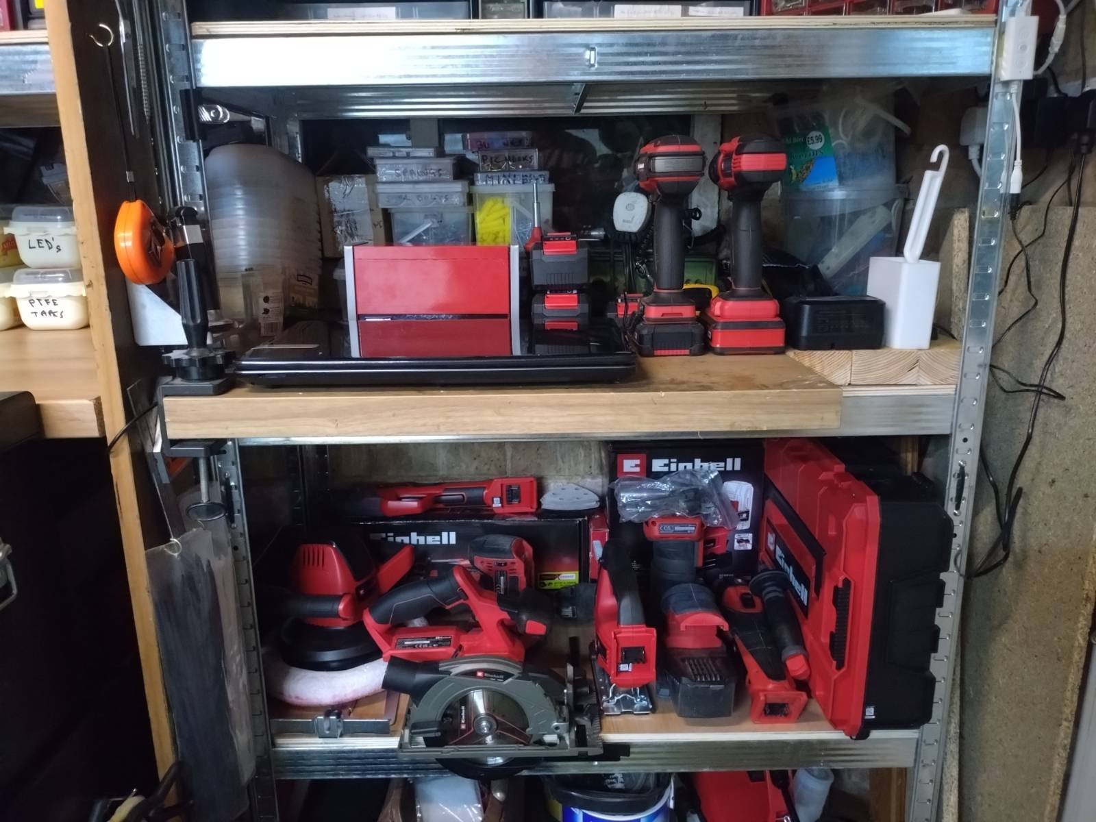

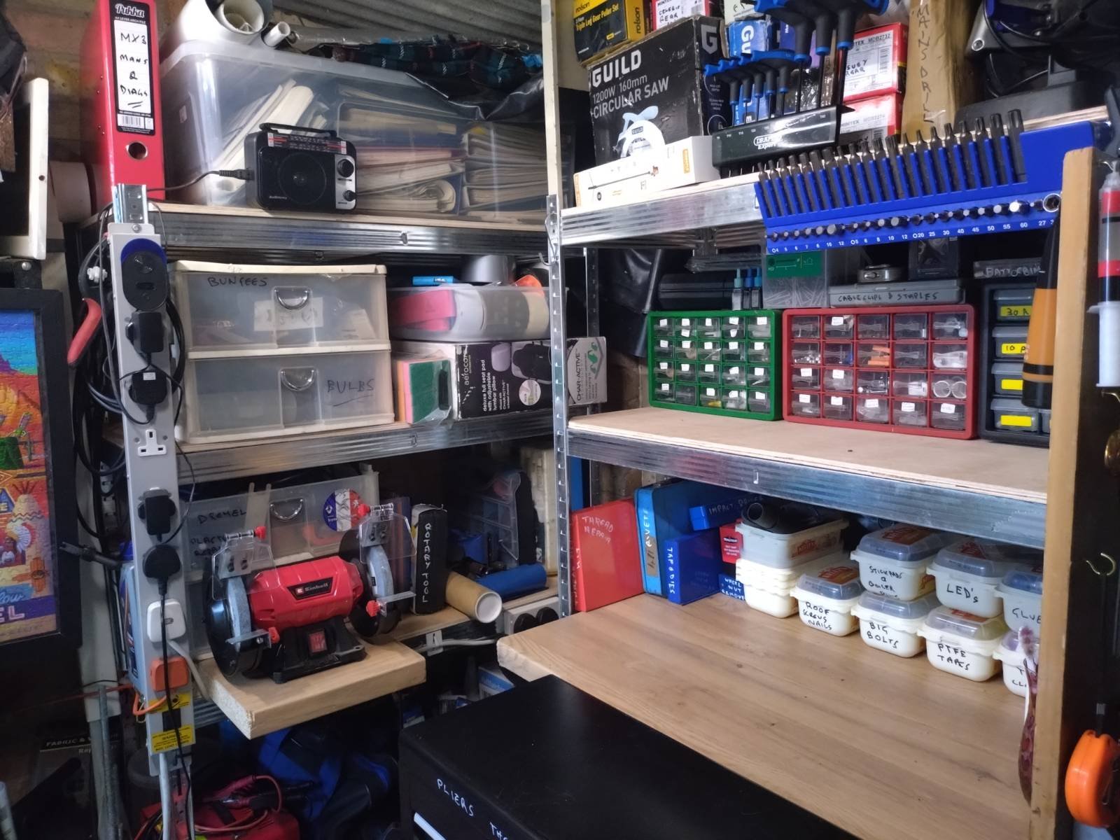

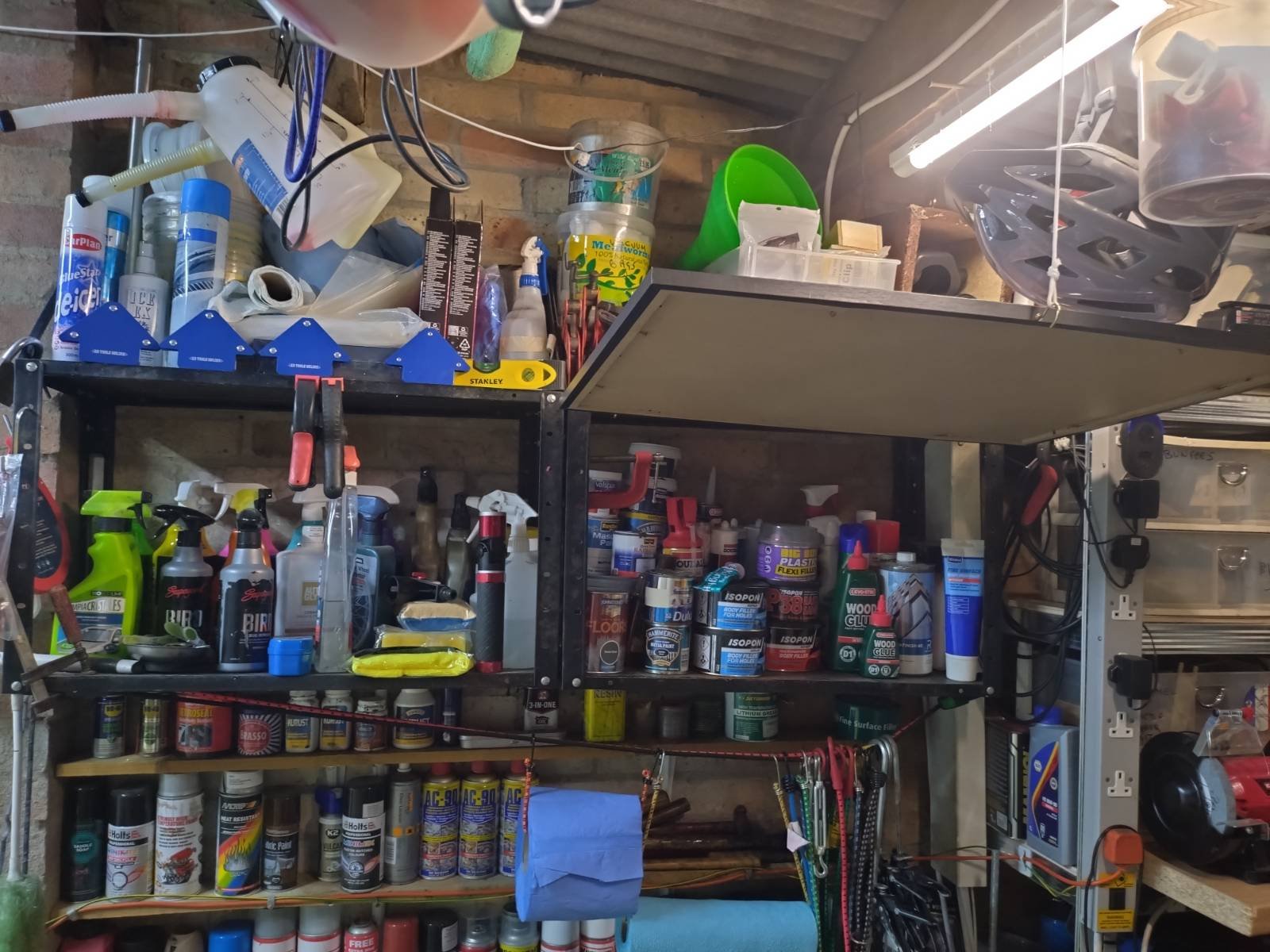

After today's Football I got back into the garage and finished the refit:
But then I remembered an extra idea I'd had to use up the offcut from the new worktop:
I used my Route 66 Jigsaw as a door to the new paint and filler shelf;
When I say door I guess I mean hatch:
As a result I moved my power tools to the old paint and filler section which fits better in the overall plan:
So apart from the inevitable trip to the recycling centre the work is complete and SWMBO can re-house her car on Tuesday evening as I cannot take the surplus tomorrow due to a hospital appointment slap in the middle of the day. Hence that will be Tuesday and she can put her baby back to sleep afterwards. Here endeth that particular job!

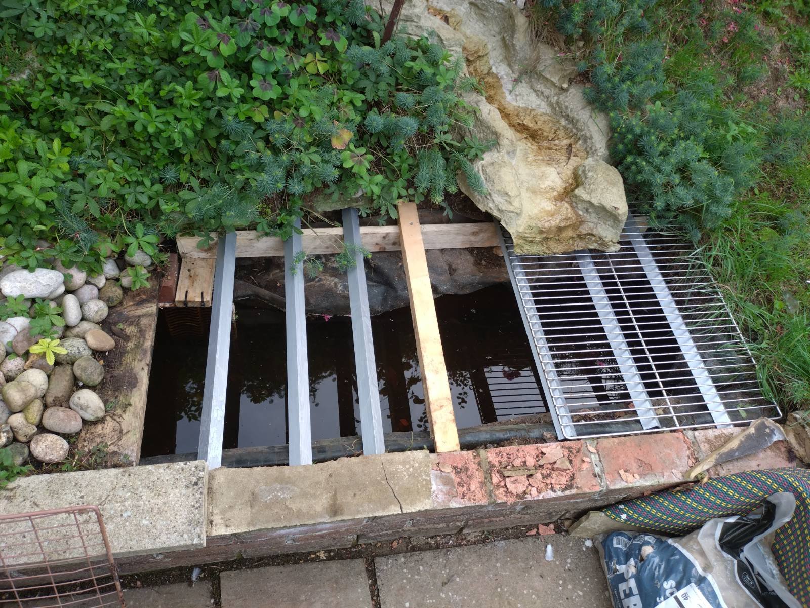

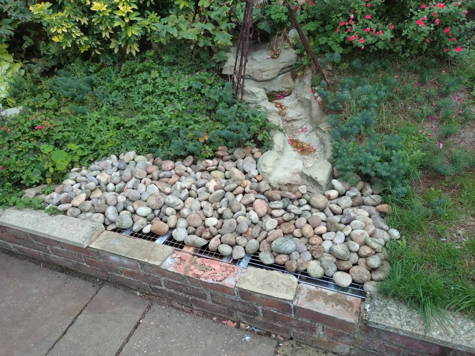

We have a waterfall in the garden which runs into a hidden sunken pond/reservoir. The pond has always been covered with cobbles, which initially was to avoid little children accidents, which rested on an old fireguard laid across the pond. Recently the guard has shown signs of collapsing by gradually sinking in the middle so I thought it was time I did something about it before the whole lot ended up in the pond.
So I stripped all the cobbles, took off two coping stones and removed the fireguard to be replaced with a similar one but with much better support. I decided on lateral 'beams' to support the guard and a BBQ grill I have, which will hold the cobbles, so I constructed a frame and ordered some aluminium angle to make the beams. I coated all the aluminium with paint designed for the job and then laid them across the pond:
I added the fireguard and then replaced all the cobbles to get it 'back to nature'.
All that is left is replacing the coping stones for a finished job. Just a matter of sorting out some mortar and laying them back but my health is holding me up at the moment so it will be done next week I expect!

Good work Mick
Here's hoping the health will very soon stop holding you back...
