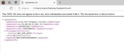

I opened the "UpdateInfo.xml" file in Edge (photo) and said "save as" it was saved with today's date.
The other files (license and SWL) I copied separately and have today's date
Will it be a problem?
To update the map, I only have to have it on the pen drive, or I need another file?

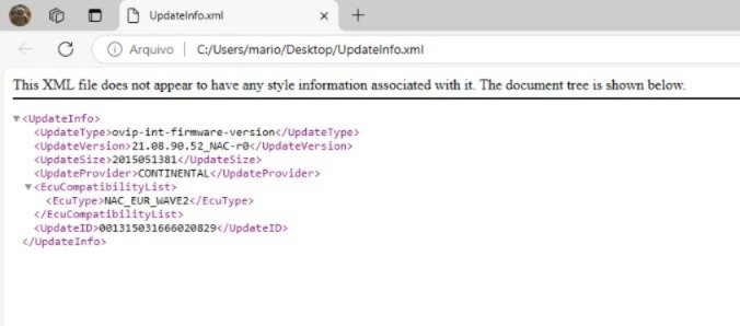

- x 6945
Re: PSA NAC RCC Updates
Maps don't need any other files (no licence files), just format the USB drive again and extract the map file to the USB and install. The extraction will create the required folder and files - but you MUST format the USB beforehand.
