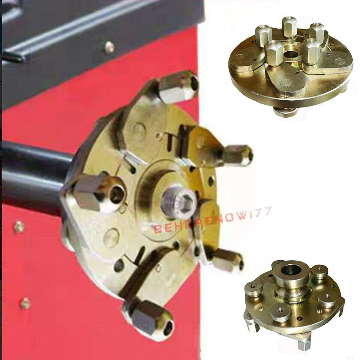

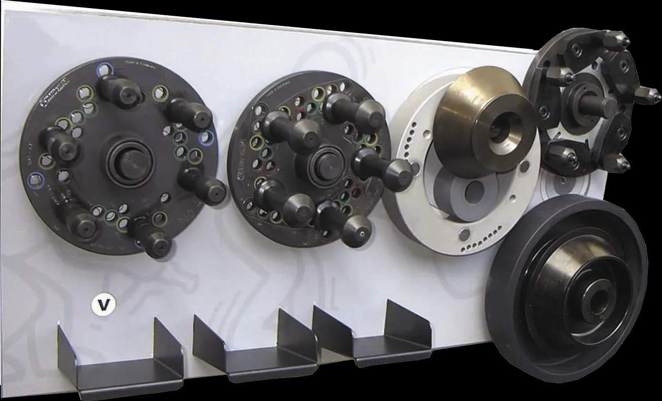

The attachments that adapt centreless wheels to go on standard wheel balancers are relatively common, but you do have to seek out a tyre place or garage that both has the kit and knows how to use it. Part of the problem is that the garage won't want the faff of taking off the shaft that's used with a standard cone and putting on the adapter, so they'll say they can't do it :(
This is the sort of adapter:

Centreless wheels were, apparently, fitted almost exclusively to Citroen and Peugeot vehicles, according to my local indy tyre fitter - who keeps a (now new and expensive) 3/4/5 stud centreless adaptor to hand.
The adaptor needs to be properly set for however-many studs, and then put on to the balancer machine shaft and itself spun up to "zero" it.
As bobins says, many fitting bays can't be bothered with this, or simply don't know.

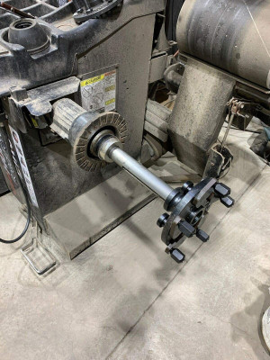

There are other centreless adapters out there - there's a version with a drilled out plate where you place the studs in the matching holes......

It still requires the shaft (for the standard cone adapter) to be removed from the balancer and this to be mounted, then the calibration process to be done, then the wheels balanced. Not a showstopping process in itself, but not the sort of thing your average tyre monkey wants to be doing on a Saturday morning.
I think more and more you'll only find the adapters being used in specialist PSA garages or by the enthusiast with their own wheel balancer at home.
