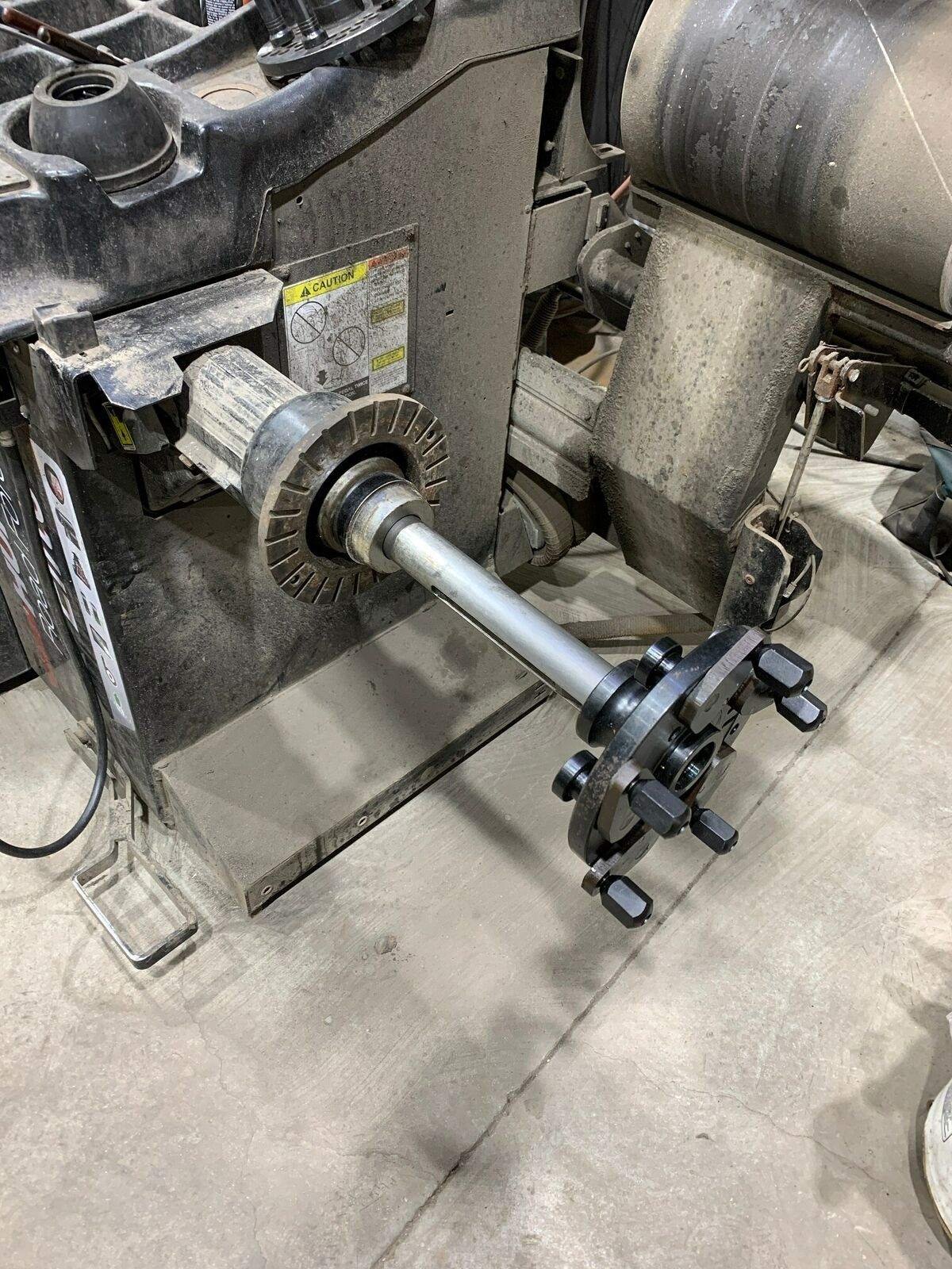

The attachments that adapt centreless wheels to go on standard wheel balancers are relatively common, but you do have to seek out a tyre place or garage that both has the kit and knows how to use it. Part of the problem is that the garage won't want the faff of taking off the shaft that's used with a standard cone and putting on the adapter, so they'll say they can't do it :(
This is the sort of adapter:

There are other centreless adapters out there - there's a version with a drilled out plate where you place the studs in the matching holes......
Centreless adpater 4
It still requires the shaft (for the standard cone adapter) to be removed from the balancer and this to be mounted, then the calibration process to be done, then the wheels balanced. Not a showstopping process in itself, but not the sort of thing your average tyre monkey wants to be doing on a Saturday morning.
I think more and more you'll only find the adapters being used in specialist PSA garages or by the enthusiast with their own wheel balancer at home.
