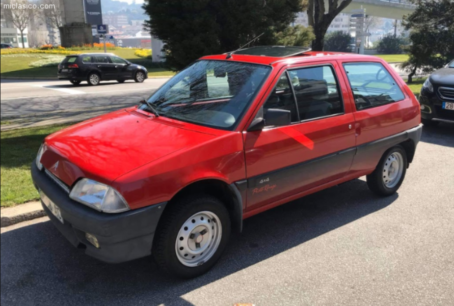

NewcastleFalcon wrote: 03 Jan 2021, 16:42 The aforementioned Citroen AX 4X4
Nice :) Well found Neil! That's a smart looker :cool:

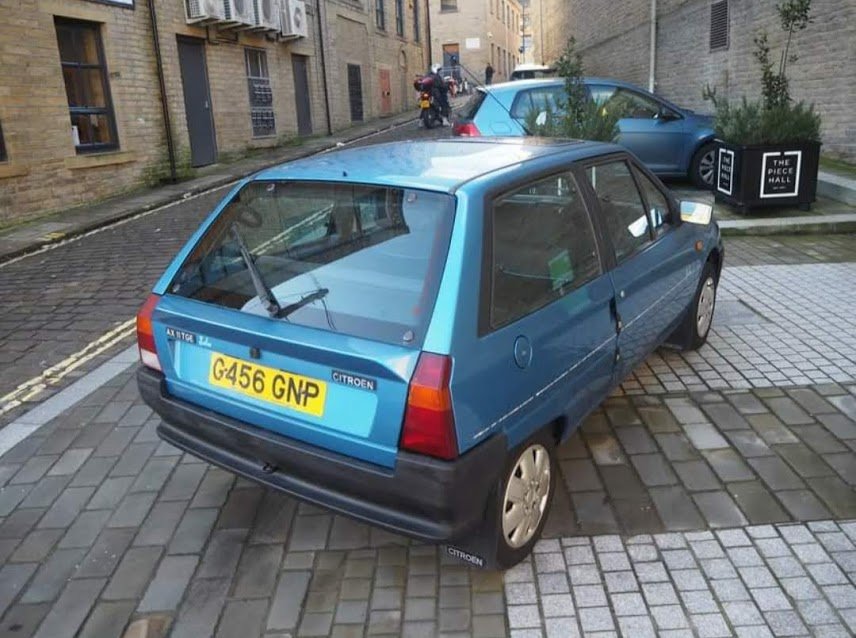

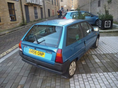

Today, looking around Facebook I found this AX for sale...
AX11TGE Salsa
AX11TGE Salsa
Absolutely and utterly identical to the one I had in the early to mid 90s :D Loved that car and it did us proud...
This one's on sale for £950.. Either a bargain or a moneypit...

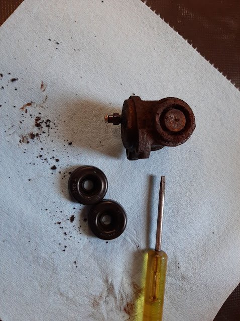

To confirm my diagnosis of the reason for Daffodil's non-operational rear brakes I removed one of the wheel cylinders today...
Seized absolutely solid :shock: Even a hammer and punch won't move the pistons!
They are allegedly only 4 years old :shock: Brake fluid replaced at the same time according to an invoice...
The brake fluid is very badly contaminated... As I flush more it's getting more and more purple and my suspicion grows that DOT5 was used to top-up and it's not done any good... It started off black and full of sediment, then brown and now distinctly purple!
New wheel cylinders are on their way and should arrive on Wednesday :) I've also procured another litre of DOT4 fluid to enable a thorough flush...
x 2941
Re: Citrojim's AX, Saxo, Pixo, Running and Cycling Tales
I use a grease nipple in the pipe hole and a side lever grease gun to shift those seized pistons.
