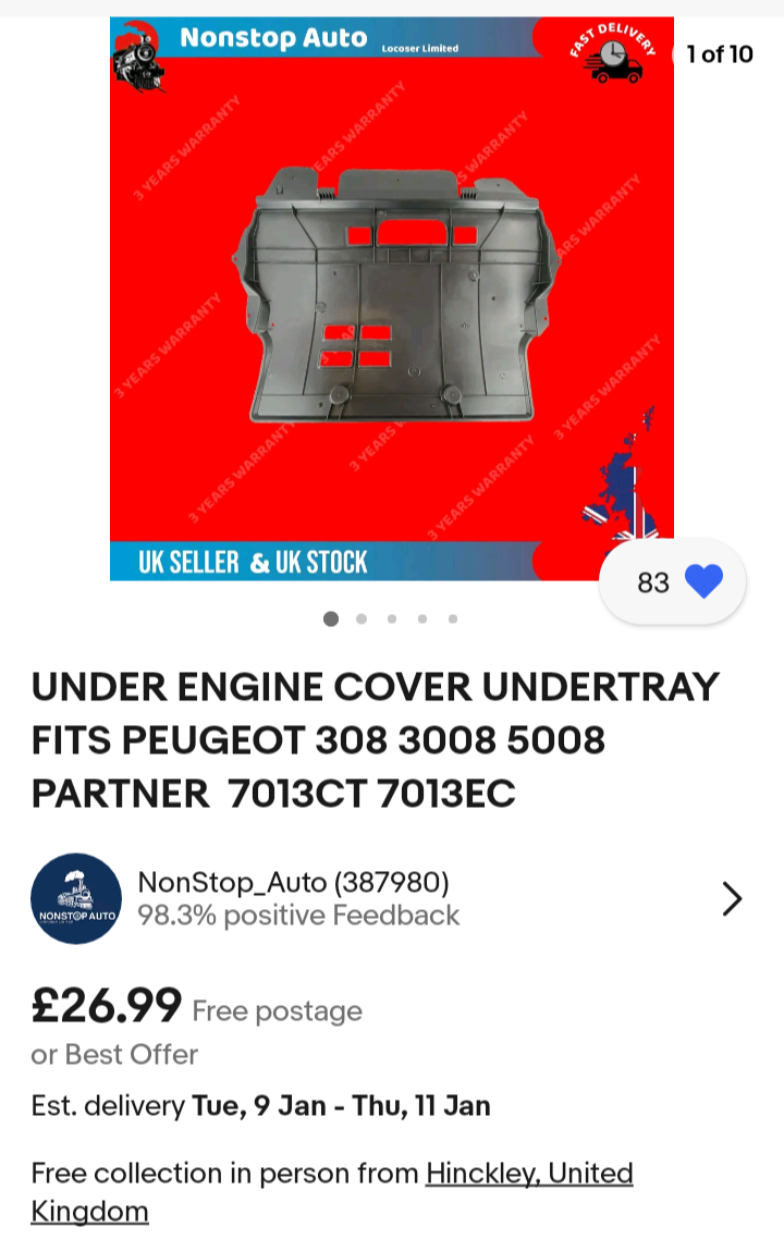

Strangely the undertrays when searching for 7013EC look much shorter than the Peugeot diagram Marc kindly supplied
eBay undertray
eBay undertray
But the price is much more palatable!!

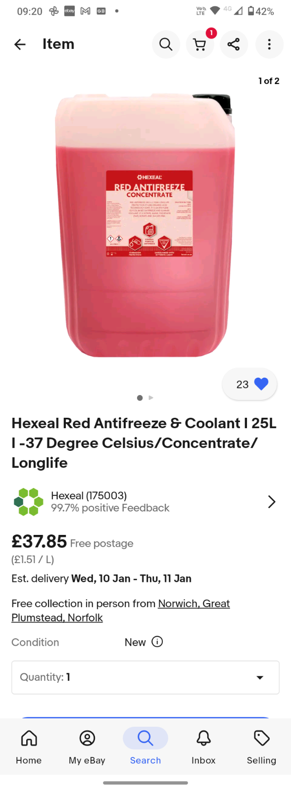

Coolant, am thinking a full change, flush then this:
eBay stuff
eBay stuff
Hexeal Red Antifreeze offers outstanding protection against corrosion, overheating and frost. Hexeal OAT is a 2 year Long Life Antifreeze with Organic Acid Technology corrosion protection. The exceptional thermlong-lifeity eliminates the risks of deposits particularly near the cylinder head, engine block, radiator, water pump and heat exchanger. Our Red Antifreeze is Nitrite, Amine, Phosphate (NAP free), Borate and Silicate free. It conforms to BS:6580 (2010), ASTM D3306, SAE J1034, ASTM D6210 , AFNOR NF R15601 (with the exception of reserve alkalinity).

Dont forget theres already part undertray there below the rad & intercooler, as for slide hammer on sump oops look at my new massive drain hole

MattBLancs wrote: 06 Jan 2024, 09:22 Coolant, am thinking a full change, flush then this:
Very much what ive used over the last 15 yr keeps everthing clean.

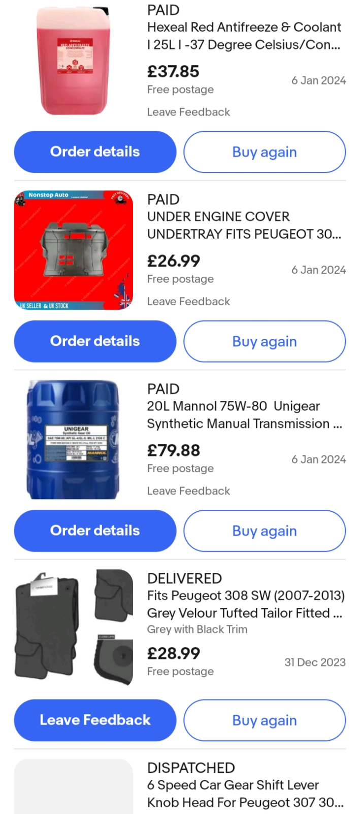

Buy it now occurred
Buy it now occurred
Stocked up on both gearbox oil and coolant
