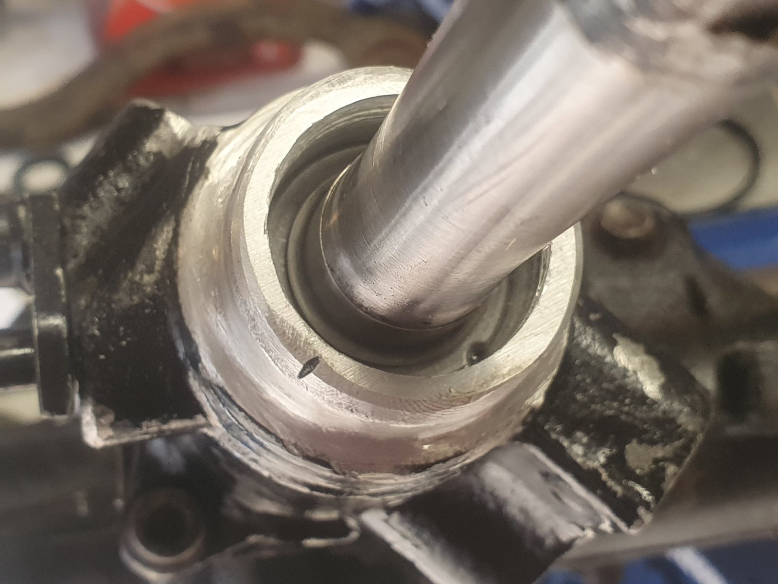

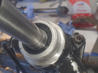

I can confirm that the number of turns lock to lock on both racks is the same. There must be something other on the steering that limits it to 3 turns. Both racks do 3 3/4

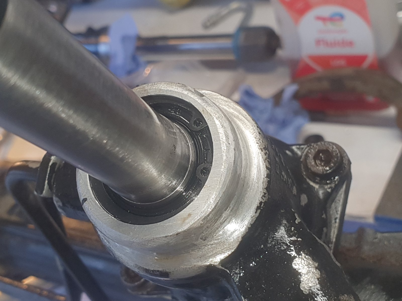

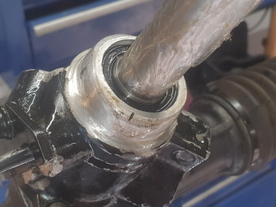

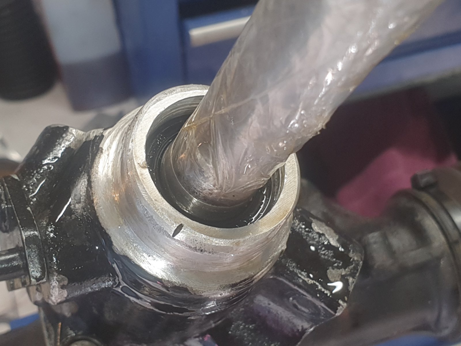

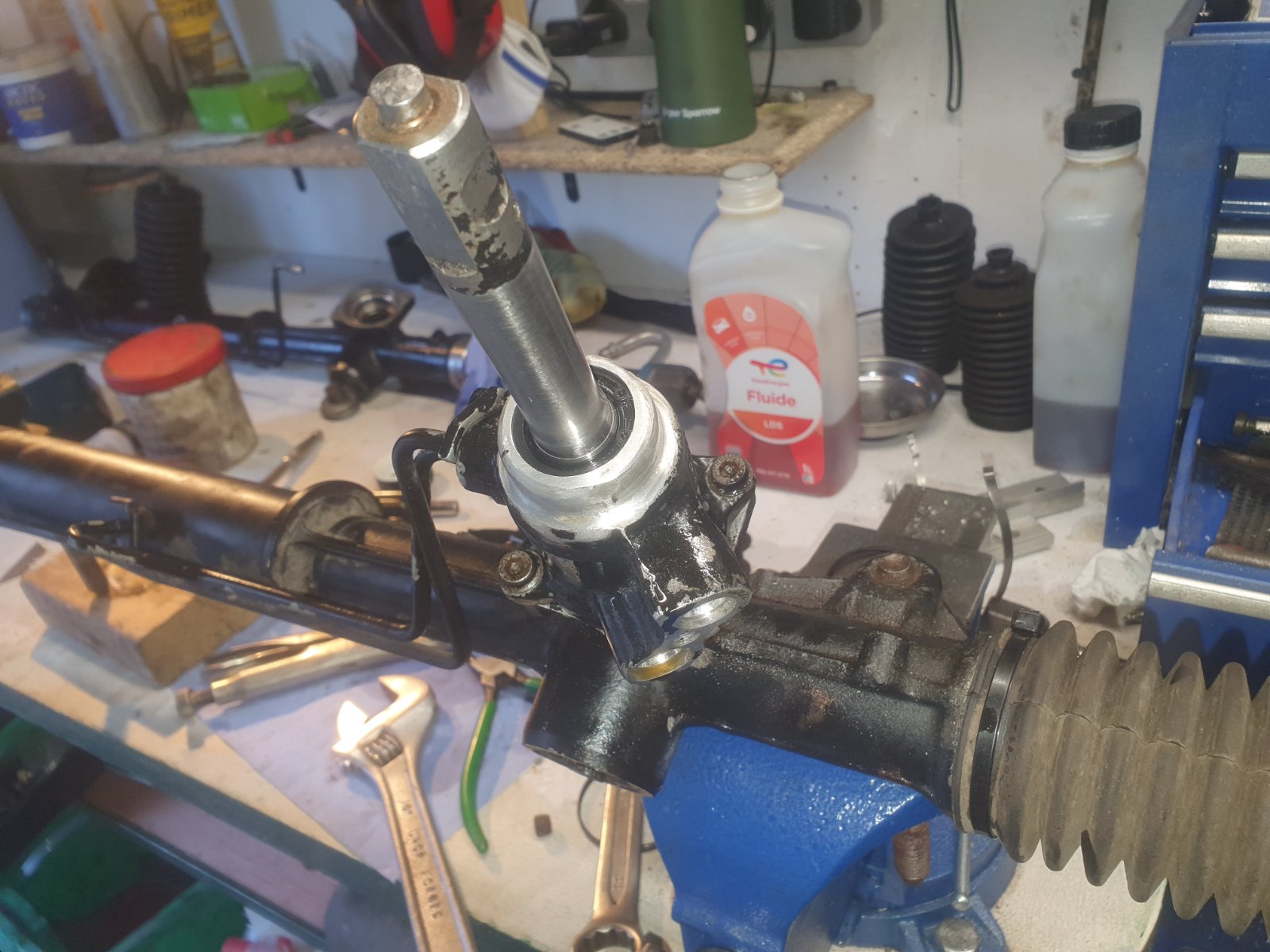

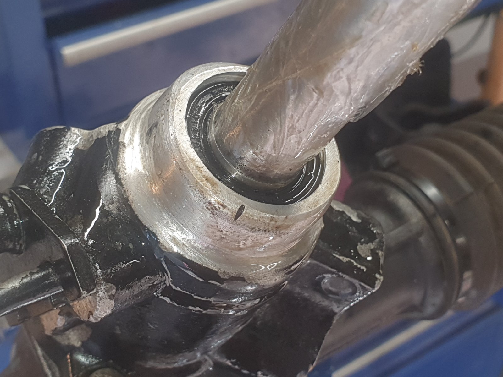

So I carried out the modification to the pinion valve housing off Stu's rack, and used the shaft too after confirming the no. teeth etc are the same. The one on the car was also visibly quite worn at the pinion.
I reused the rack body that was on the car because it had the long studs in it already and seemed smoother in operation. So basically made one good unit out the two.
Took the opportunity to fur new inner steering joints too
It's all back in an running for a couple of days, no leaks so far and tracked to almost zero.
See pics for modded shaft, sleeve, 2x seals and circlip going in.
I added an outer groove to help hold the fitting of a rubber boot not seen here.

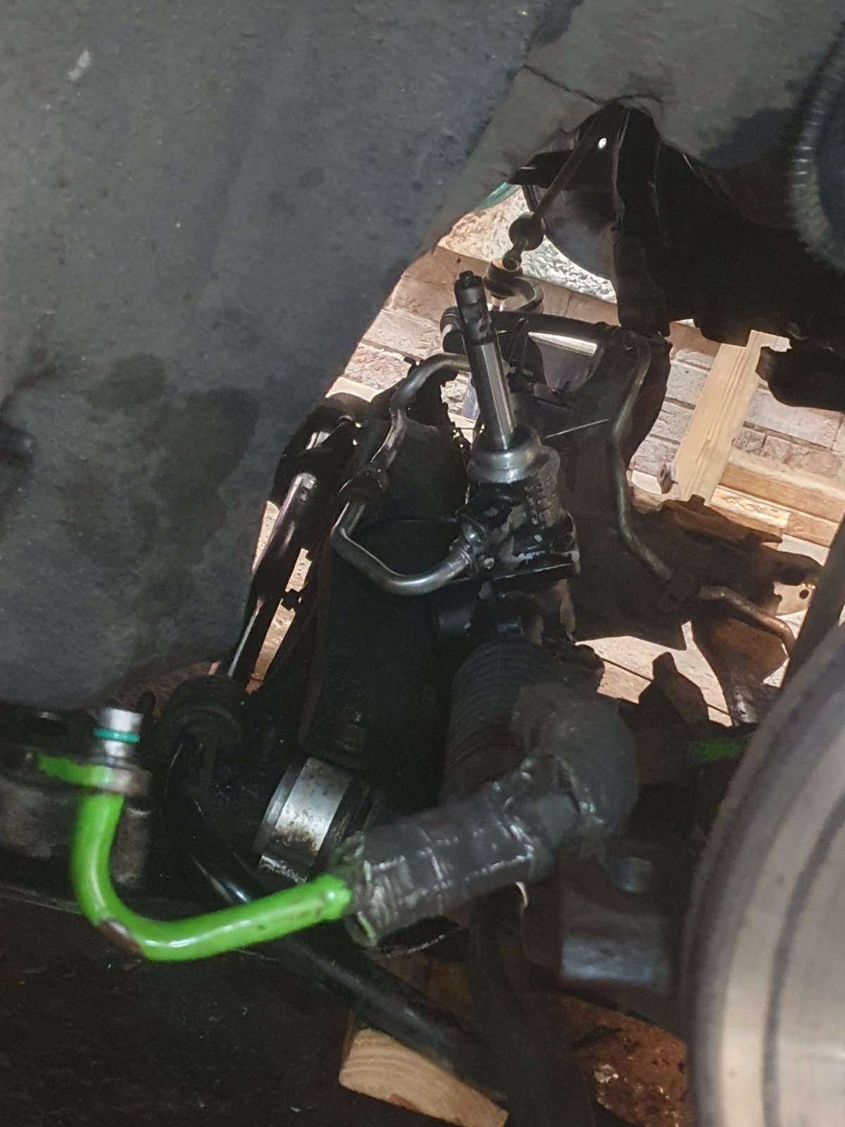

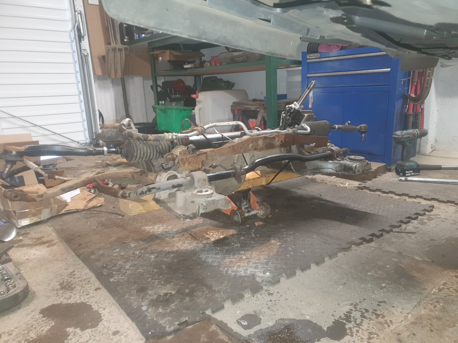

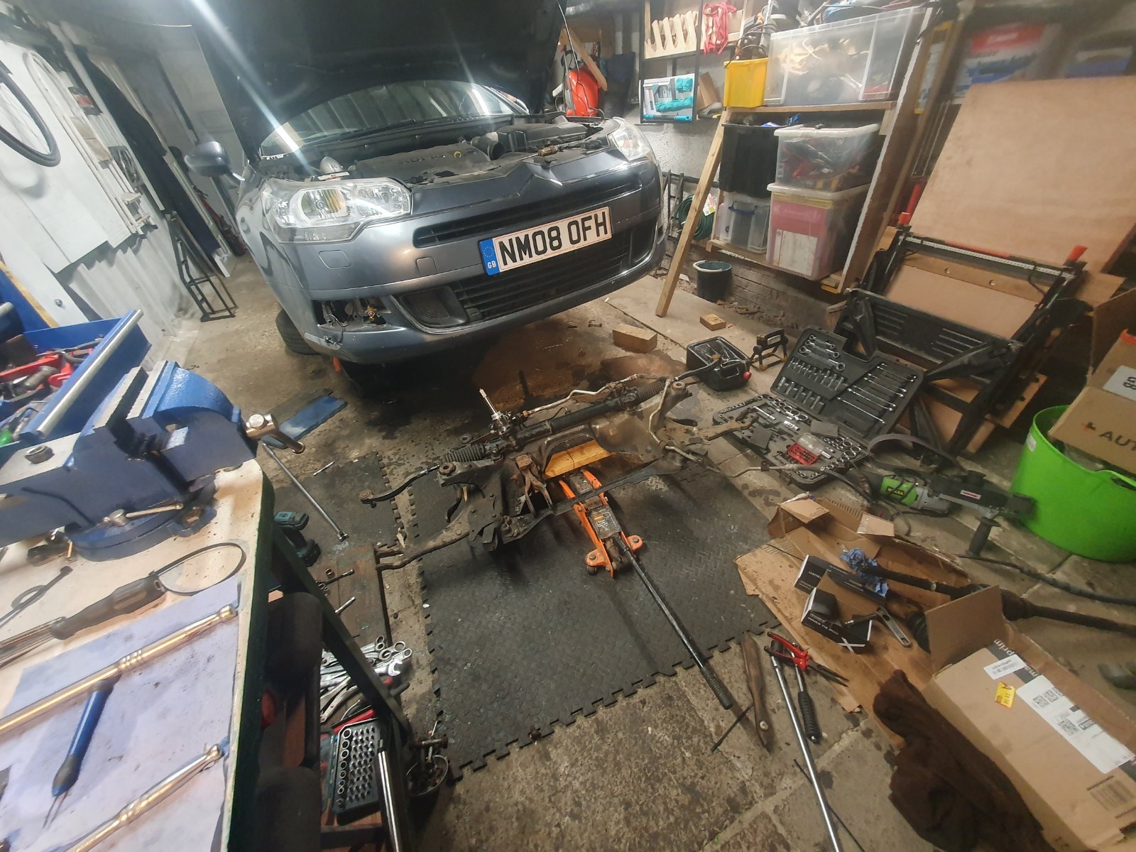

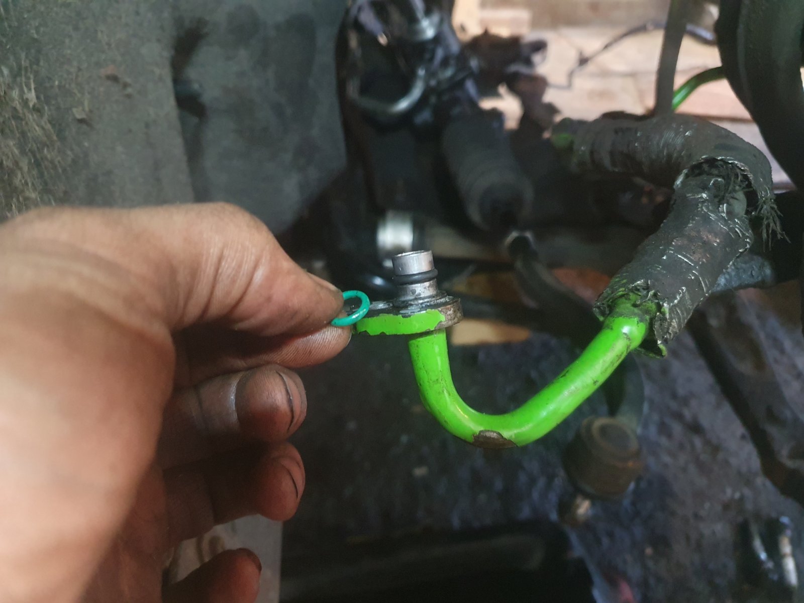

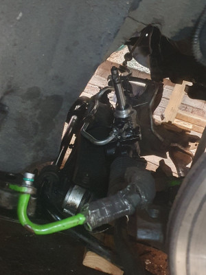

It's in place, spent some time ensuring the shaft/ pinion were in the right position! The one on Stu's rack certainly wasn't assembled right.
Added new O rings to the pressure and return pipes. Hope they don't leak..

Another detail I didn't show was the use of an outer rubber gaiter fitted over the outside casting and fitted up through the rubber bung in the footwell.
Last time I used CV joint gaiter that was a good fit. That was without cutting off that unused mounting block on the casting. This time I added a groove to help locate the rubber cover and initially intended using the steering rack boot stu supplied. I tried this but couldnt get a solution that allowed it to fit and also go through the footwell aperture and locate there securely. I then returned to the cv boot option and couldn't cut the spare cv boot I have to the right fit. So in the absence of buying a universal cut-to-size type of cv boot, I tried another material... a bit far out but there's a bit of rationale to this: I have a fair amount of roofing felt. This stuff is thin, tough and completely waterproof. I cut a circle in a piece that firs over the shaft and casting and secures with a zip tie in that groove added to the casting. The lot is then pulled up through the footwell and a hole cut to locate over each of the studs fitted in the footwell. Then the rubber bung is pushed back in and the 2 nuts tightened on the studs clamping the lot together. It serves to keep water off the shaft but it's thin enough to let the bung fit back in place.
Again, time will tell how effective it is but I think for now , it'll help prevent new corrosion on the shaft. I didn't bother painting the shaft after all.
