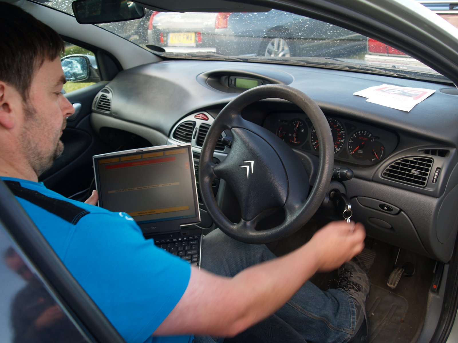

Incase anyone is interested in the first start and lexia readings..

Oh crap just realised that's me not sitting in my car.. I look very different to that now..

It was a while ago.
Wetherby, Sun, 22 May 2011 12:48:19
