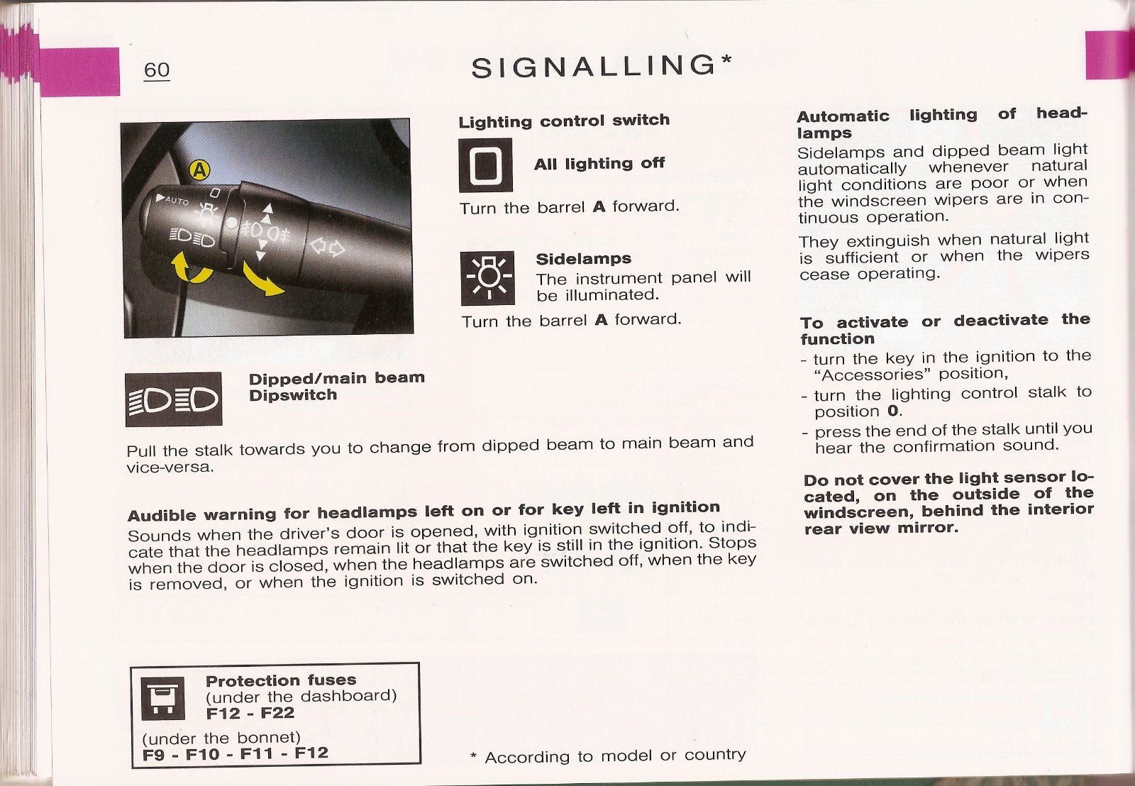

How do you switch off the auto lights. I know you press and hold the end of the stalk but that's all. They are on and I want them off..

Great news, Paul (other than the mileage bit!). I wonder if you could send off both ECUs (mark them as 'original' and 'replacement') and the instrument panel, and get them all set to the mileage in the 'original' ECU? Then you should get the better price (and the last MoT would also help to prove the mileage).

That was a while back Paul - activating my CD autochanger

Brill thanks for that Steve.. Tomorrow's job. I. Being lazy really as I have got a mk 1 c5 handbook..

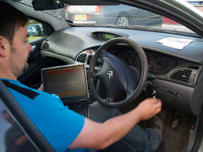

Incase anyone is interested in the first start and lexia readings..

Oh crap just realised that's me not sitting in my car.. I look very different to that now..

Re: 2004 c5 hdi 110 cooling fan woes FIXED and now running (pg 6 on) .
It was a while ago.
Wetherby, Sun, 22 May 2011 12:48:19
